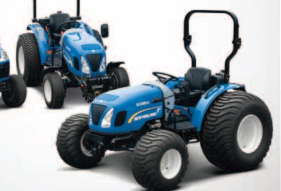

Deep sand and sinking - maybe a tire with a bigger footprint is best here. How much better is the situation with a box scraper on the 3pt?

I'm running the stock (industrial) R4s. I had the box scraper attached in this latest fiasco. (btw, I finally got out of the sand trap by riding down a hill I would have preferred not to...although there's no problem going downhill!) I'll return later tonight without the box, try to stay in more packed sand, and will let you know how it goes. The problem is, you go over packed sand with a tractor a few times and, voila, no more "packed sand." I'm thinking I may need to remove the loose sand down to packed sand, then have some form of aggregate brought in and installed....
