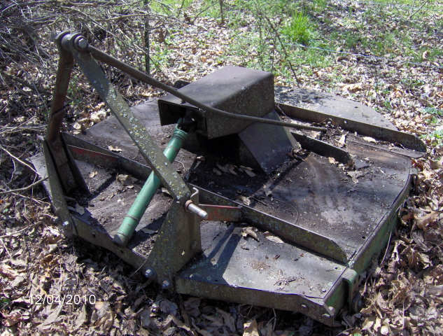

Just put my OLD JD 5' Gyro mower on the JD 790 (27 HP) today, plenty for weight! I was mowing field edges, mostly brome grass & weeds that hadn't been cut yet this year. No power problems, although it did work it some when I got into some heavy Reed's Canary grass. This is a one day/ year job, so no reason to buy a newer mower when the old Jd was already there! ~~ grnspot110
