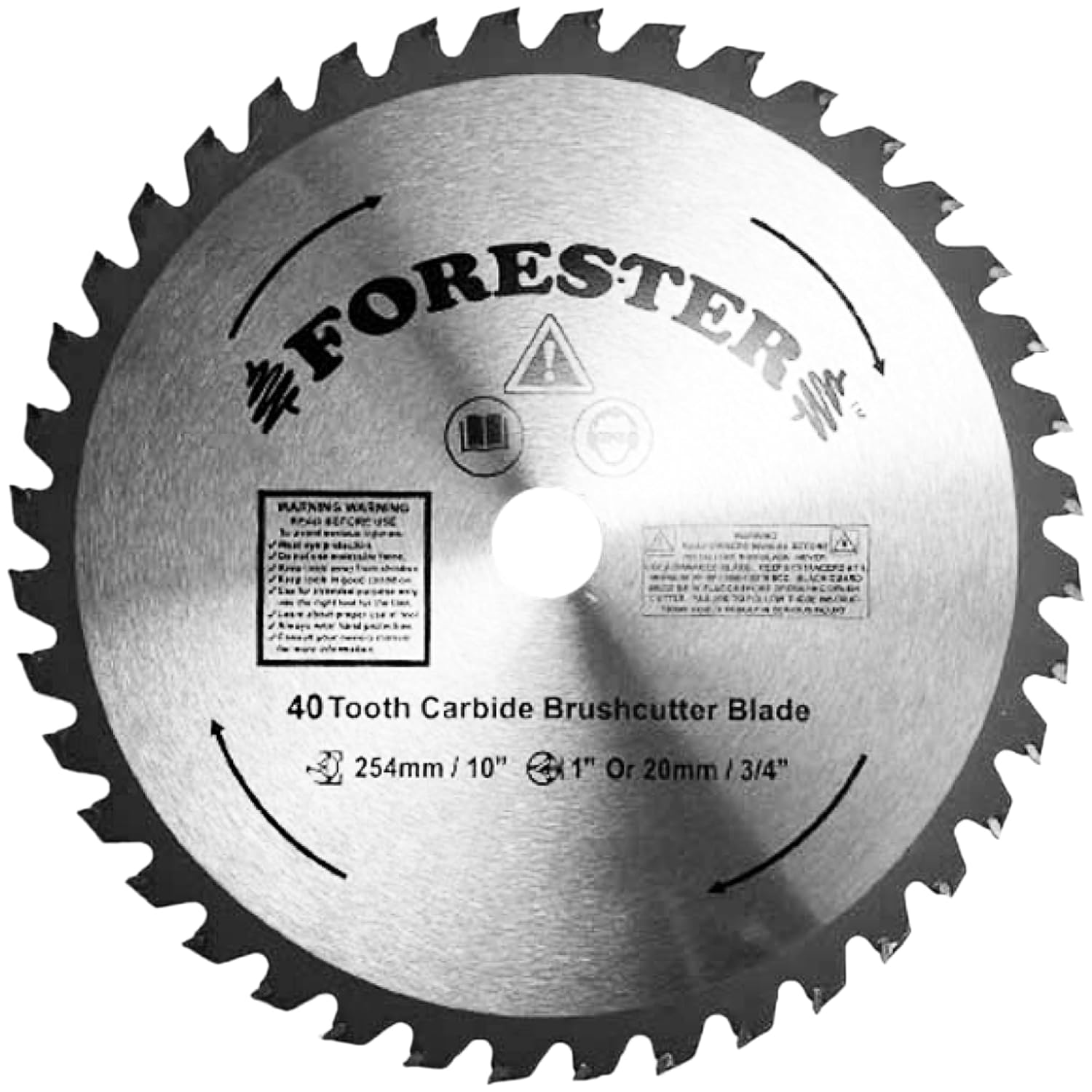

I've tried Stihl products, chain faced, but this is the toughest...doesn't throw teeth.
The only trouble is if you are using it in rocky areas, you will eventually chip the carbide teeth, and carbide is not easily sharpenable.

The only problem I found with the regular tooth blades was that I spent a lot of time sharpening them.
I use the renegade red Carbide and found they last a while and cut through the heavy stuff, even bouncing off rocks here/there when I cut a new area only dulls a blade a bit and can use them until the carbide tips are almost worn off.
They work for grass and woody stems. the regular blades would always choke in the tall stiltgrass.

I've never tried the carbide blades in grassy/stringy vegetation. I generally use the 3-armed blade for that. Do do agree that the standard saw blade types (including the Maxi) are far from optimal when cutting grassy types of vegetation. You can make them work, but if you have much to do, it pays to just switch blades.
