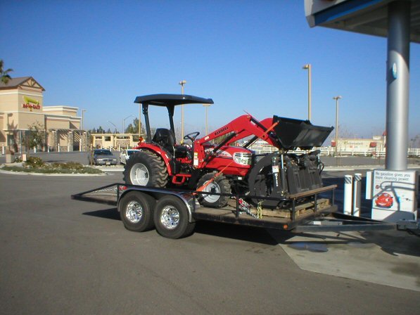

My dealer is 650 miles away from me, I towed my rig home with no problems what so ever. If I was to have problems, then I would be in real trouble, it is not unheard of for the wind to blow at 80+ MPH at my place.:eek:
Nice tractor. Nice rig. Can't make out the truck model.
Especially nice: the In n Out Burger place in the strip mall behind you there. Right now I'm jonesing for a #2 with extra onions. Unfortunately, the nearest InOB is 40 miles away in Chico. Oh, well. Maybe next week sometime.
Flusher, the truck is 1988 F250, getting ready to turn 300K miles. I special ordered this truck back in 87. It has been a very good truck for me.
My gosh that grapple is HUGE for the size of the tractor.....but it looks like it would fit nicely on my backhoe. ;):D
Builder, The grapple was not for me, I'm not sure if my little tractor would even pick that thing up,:eek: I was delivering it for the dealer, saving him about a 1000 mile round trip. ;)
