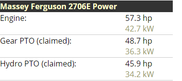

Why would there be any difference in the power output of the PTO? Isn't the PTO direct drive in both transmission types?
I am not sure the answer at 100%, so I am not going to answer it ... but it is the case
