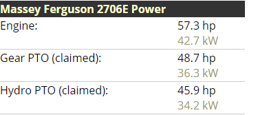

Why would there be any difference in the power output of the PTO? Isn't the PTO direct drive in both transmission types?
Because the engine has to drive a bigger pump and because the second you push the whiner pedal, it takes even more hp from the engine. That among other things = less going to the PTO.
How much less? It all depends on a lot of different things like how fast you are going ect..
