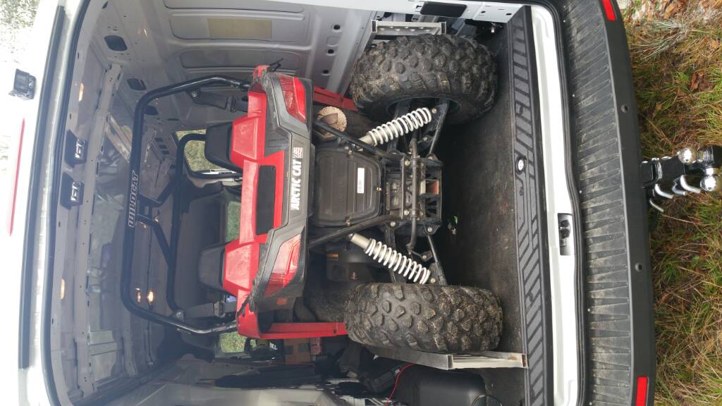

I just drive it up inside my van and shut the doors and don't worry about it.

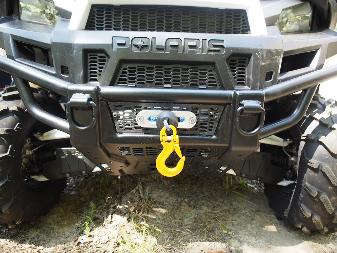

I also have a 6' x 10' utility trailer with 4' ramp. Knowing the trailer would be too small but needing to weld a bunch of 1/2" D-rings on the trailer and UTV, I took them together to a friend's farm last weekend where my welding equipment is. Trailer tracked and worked great, but was too short. No pics but the front tires were all the way forward and UTV front tied straight down with the rears tied down to the UTV trailer safety chain tie points. As expected the rear tie points held fast as they were at a good angle on a non suspended point. But I had nothing but trouble with the front tie points. I welded the D-rings for recovery and tie down purposes. _EM51334.JPG

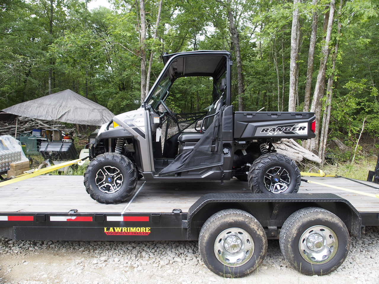

I just ordered a 77" x 16' Lawrimore utility trailer with 3500# tandem axles, brakes on both, 12" steel mesh sides, LED lights and mounted spare tire. UTILITY Scroll down to "Tandem Axle Tubing Trailers". 6 - 8 week wait for mine. My 20' equipment trailer is a Lawrimore and I like it a lot. I felt I needed a minimum of 12' trailer bed length with 14' being better. So got the 16' to make sure I had flexibility in use. With a crew UTV I would not consider anything less than 16'

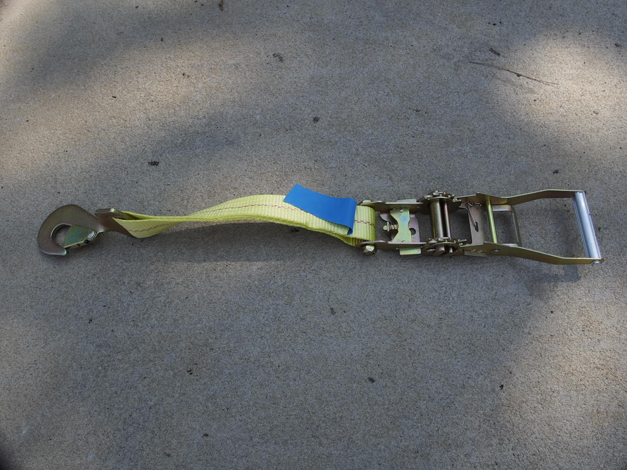

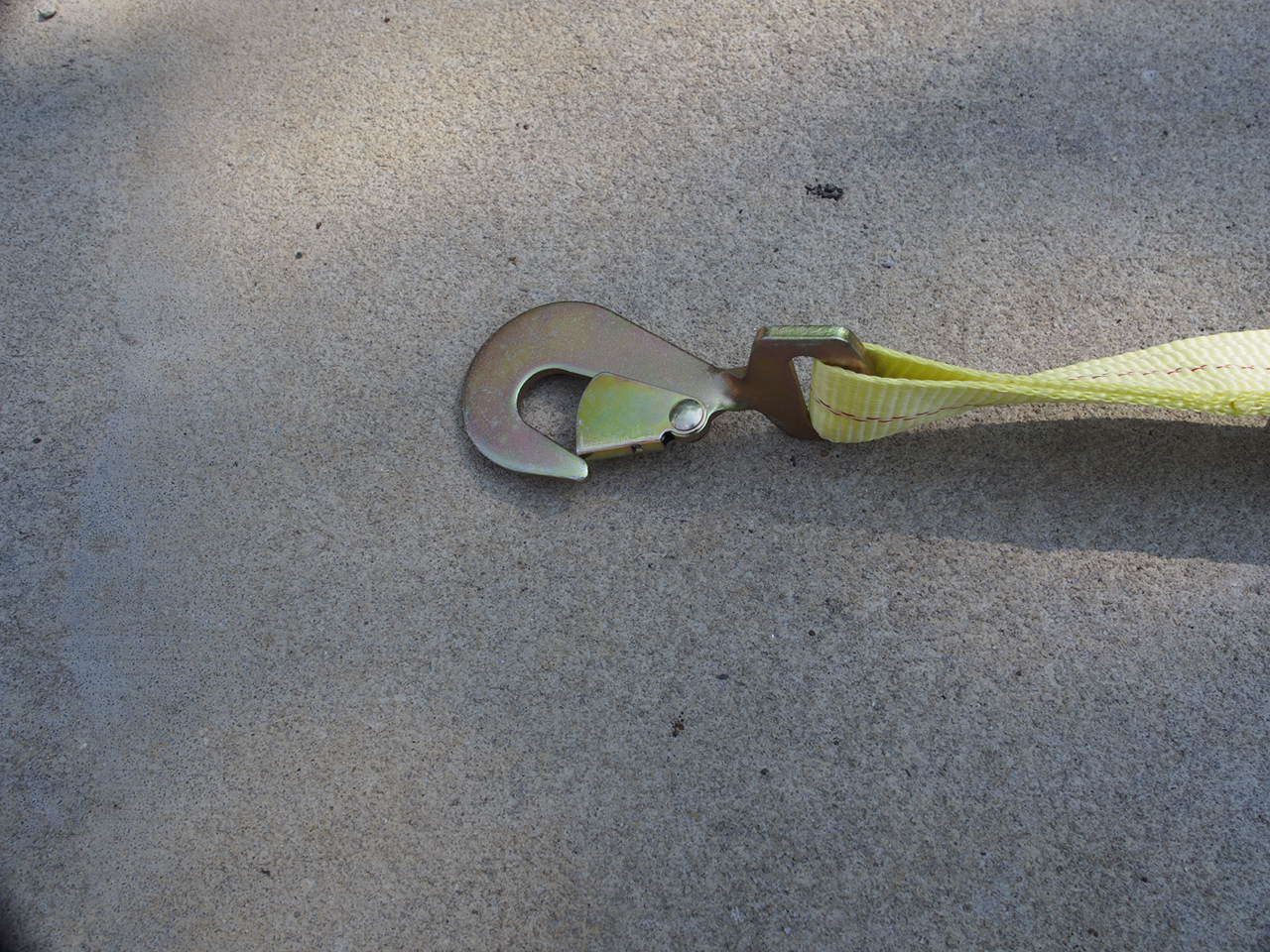

Only issue now is to find a way to tie down the front of the UTV on a non suspended frame portion. If you are going to tie it down at a suspended point, such as the front bumper, I suggest you use straps that have a clasp so as the UTV bounces around the hook does not come lose. This type is strap is all I use now. Have 5 each on each trailer plus a set of 4 with a built in axle strap for cars, UTVs, etc. _EM51337.JPG_EM51336.JPG

See I need 11.5 feet just to get the back tires on the deck. The back axle on the 16' is at 12'. So it's all I can do to get my weight over my trailer axles.
Ok. I'm talking myself back into the 18'er. 14 is out. Next question. Would you go 77 or 83 inches wide? Thinking 77. Have 60" mower.
