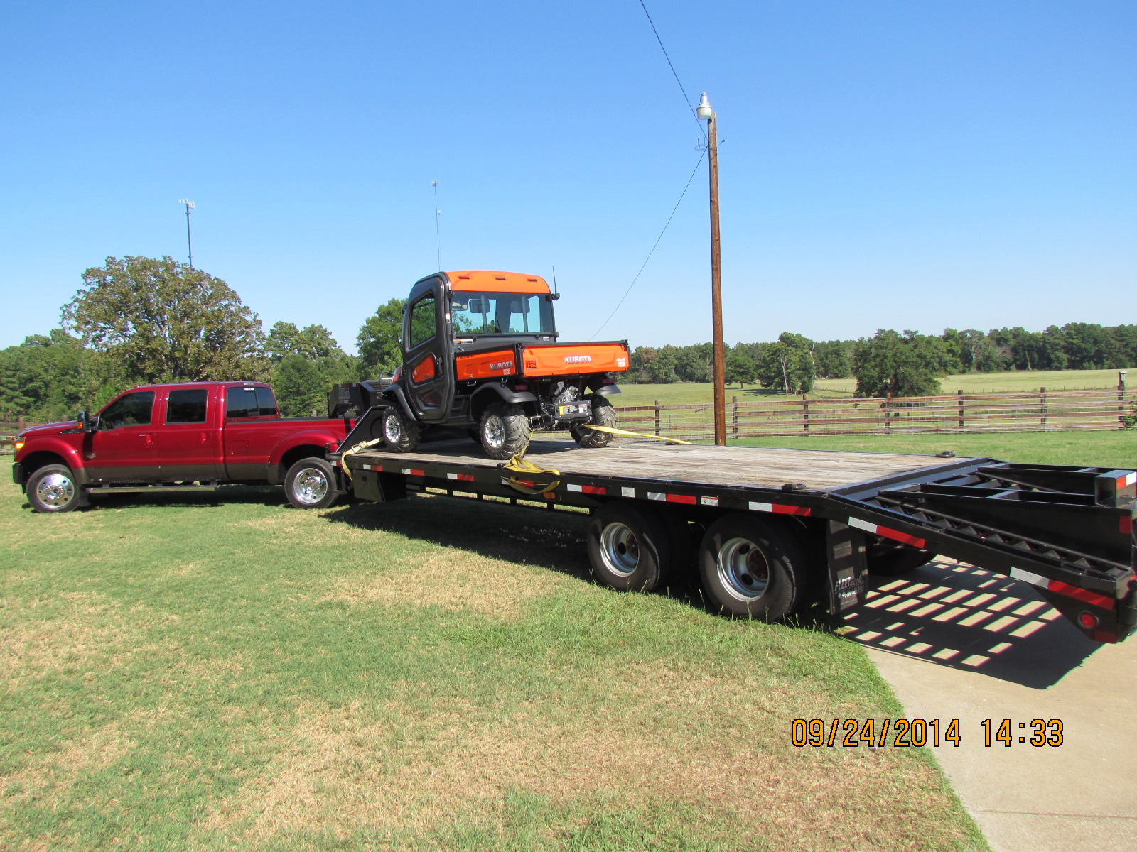

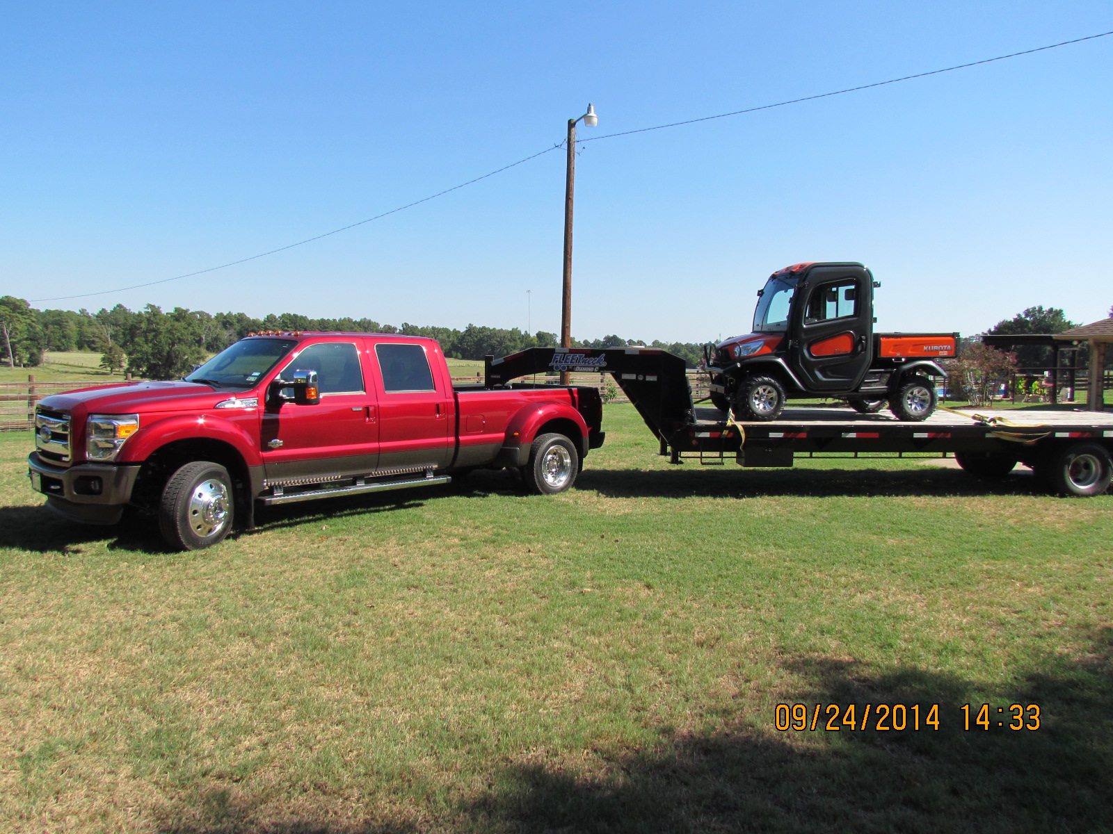

This is the trailer I use, 28' Fleetneck. Overkill but it's what I have.

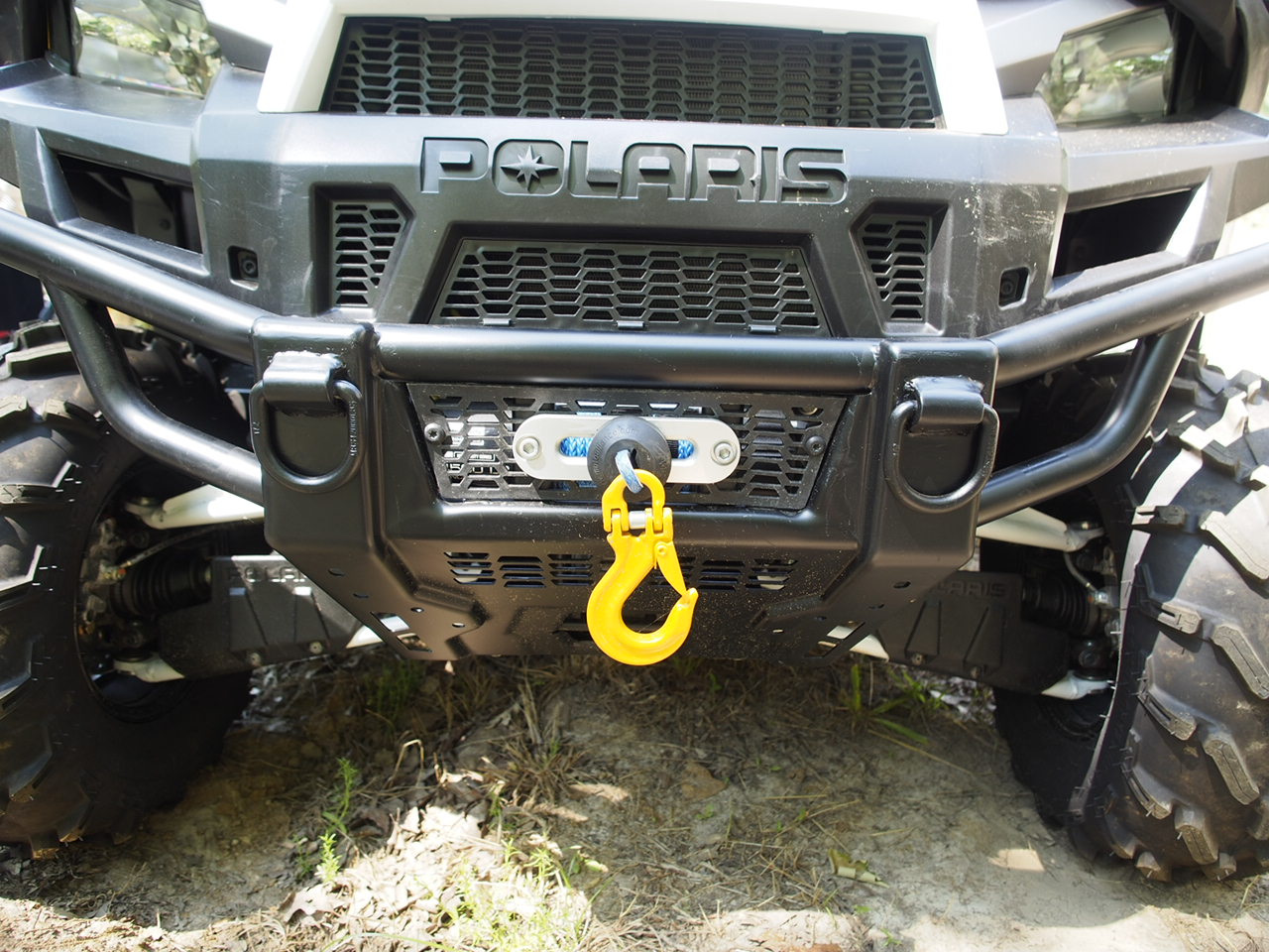

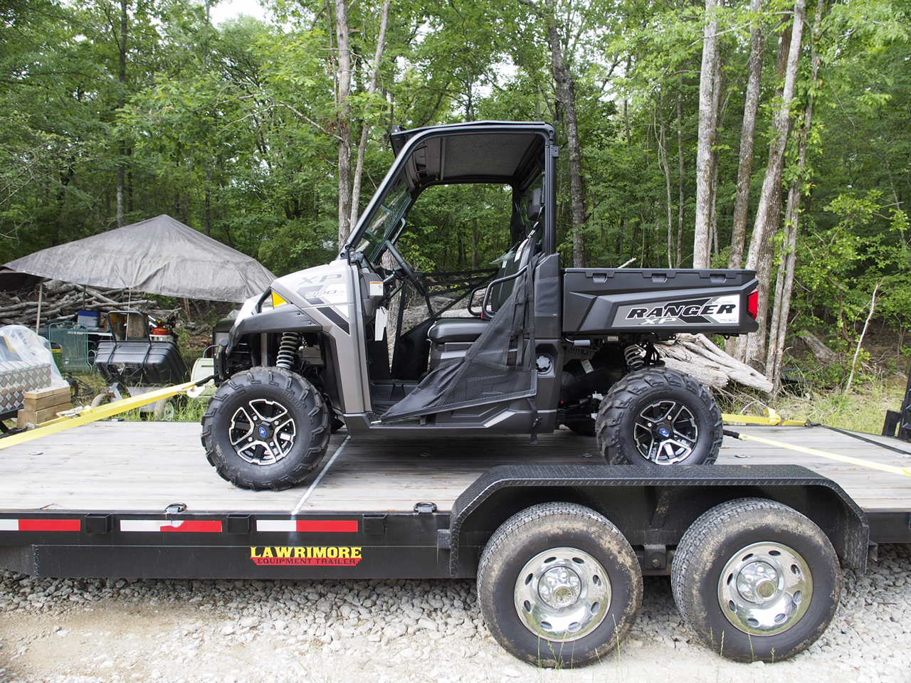

I have a new Ranger XP 900 EPS and this is how I brought it home: _EM51210.JPG
I also have a 6' x 10' utility trailer with 4' ramp. Knowing the trailer would be too small but needing to weld a bunch of 1/2" D-rings on the trailer and UTV, I took them together to a friend's farm last weekend where my welding equipment is. Trailer tracked and worked great, but was too short. No pics but the front tires were all the way forward and UTV front tied straight down with the rears tied down to the UTV trailer safety chain tie points. As expected the rear tie points held fast as they were at a good angle on a non suspended point. But I had nothing but trouble with the front tie points. I welded the D-rings for recovery and tie down purposes. _EM51334.JPG

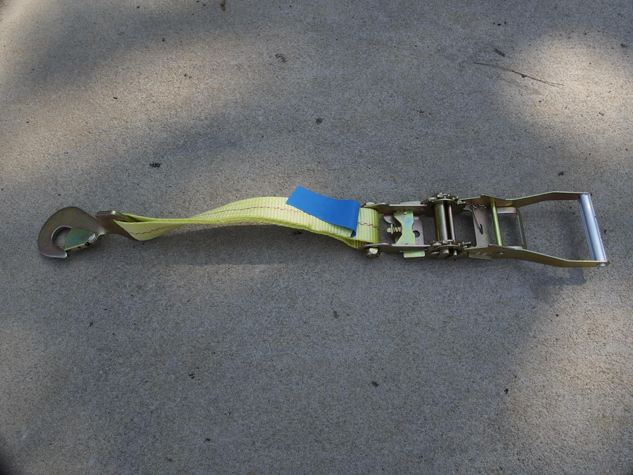

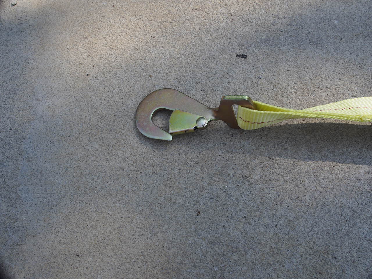

Only issue now is to find a way to tie down the front of the UTV on a non suspended frame portion. If you are going to tie it down at a suspended point, such as the front bumper, I suggest you use straps that have a clasp so as the UTV bounces around the hook does not come lose. This type is strap is all I use now. Have 5 each on each trailer plus a set of 4 with a built in axle strap for cars, UTVs, etc. _EM51337.JPG_EM51336.JPG

I also have a 6' x 10' utility trailer with 4' ramp. Knowing the trailer would be too small but needing to weld a bunch of 1/2" D-rings on the trailer and UTV, I took them together to a friend's farm last weekend where my welding equipment is. Trailer tracked and worked great, but was too short. No pics but the front tires were all the way forward and UTV front tied straight down with the rears tied down to the UTV trailer safety chain tie points. As expected the rear tie points held fast as they were at a good angle on a non suspended point. But I had nothing but trouble with the front tie points. I welded the D-rings for recovery and tie down purposes. View attachment 472607

Polaris' metal trim is is a black satin finish. My standard go-to spray can paint is Krylon and this is what I got from Wal-Mart: _EM51338.JPG

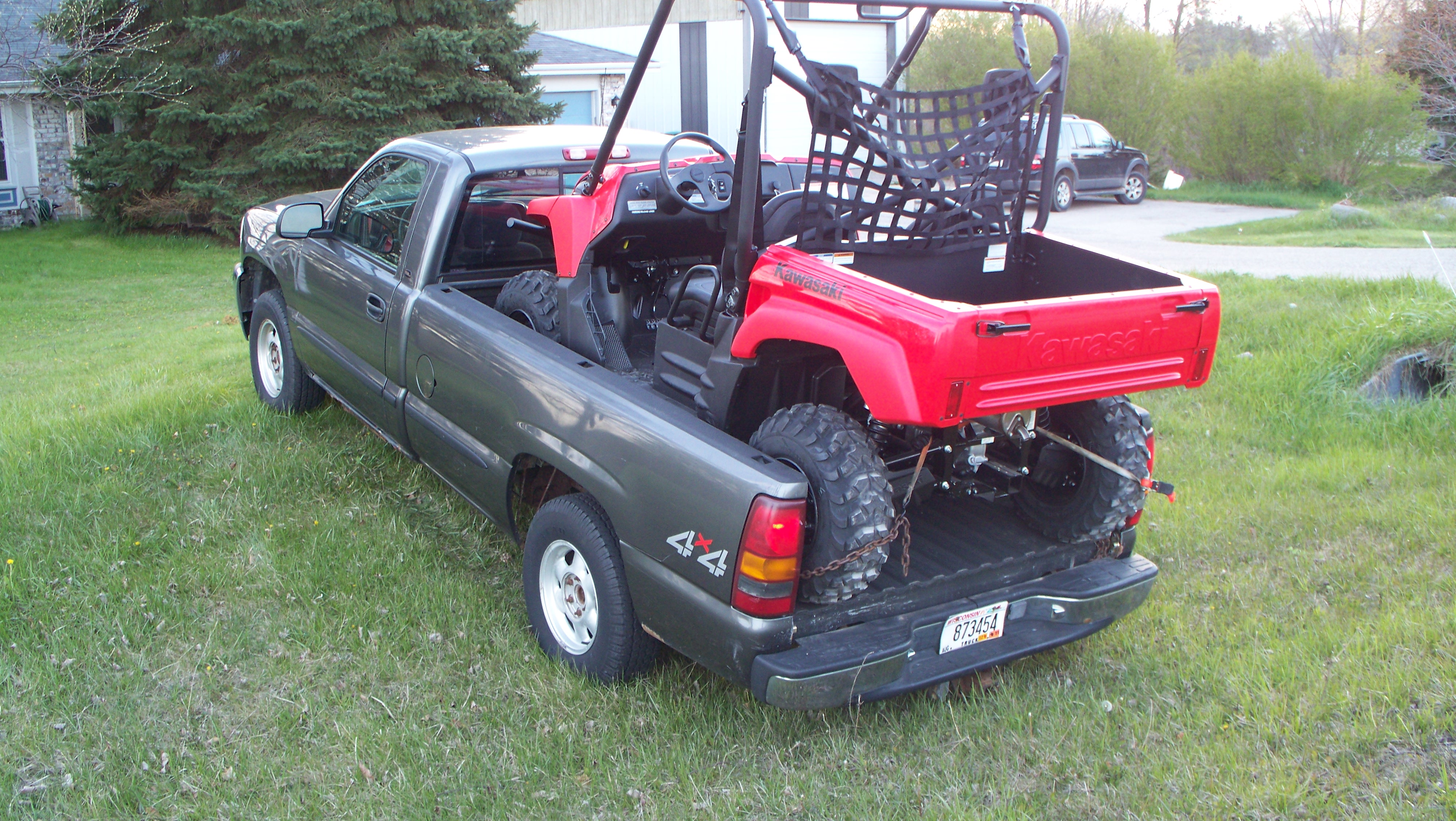

It might be tied in the front. Also look at the sides, it has straps going to roll bar.
It looks goofy. I might put down plywood or boards. But that may be what he is doing with the ramps. They appear under the tires. Not sure how he did that.
On side by side forums they take about, the weigth is not on the tailgate, or wood on tailgates spreads it.
I just backed into a ditch and it climbed right up. Added air to the tires. Drove great, maybe better.
