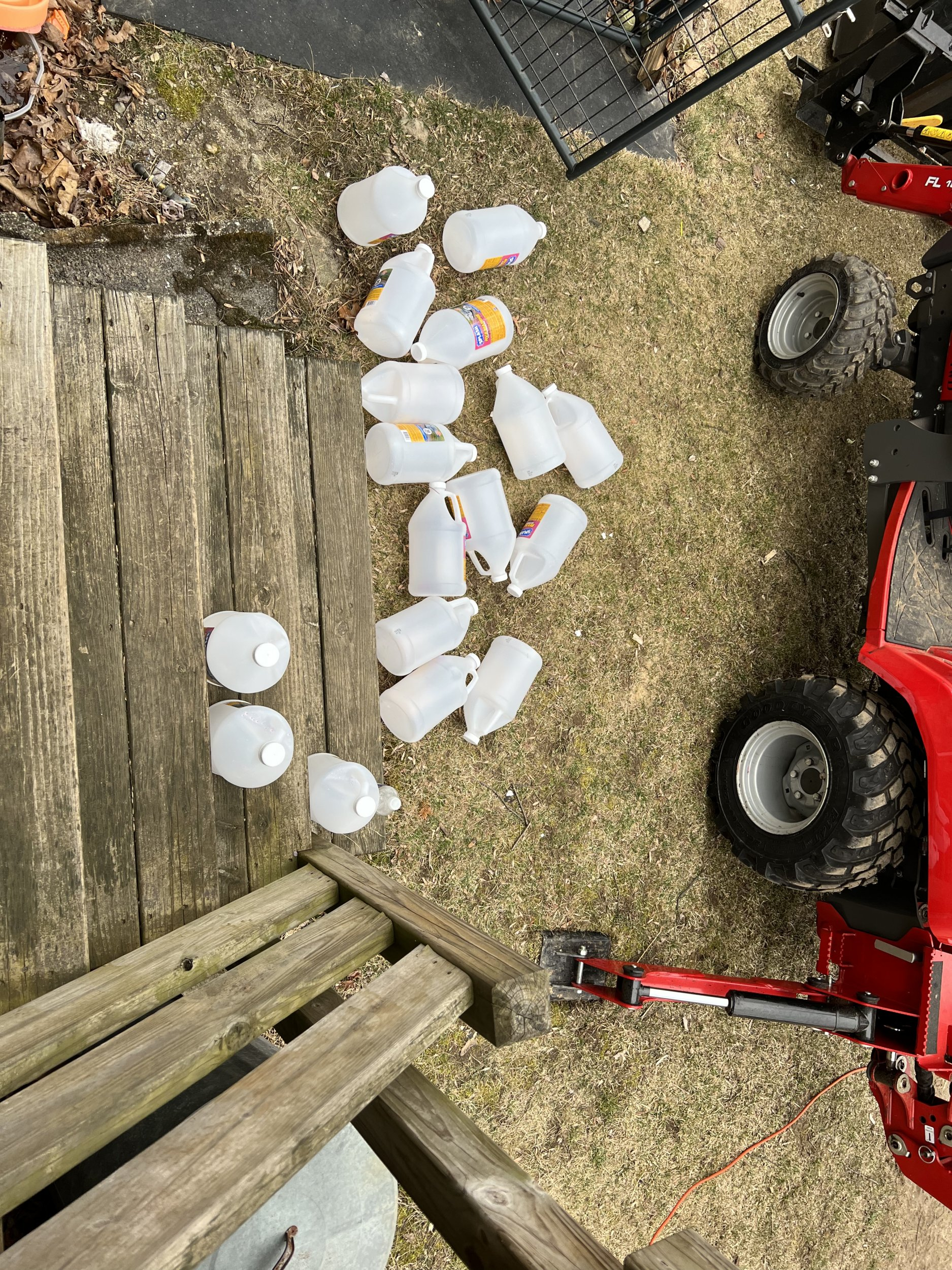

I forgot to update this. I had a local tire shop do the mounting after I got all the juice out. I did Rv antifreeze. It says it’s animal safe. I got it 3 bucks a gallon I think it was. I ended up getting 9 gallons per tire. It went really easy. I used a adapter for the valve stem to a garden hose. That went to my utility pump. I was worried it might be too strong but it was fine. Absolutely no regrets losing the messy beet juice.
