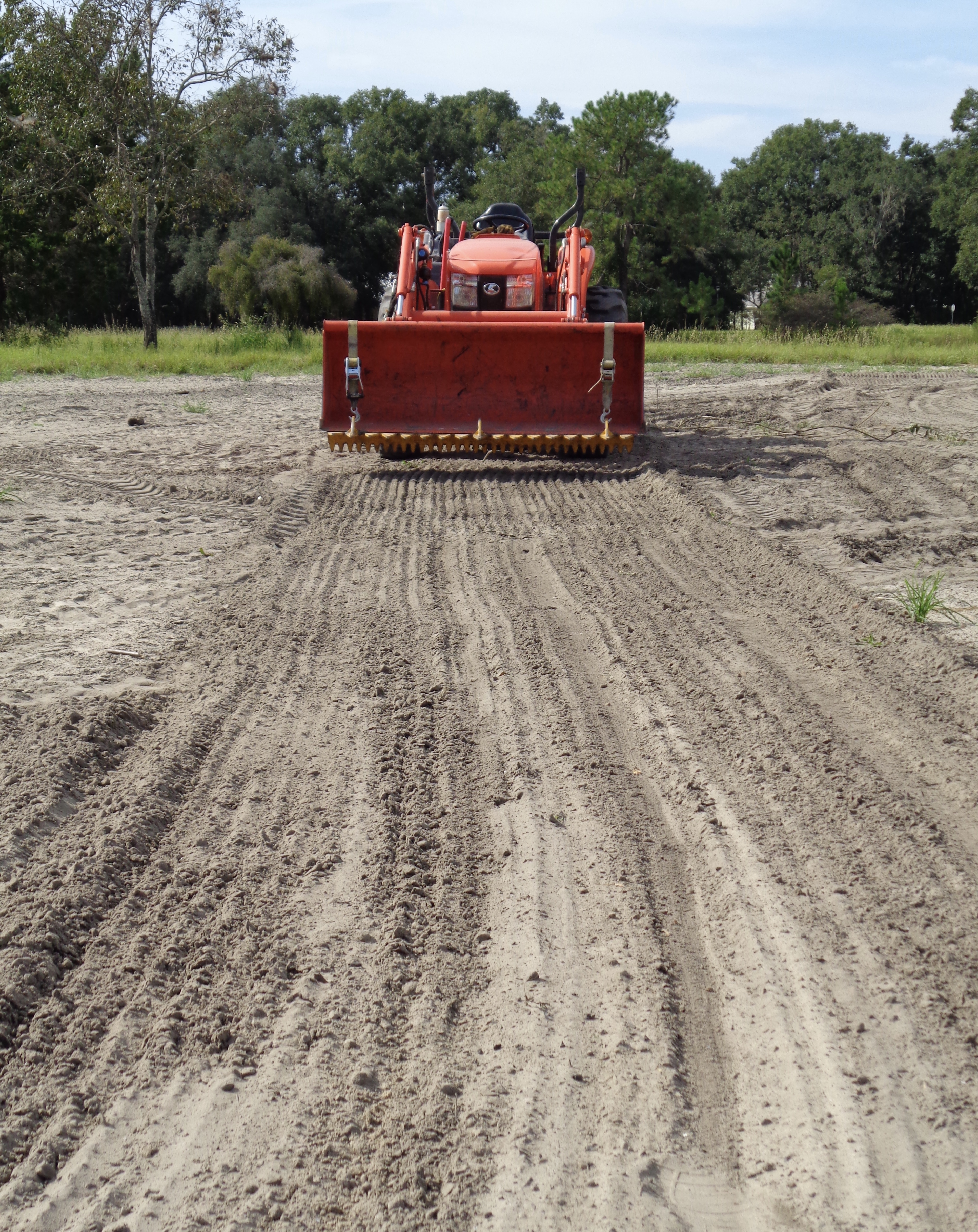

Consider a Ratchet Rake bucket attachment. You cannot DIG with a Ratchet Rake on the bucket but for tearing out roots and minor grading a Ratchet Rake will perform much better than a Toothbar.
MORE: https://www.tractorbynet.com/forums/attachments/375397-ratchet-rake-today.html?highlight=
