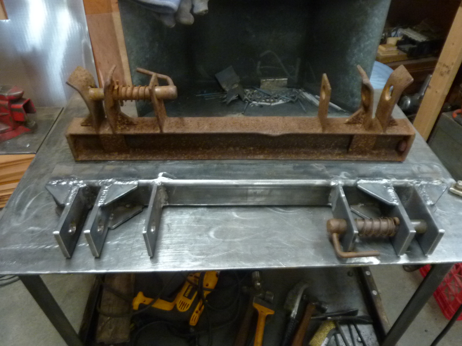

Question on when you are working with square tubing and most of the welds are on one surface. In trying to keep things straight/flat and limit the amount of deformation in general can you help yourself by putting the tubing surface with the seam in any particular orientation relative to the welds or should you just not worry about where the seam is ??? Say a piece like this - Thank you

No, it doesn't matter as to the seam's orientation. You can marginalize the warping by clamping both ends of the tubing down to the welding table while making your welds and keeping it clamped until the metal assembly has completely cooled down.
If any warping does occur, you can reduce it or even eliminate it by heating the back side of the arch with a torch and cooling that side down with a very wet rag in the area of the highest arch point. Sometimes it takes repeated efforts.

I've never worried about the seam.
Me either. I have turned the seam toward the inside to hide from view just in case after paint it doesn't show. Never worried about it from a warping standpoint but I'm no expert.

OK thanks. I was just wondering if it possibly made a difference.

I don't worry about seams either, unless there's some aesthetic thing (looks) - generally I follow everything Oldoak mentioned.

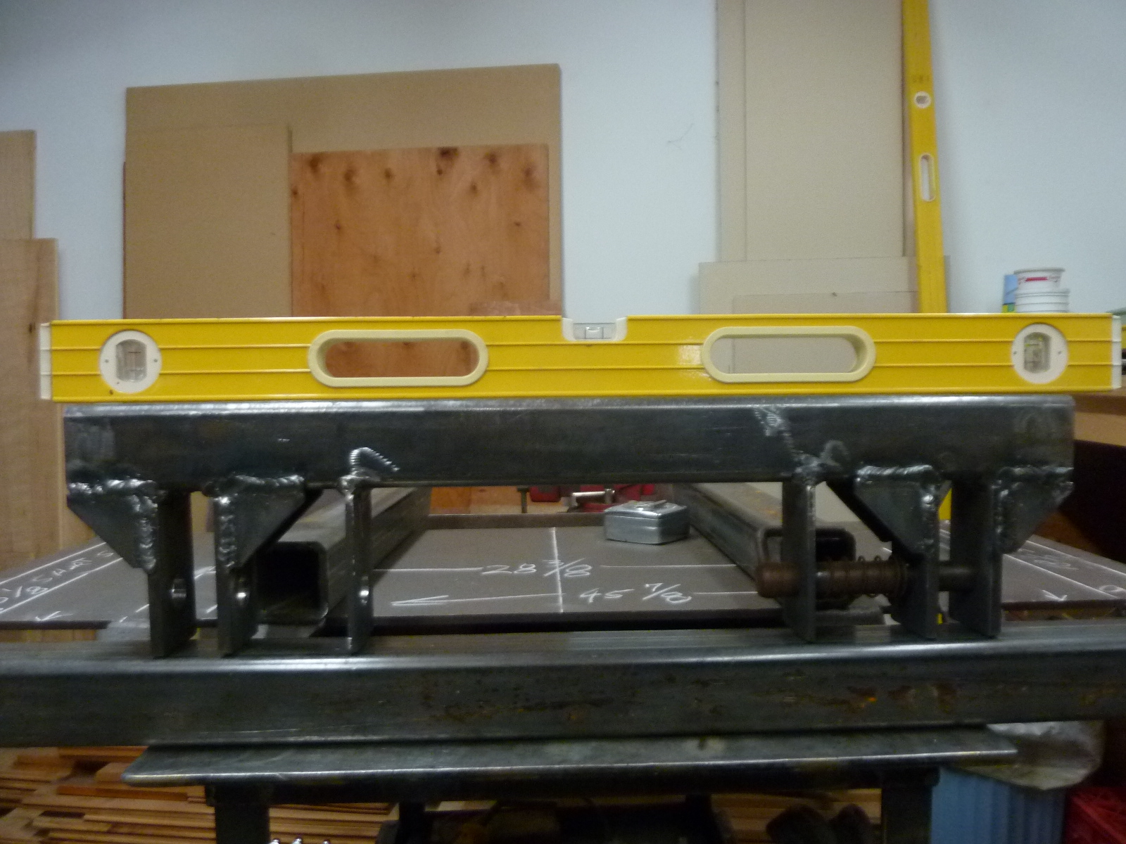

I've built some hitch stuff similar to your project, what I do is precut every piece, then HARD clamp the tubing down to the 1" thick weld table at both ends and the middle, then I use a piece of 3/4" allthread and several nuts to string all the drilled pieces on - adjust the nuts for desired spacing and snug them up while the individual pieces are resting on a flat surface.
Then I check spacing at the holes, and at the welds, get everything lined up, then light tacks (2 per piece, 3 per gusset), then clamp the allthread nuts down HARD (by now everything's sitting where it SHOULD be)
Most of my clamps are rated 1200 pounds, and I'm pretty sure I'm there (unless the tube's too thin-walled to take it) -
Then I "hop-scotch" around til everything's full welded, and find something else to do til my IR gun says it's all at room temp. After I take off all the allthread stuff and unclamp from the table I run a straight edge across everything (and an aluminum rafter square), looking for daylight.
If THAT test passes, great; otherwise, Oldoak covered that too...
(Some say I'm too OCD; others are SURE I am) :laughing: ...Steve

Thanks for all the tips. I did manage to keep it pretty flat and lined up.
