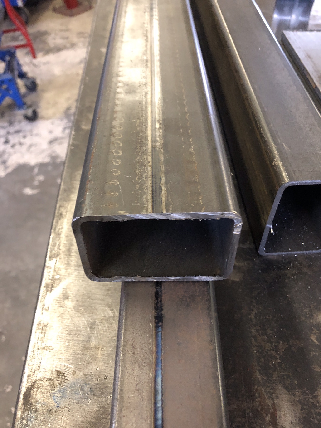

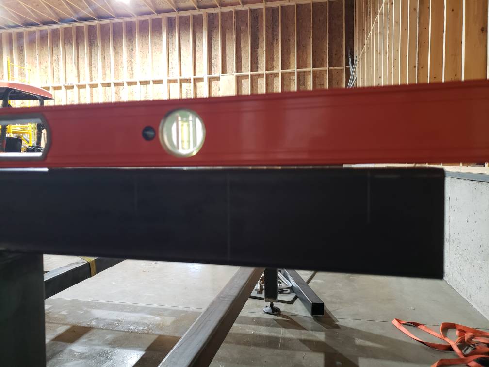

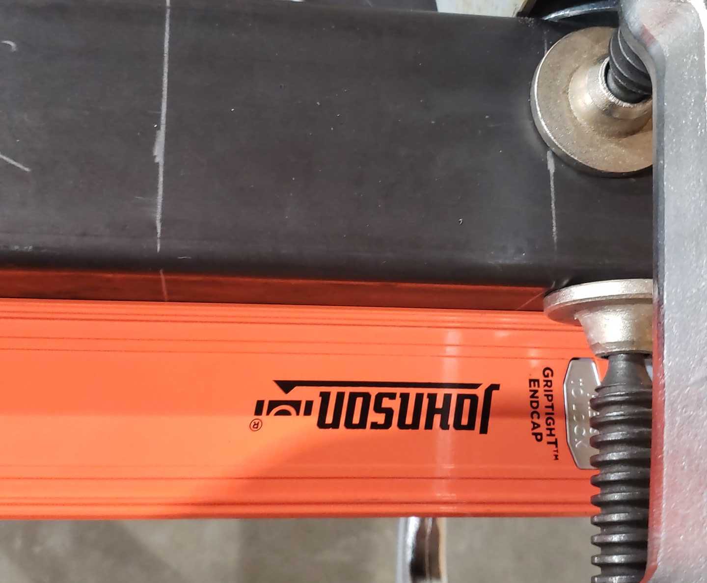

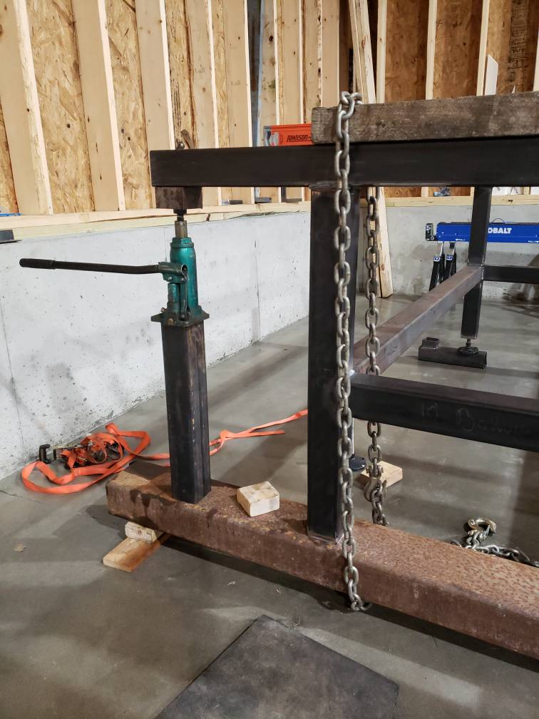

And there always good old persuasion. I had to straighten this 3x3 .120 wall tubing. It had pulled almost 1/8" and needed to be 1/32nd or less, a little creativity and it was back to spot on.
I asked a very talented fabricator friend, that I've seen use the heat and cool method to straighten large stainless pipe, about the best way to straighten this and he suggested trying to bend it back cold first. 20181223_160357.jpeg20181224_152926.jpeg20181223_153959.jpeg
