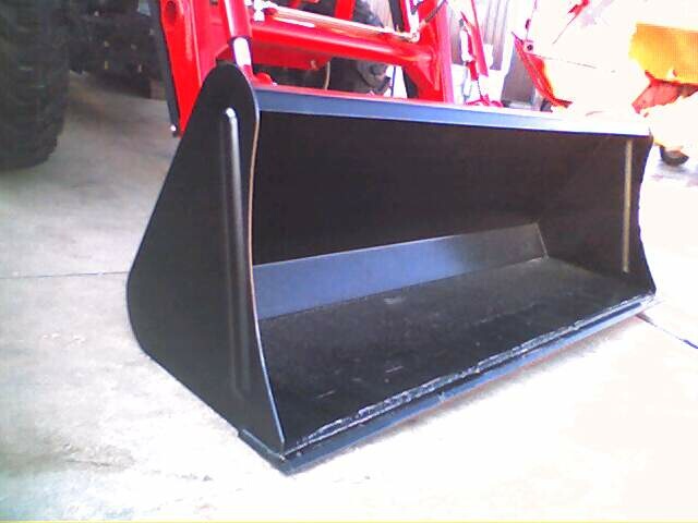

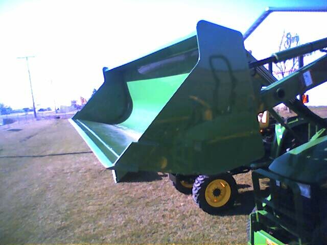

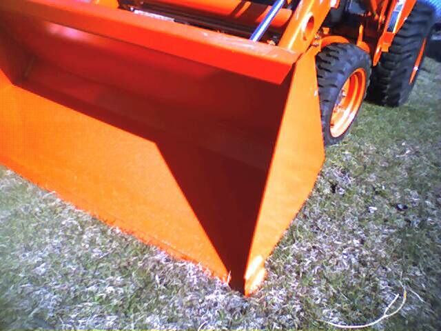

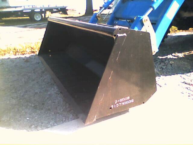

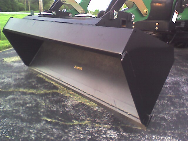

What surprises me is how lightly built some of the buckets really are. Below are some photos of buckets that you might want to review, any of the rolled or folded lip buckets are inadequate (IMHO) if you want to add hooks. In order are a bucket from a 35hp Branson, it is not only small but also just has a folded lip, also notice it has no welded reinforement on the lower corners or the sides of the bucket. Next is a JD light material bucket on a JD 3410, it has a simple rolled top lip, it has corner reinforcment but not side reinforcement. The third photo is a New Holland TC35 bucket, notice the tube steel, welded full length under the top lip, it also has full side reinforcement welded on. The 4th picture is a Montana bucket, on a 50hp tractor, like the Branson bucket it is a low capacity bucket (considering the much larger size of the 50hp tractor) and has a simple fold along the top lip, the Montana bucket does have welded side reinforcement similar to the New Holland bucket. The final photo is a Kubota B3030 bucket, this is a small & ultra-light 30hp tractor, suprisingly the bucket has a double fold along the top of the bucket and welded reinforcements on the lower corners. It does not have reinforced sides.
Good side-by-side comparison photos, Bob. I, too, am surprised by
how wimpy some of the standard buckets are. At least the Kubota

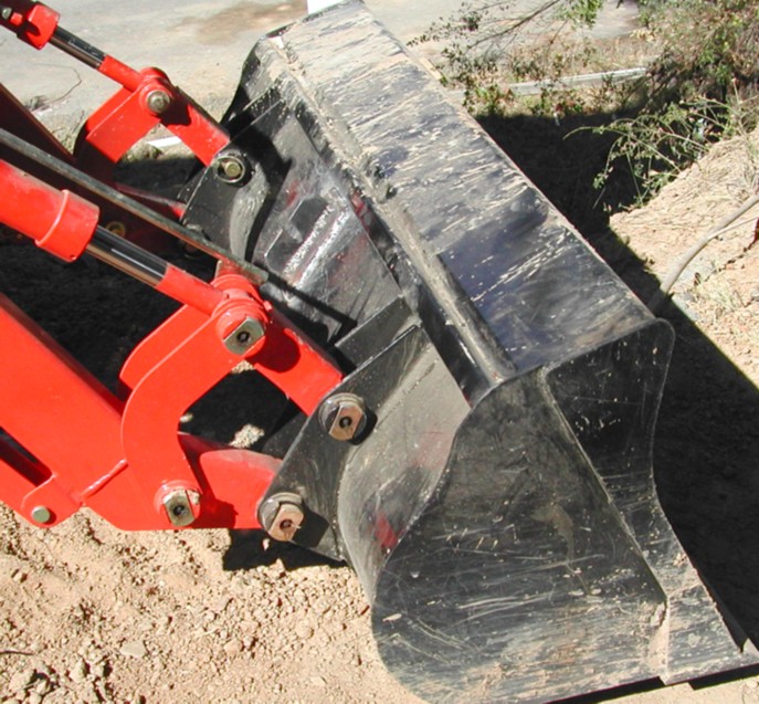

side reinforcement. I posted this photo of the CK20 bkt in another
recent bkt hook thread.

...The final photo is a Kubota B3030 bucket, this is a small & ultra-light 30hp tractor, suprisingly the bucket has a double fold along the top of the bucket and welded reinforcements on the lower corners. It does not have reinforced sides.

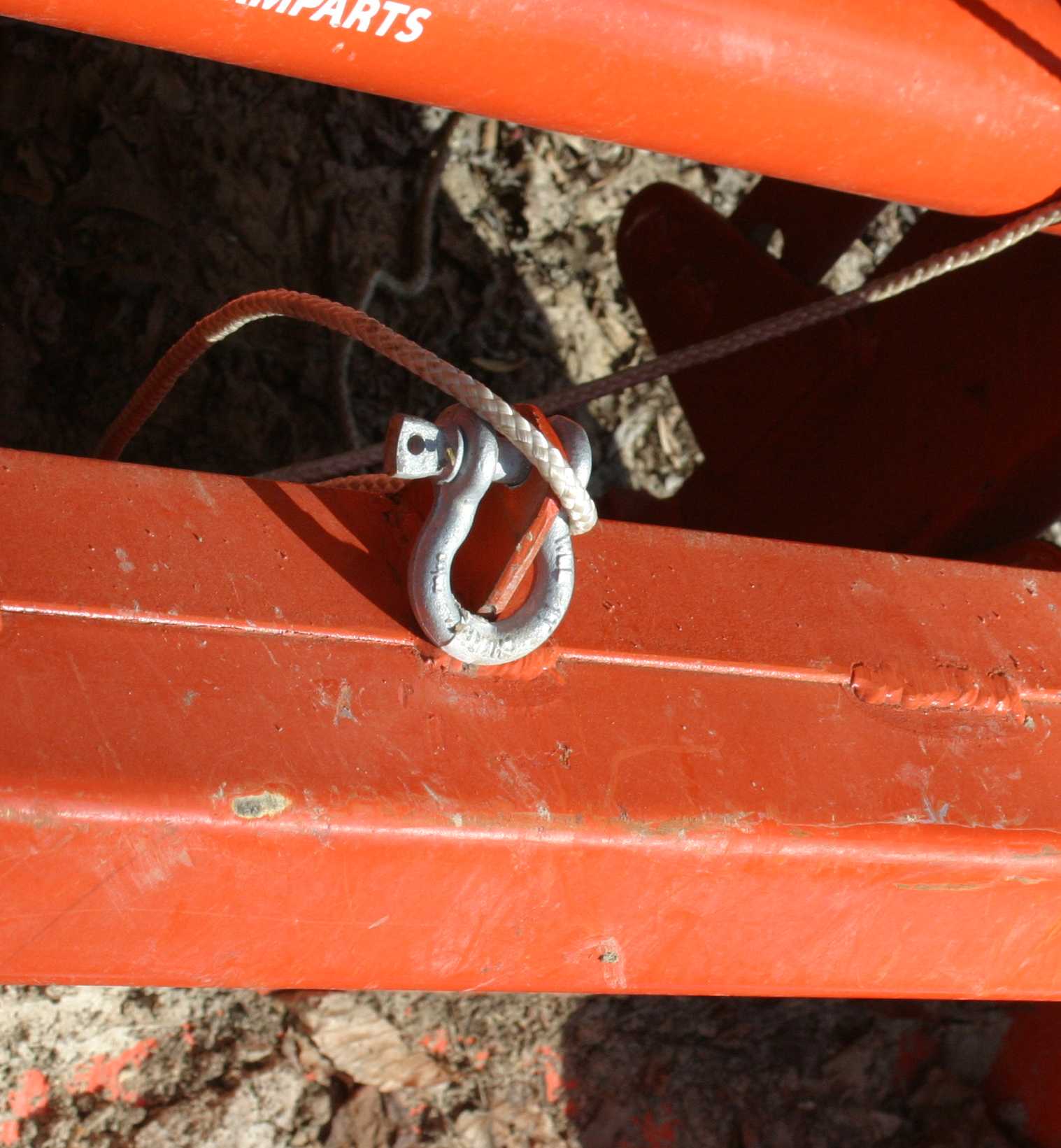

I know I was amazed at how "flexible" that top upper lip was on my own B3030. I clamped a 12 inch ( or 14"..??) Cresant wrench on it and could work it back and forth..and though..NOPE!! Aint welding hooks on this thing!! Took a piece of 2 x 3 angle..1/4" thick all the way across it and boxed that top lip in..and welded the hooks to the 1/4" angle instead.
I had a lug/bracket welded to the center..so I can attach anything using a pic. Clevis type slip hook...straight pin type clevis...etc

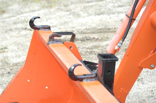

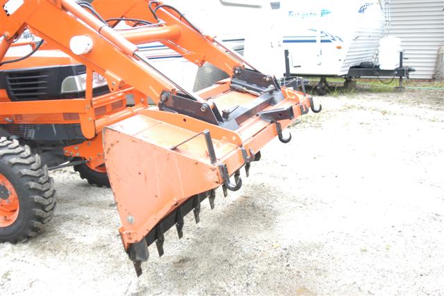

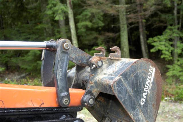

Here's my setup. Used it this week to move and drag logs. The combination of slip and grab hooks works very well for many jobs.
