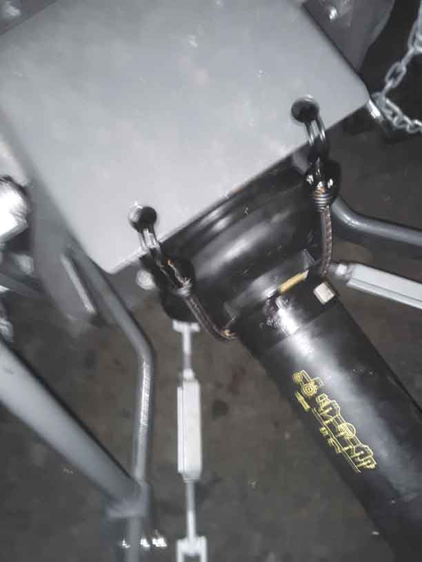

Anyway, my difficulty was with being bent in half and couched down and holding up the weight of the shaft in that position. I would never have thought of using a bungee to hold the weight without reading it and I would have never thought this simple thing would make it so much easier to accomplish until I experienced it myself. Sometimes we can overlook the simple things. I just wanted to give a shout out to anyone that might have suggested it in the past so that I could read it and try it. I don't remember who they were but they will know if they read my OP that their simple suggestion helped remove a little hassle from someone's life.

I always hook up the "tractor end" of the PTO first. I have all my strength and a better frame of mind. This coming spring I will DEFINITELY be trying the bungee method. I don't even want to think about being bent in half - holding up the weight of the PTO shaft - trying to get the shaft/stub in alignment. Then PUSH .........
