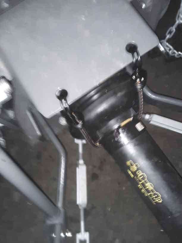

I have been having a he11 of a time hooking up the PTO for my blower to the tractor. Limited space and needing to pull the yoke back while pushing the shaft on.
Anyway, I don't know in what threads I read it but a lot of people suggested using a bungee cord to take the weight of the shaft would make life easier.
Tried it today and instead of taking me 15 minutes to get the PTO on I had the blower completely hooked up including the PTO in under 3 minutes.
Just wanted to say thanks to TBN and all those that suggested this in the multiple threads, you have made my life much easier.

... needing to pull the yoke back while pushing the shaft on.
Don't do that.
Ignore the latch. Get the splines aligned and slipped on until it hits the latch. THEN manipulate the latch and slide it on the rest of the way.

That's sorta what I meant, I would get it started on the shaft and on as far as it would go then work the locking collar, but it was still a batch to get it on. With the bungee, not only was getting is started easier but dealing with the collar and getting it all the way on an locked in place was easier. Took seconds. I thought I was fighting with the collar and what I was really fighting was the weight of the PTO while I was bent over like a pretzel :duh:

I'm surprised that no one mentioned raising the implement up so that the shaft is level with the PTO (ie: no bend) or to 'lanolin' spray/lubricate the splines prior to inserting.
It may be hard to see in the pic, but with the blower on the ground the PTO is just about level. I also keep everything lubed up with Fluid Film. It's a really tight spot. When tested with the bungee I also did it before hooking up the top bar, another tip from TBN, and that gave me a little more working room.
