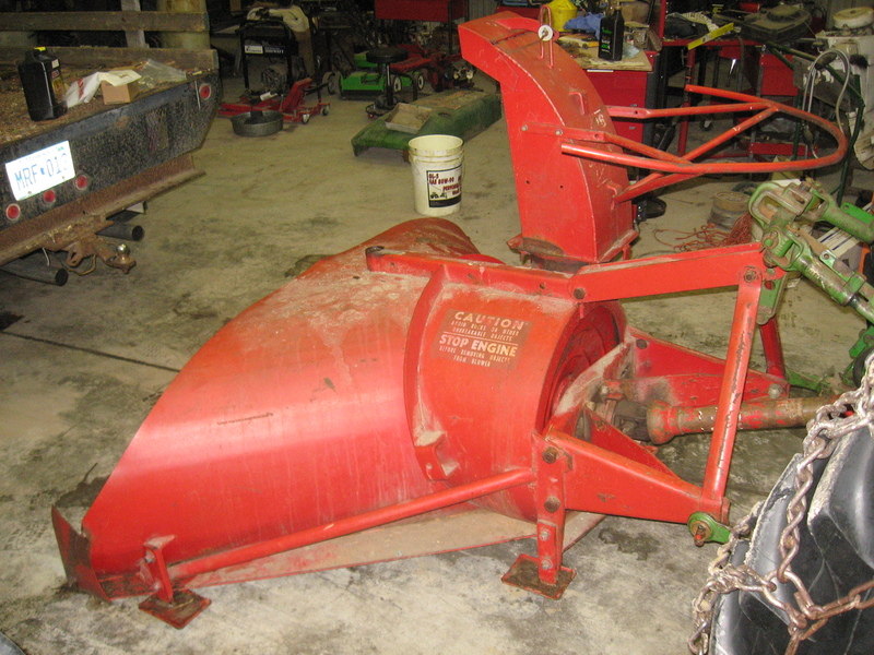

I don't think it is a pull type blower, but there are ones like that one that are pull type. I have seen them around for well over a thousand dollars looking in the same condition. If it works i think it would be worth it, you cant really find a new one for under $2,000.

It figures, I'm 30 minutes from this place. I don't even know if mine will work in deep snow, but if it does, surely it won't be easy to pull something through deep snow. From my experience, I would say these single stage blowers are perfect for long driveways that get smaller snow falls. You can operate these at quite fast speeds.

Hmmm...but it looks like a push type to me. I'd prefer a pull type though.....I pull snow with my 6' box blade, and then push the pile out of the way.

Most of our snowfalls here in upstate NY have been 1' or less, with the occassional 2-footer. The Adirondacks to the west save me from huge storms. I have about 700 feet of driveway, including the circle at the house. I also saw a 7' twin-auger Inland Steel and Forgings unit for $850, in pretty nice shape. That interested me more, given both are 3pt push types. It seems the Inland would move more snow, but i am unfamiliar with the capabilities of the design you built, Dave. Am I mistaken??

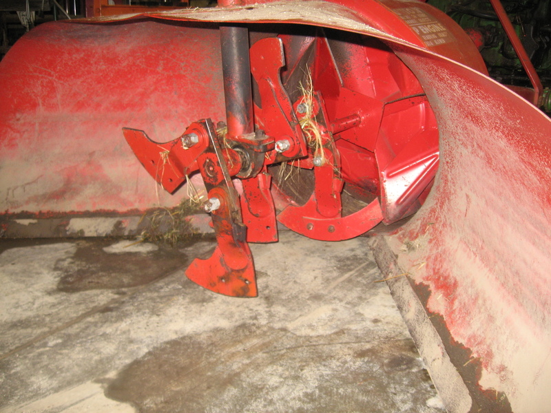

The best way to remove powdered or hard-packed snow.
From Frangards web site. I suspect that this type of blower is better suited for colder climates and for scraping down hard pack. Time will tell for me. I should be able to fab up an auger to my blower if it does not work out. It was all a timing issue and money issue.

Page 4 of this spread shows the arrangement I have for feeding the blower. I get very little snow coming over the top (2ft high). Unlike a conventional Auger which spins very slowly, this setup spins at PTO speed so would require a full cover if the auger was extended to the front. All doable but I am very happy with its performance now and its great that I don't have to spend 2.5 hours hauling in my camping gear. I have gone from a 2 times in the winter visit, to every three weeks now.

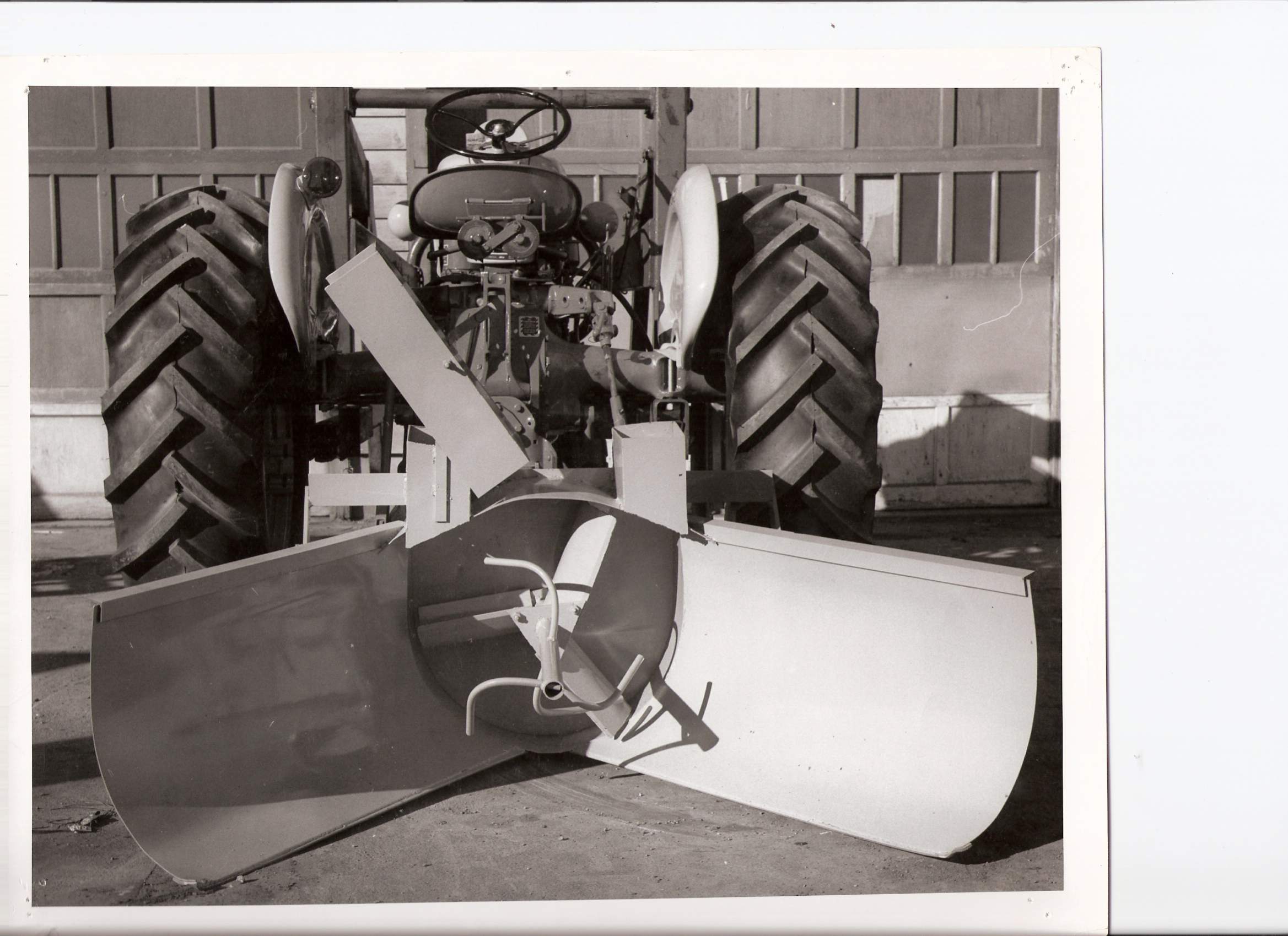

Snow season just ahead here in IDAHO and was reading all the threads. Dave, you did an awesome job on your unit. I just completed a pretty long PM to foggy1111. His picture of the unit his dad built was particularly interesting and I asked him about the 'egg beater' pictured. Since I have not used my unit yet, was wondering if that add-on might help. It looks as
though the unit I bought will work great in powdery snow and clogg if it's too wet.

As soon as I can fix my printer/scanner I will post a picture of another possible solution to snow "pushing" on these type of blowers. As stated earlier....the major problem with these blowers is getting the wet snow to feed into the blower as it tends to bridge in front and push (thus why you typically find augers in front of the blowers today).
One solution to aid in snow pushing was to add "knives" which were welded to the heavy-duty rotors....as found on the machines produced back in the 50's (I think the rotors on my dad's machines were from about 1/4" to possibly 3/8" (?) thick material. These "knives" were about a foot long and 2' wide (likely 3/8" thick) and were attached by about a 4" weld with the 8" balance protruding in front of the spinning rotor. They did break up clods pretty well. This may be a low cost aid / solution for those with these blower types. :confused:
I believe I would give it a shot.
