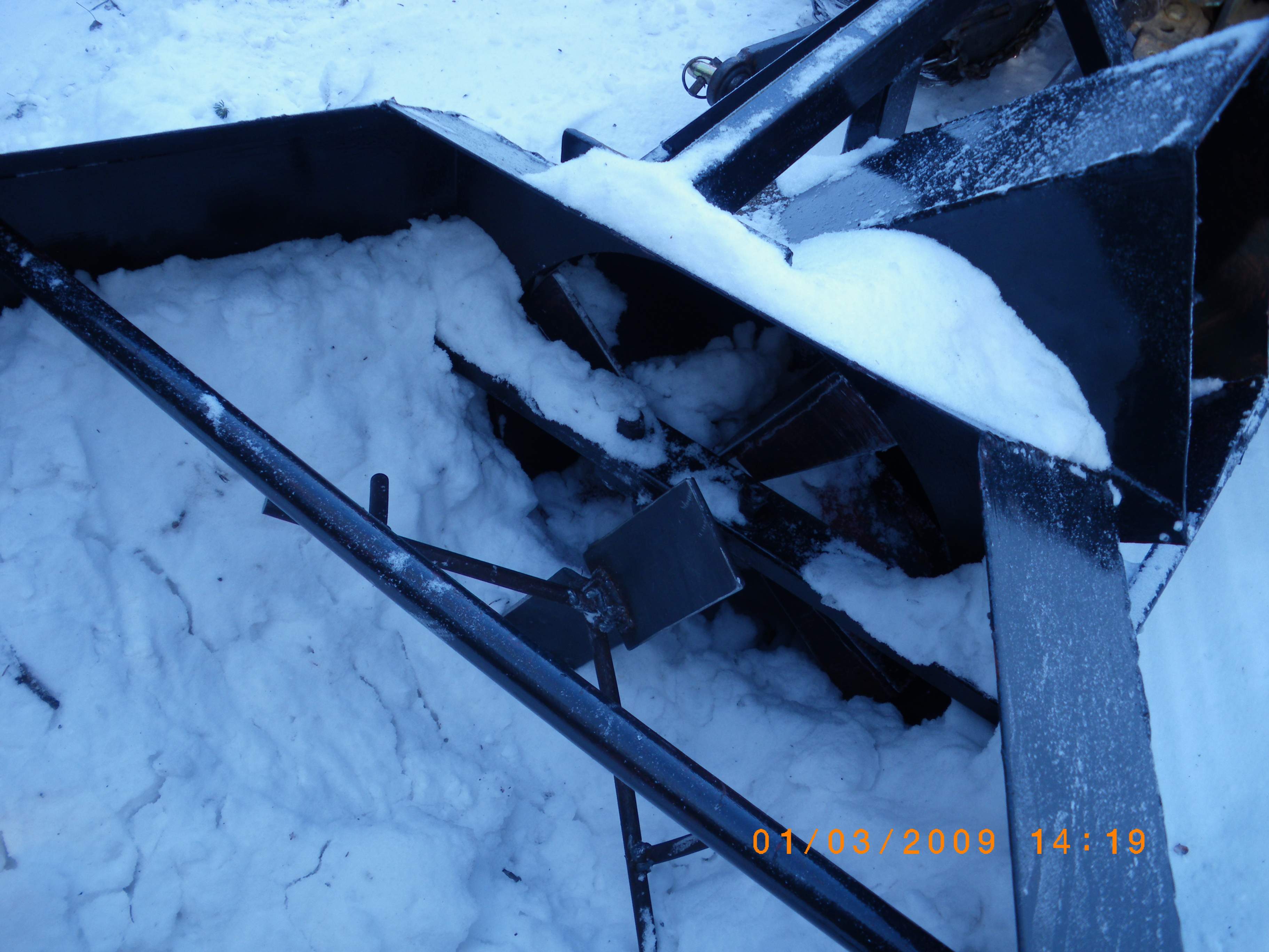

I built a two blade propeller yesterday, as well as made up some spacers to eliminate some interference issues. I shortened the PTO shaft 1/2 inch. My top link at its shortest setting won't allow the blower to sit level so I still have to see if I can cut it down an inch or buy a shorter one. I am 220 miles from the tractor and blower so it will be two weeks before I can do a retest. It is supposed to be up in the 50F range the next two days, so guess I will be hoping for some snow in two weeks!

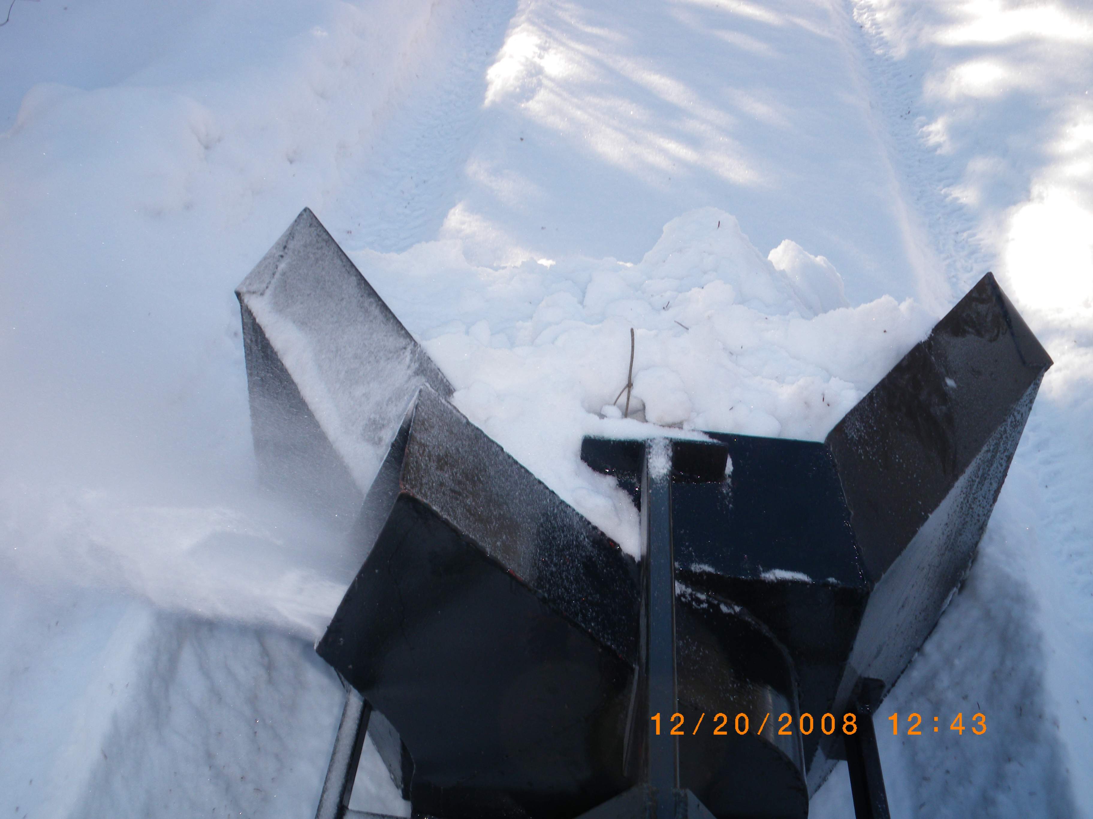

In my zest to build a propeller to help the snow into the impeller, I forgot about the comment regarding getting snow all over the operator. I had to improvise with a piece of plywood and vice grips to spare the worst of the snow shower. I have to say that the blower now works great and once I extend the hood it may remain a useful addition to the family. Next summer (hopefully not sooner) I will have to replace the shaft with something longer as I only had an inch to work with so the propeller does wobble around alot.

Nice!! Looks like it eats the snow pretty good now. I see you are definately going to need some kind of top shield to keep the snow off your back.

Way to go Dave! Looks like your feeding it pretty good now. The arps hood design shown above may be just the solution to the snow showers....lol. It appears as though just a small deflector would help out alot.
From my past experience....keep that shroud as small as practical.....as snow likes to bridge on anything it can....especially when wet and refrozen.
