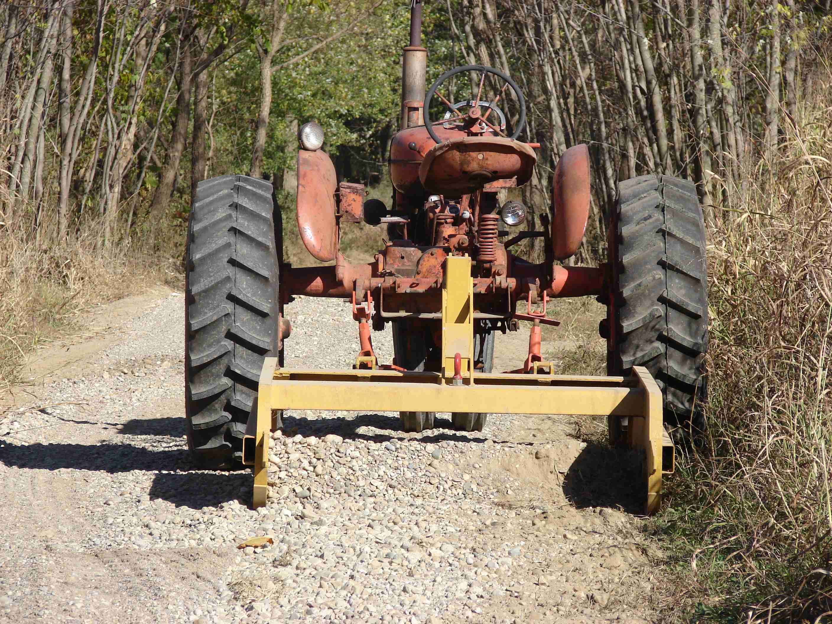

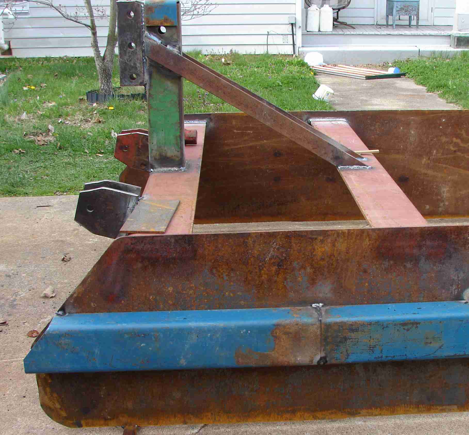

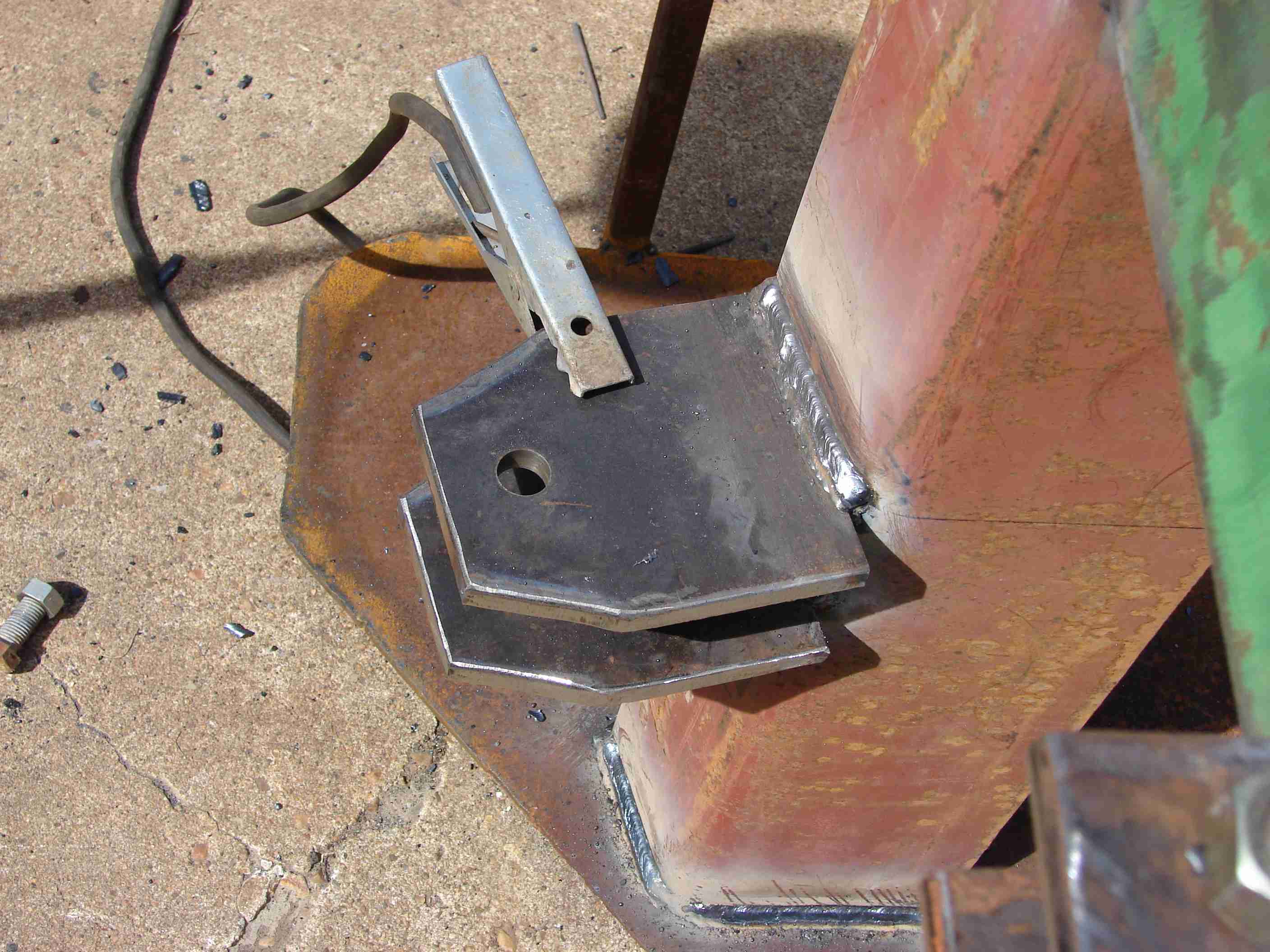

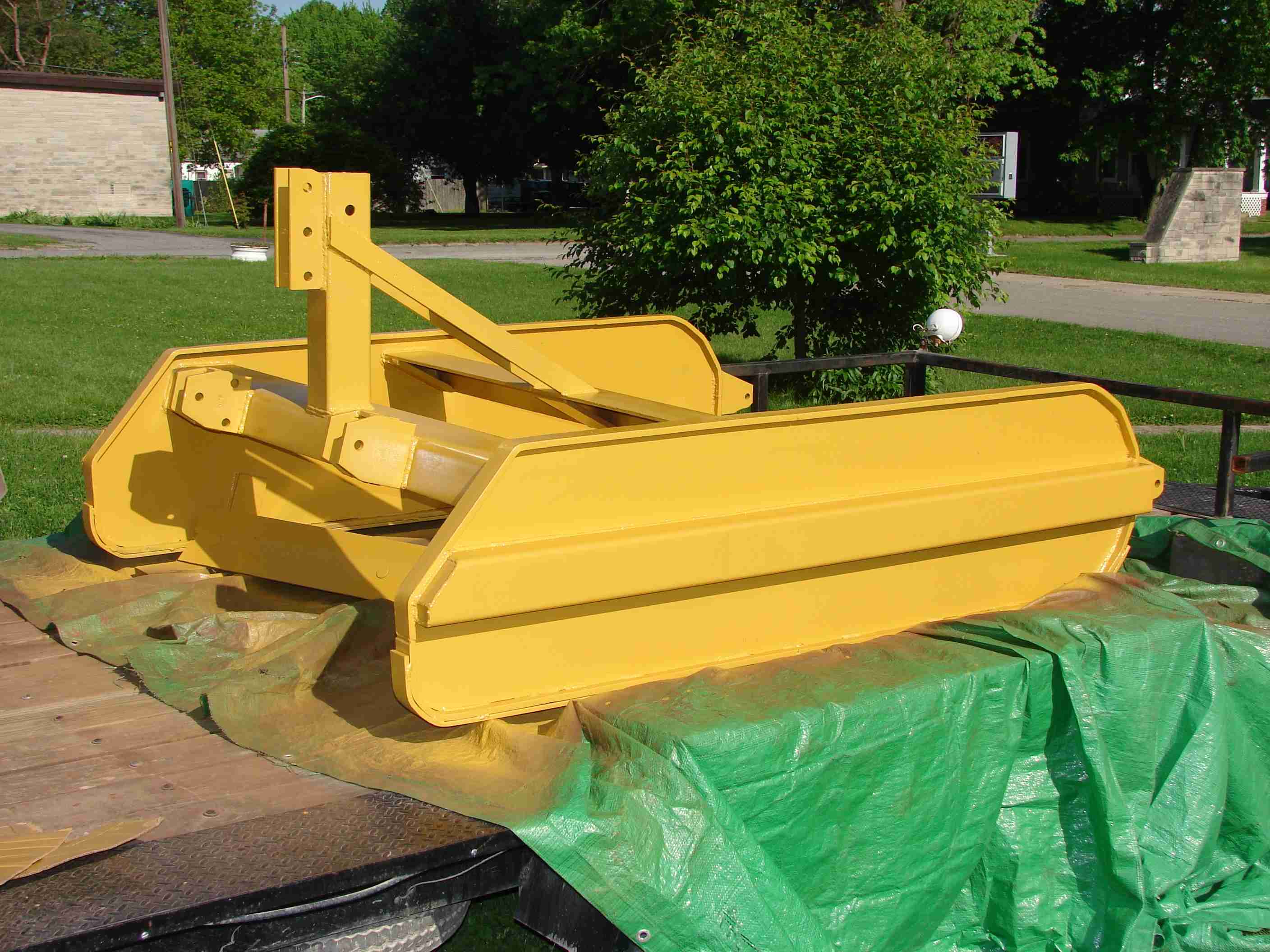

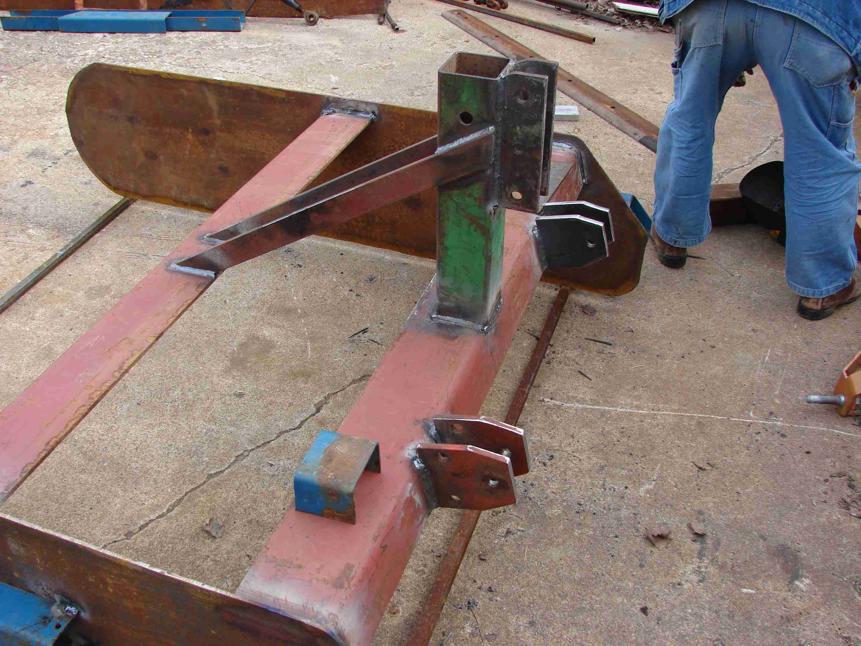

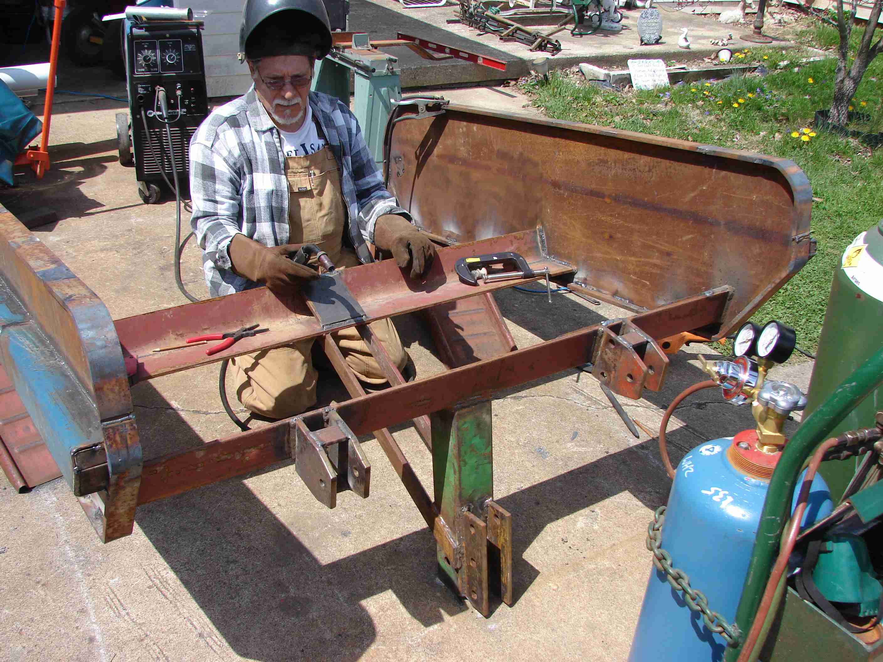

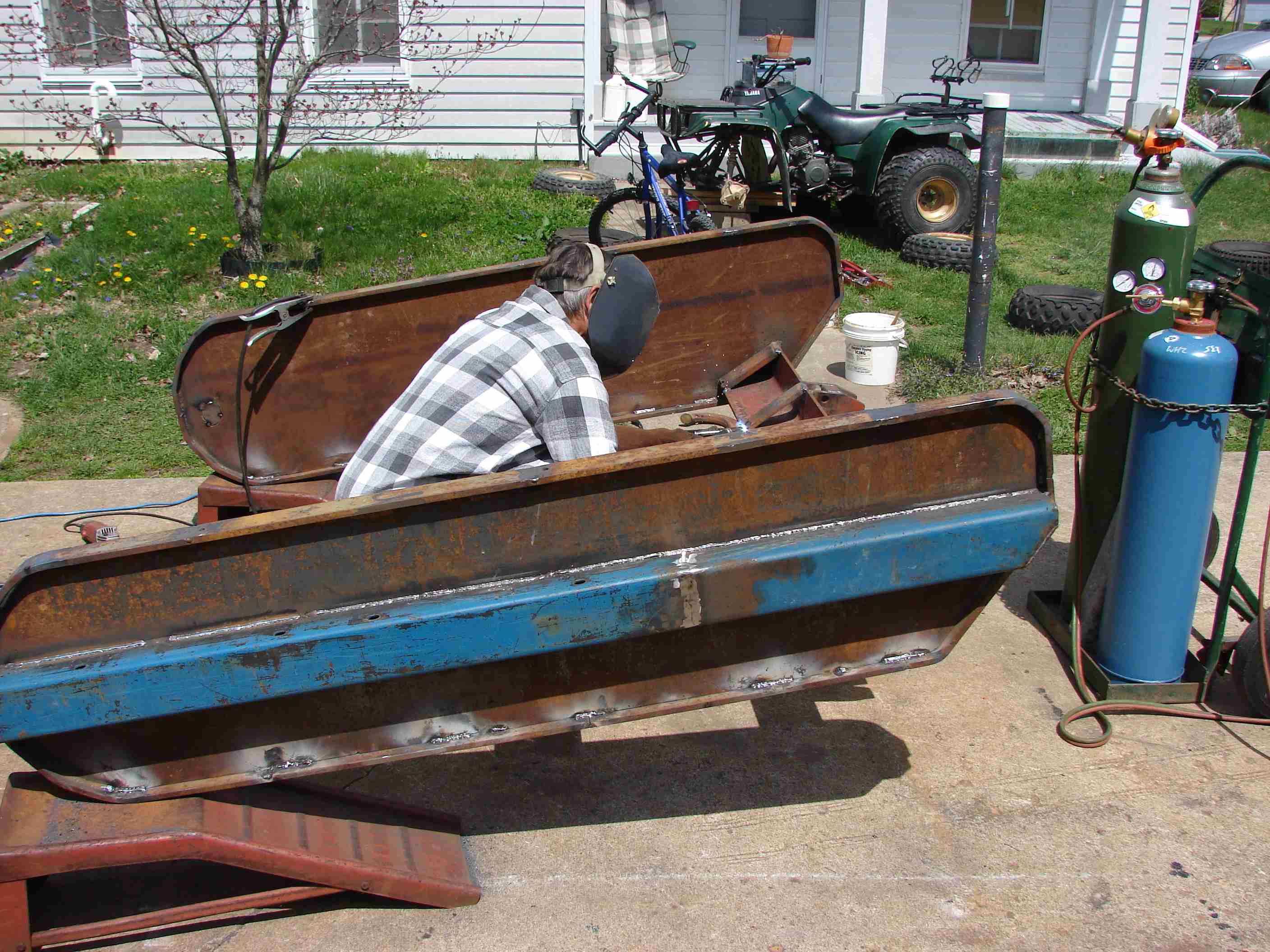

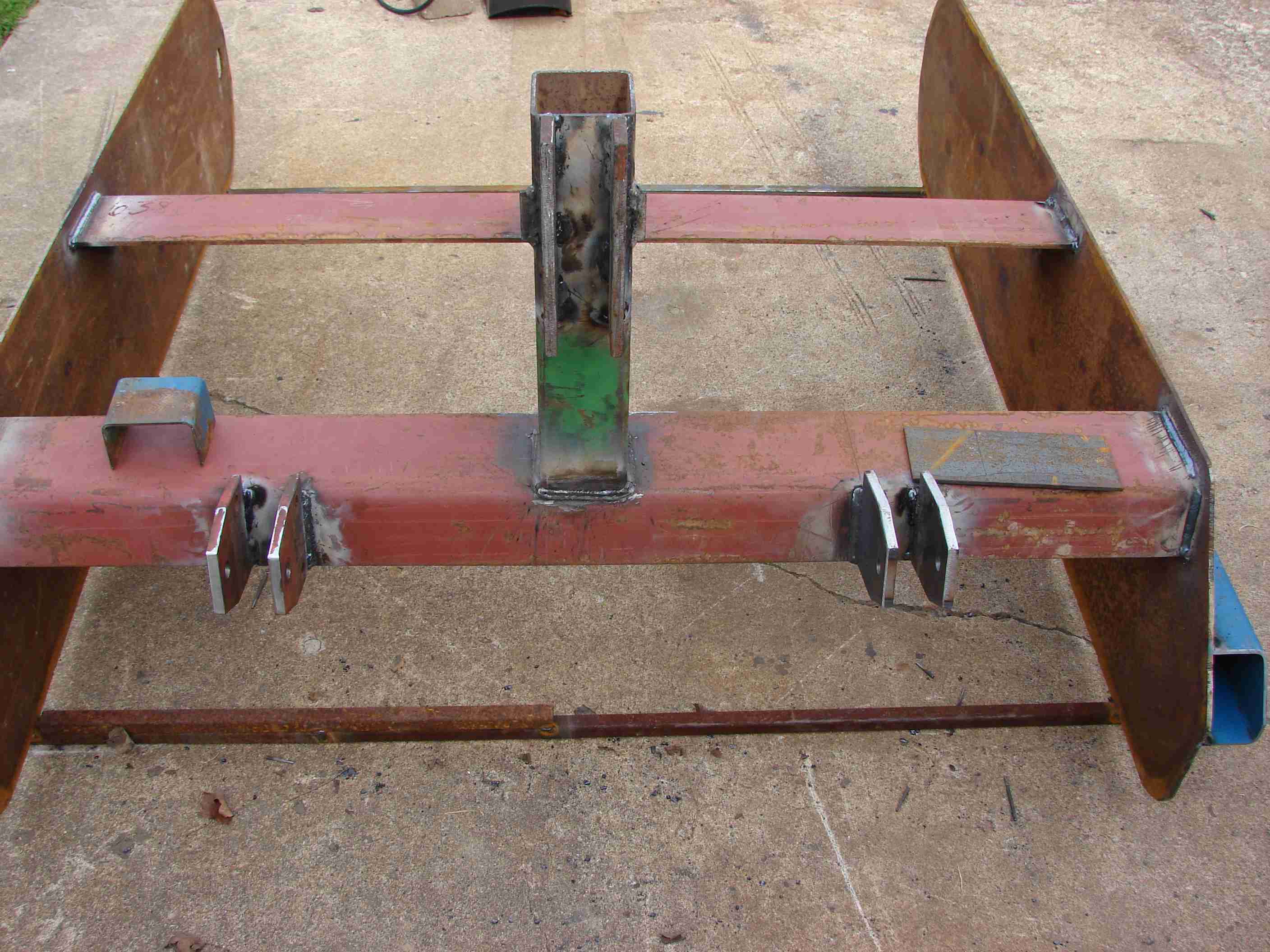

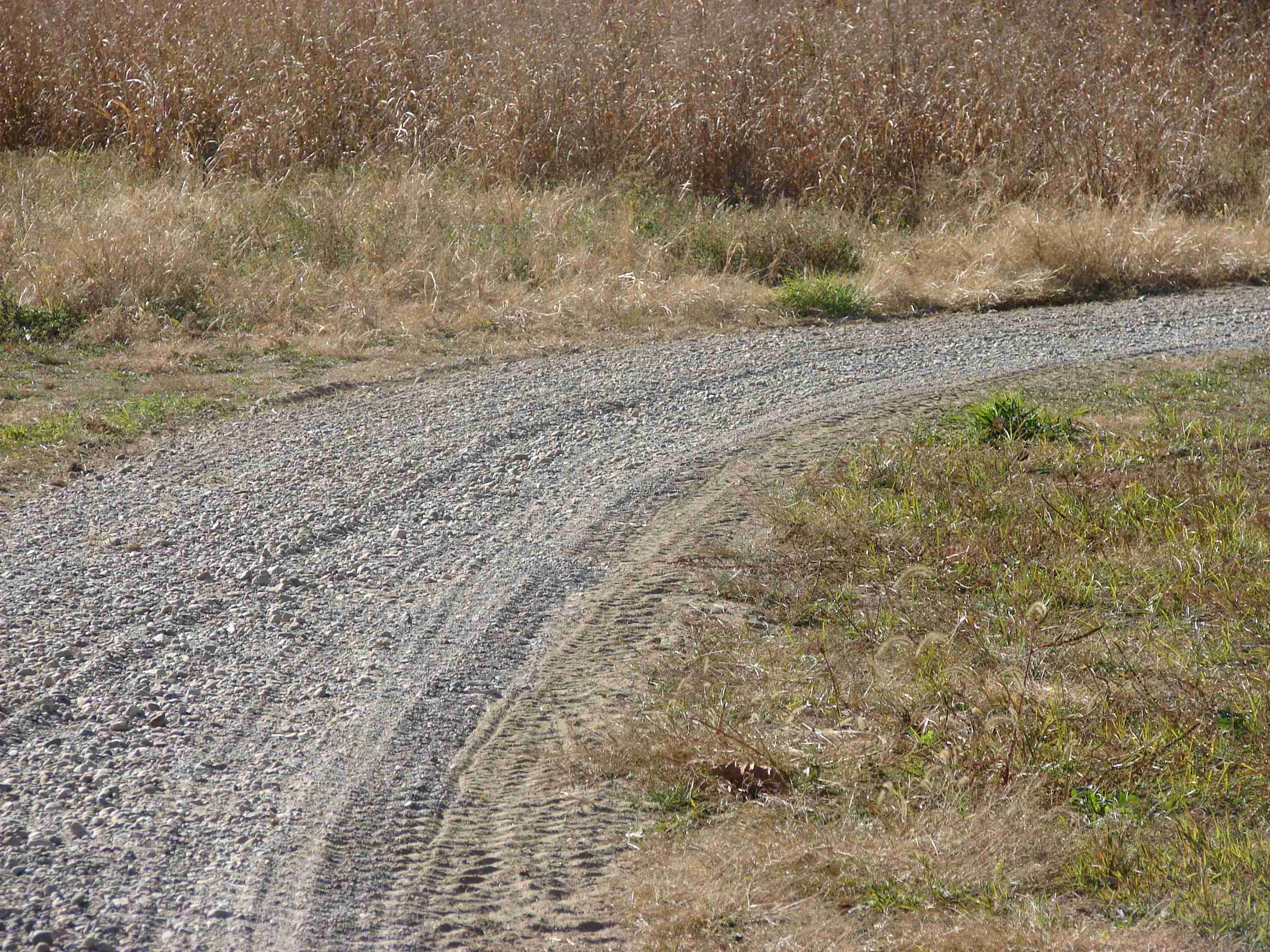

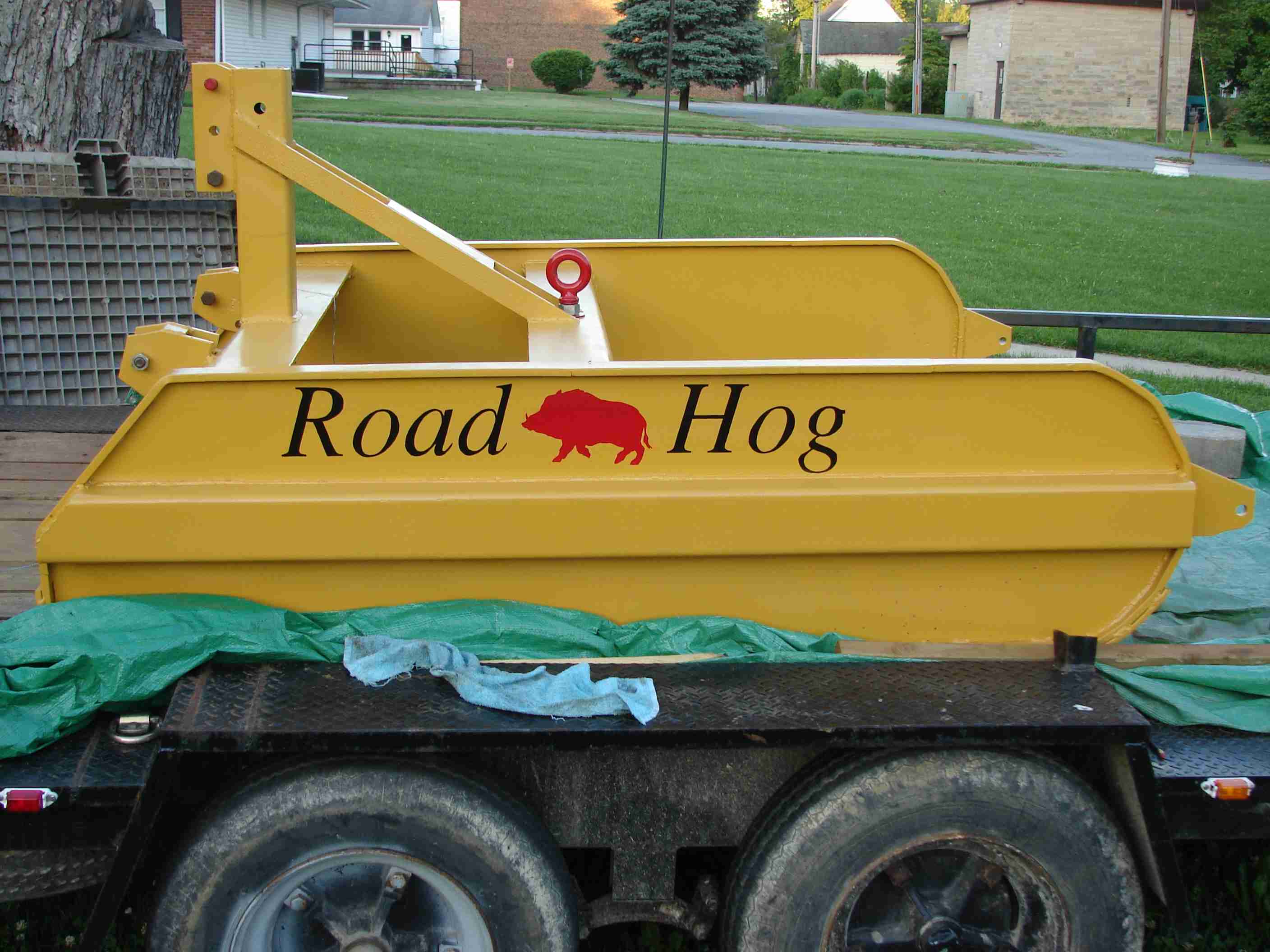

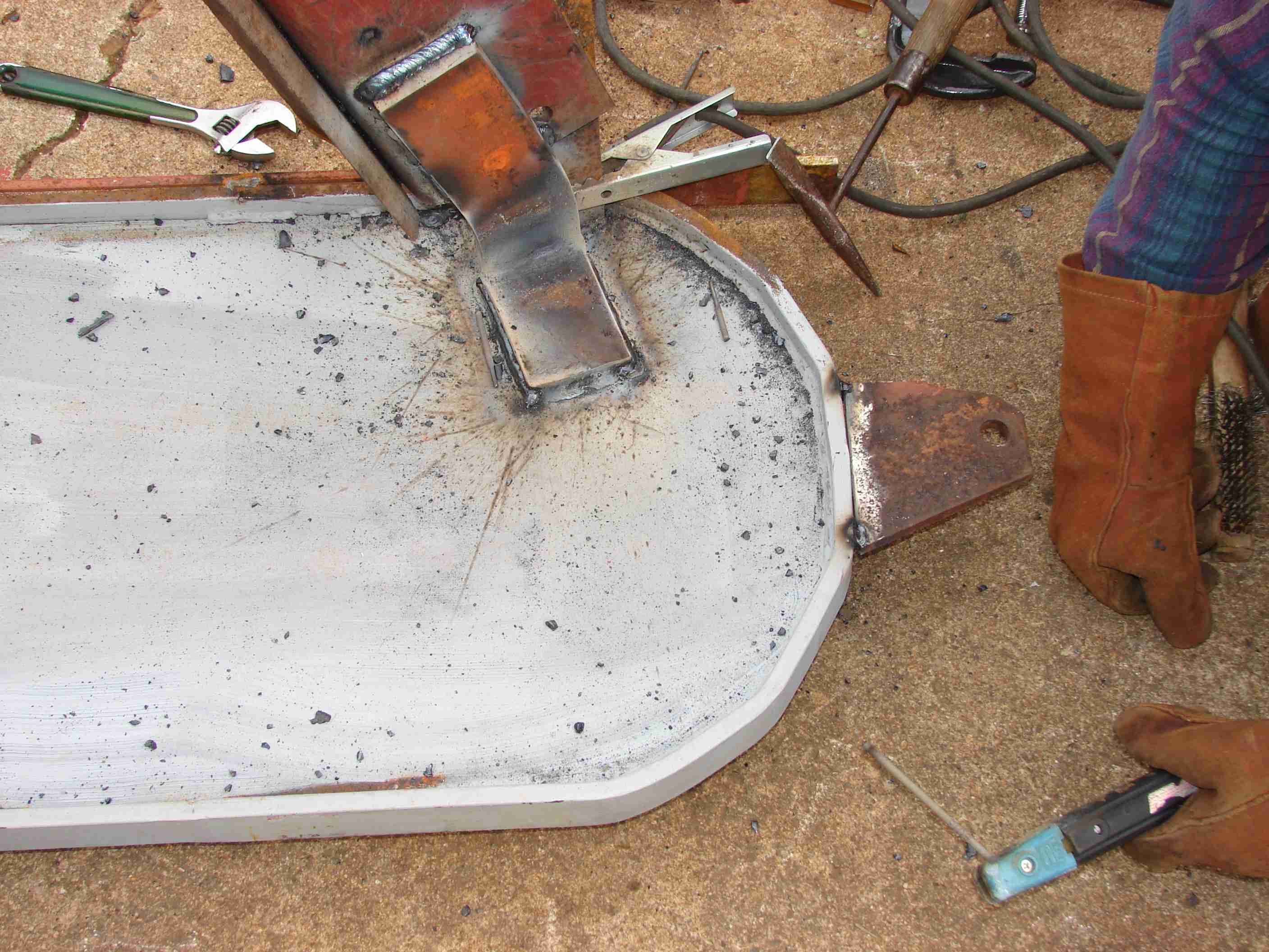

I've hung around here for a long time. I visit every once in awhile and I thought I would post some of our road grader build pictures. We have been using it to maintain a 1/4 mile long roadway for the last couple of years and I really like it. It is a scrap pile build so you may see the John Deere rotary hoe parts and the Allis Chalmers plow parts... ha, some paddle wheel scrap as well. Anyway here are some build photos.

Oops! I wasn't very clear. I didn't straighten it I used it for parts. When I was looking for the blades for the road grader the yard had two. One old rusty one bent up with all sorts of crap welded to it for support and one that was a beast but the three point and swivel pad was twisted beyond repair. I picked both for $60 bucks and used the 5 foot blade just as it was and cut down the other blade and recycled all the unused parts. I still have the heavy duty blade support off the second one. I don't know what I'll use it for but it sure looks nice :).

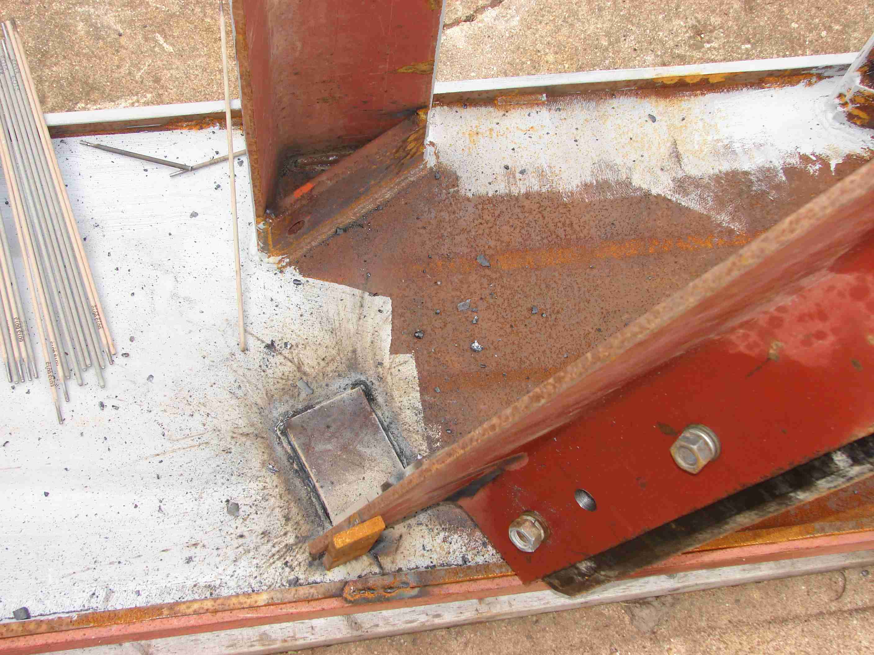

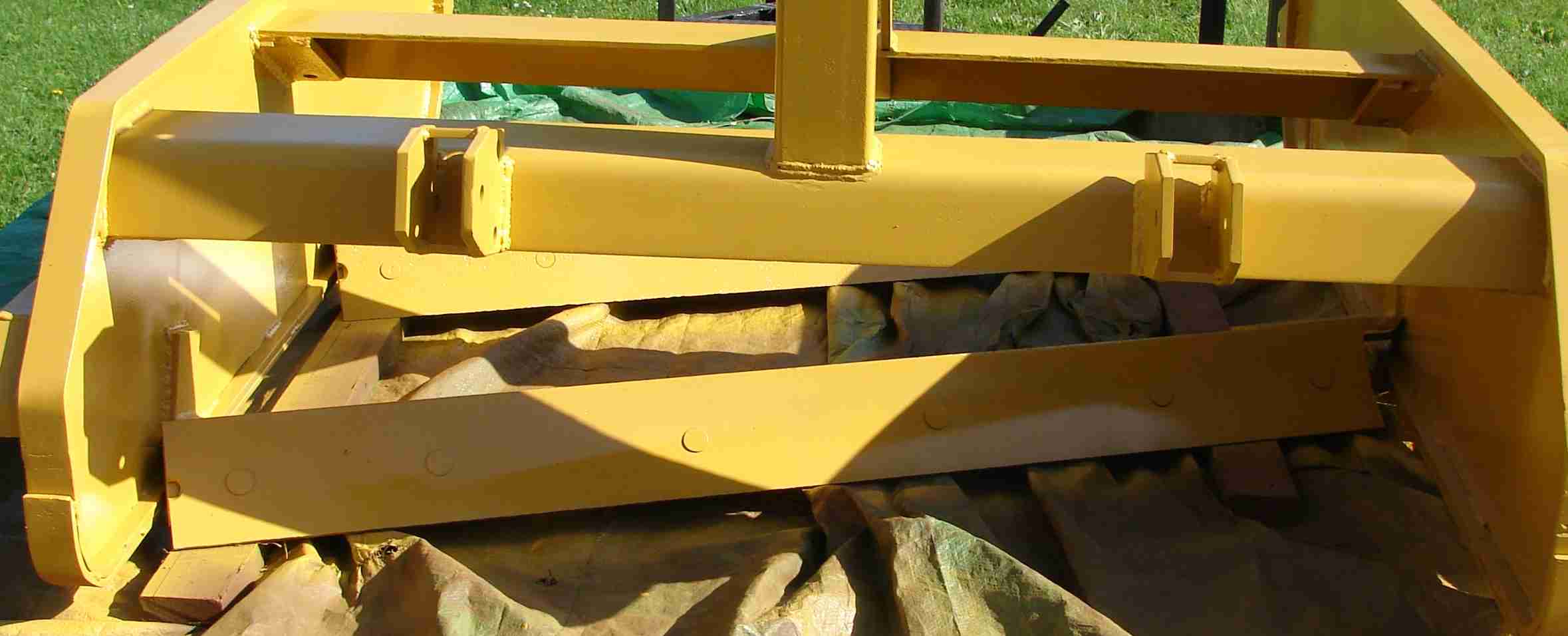

Love the build but I am confused. are the two little rods running across the bottom your blades? Or do you not have pix of the blades?
Sorry.... Great build, looking to copy it.
Carl
/ Homemade Road Grader #19
I think those are warp stoppers, while welding the top pieces.
Bruce
#20

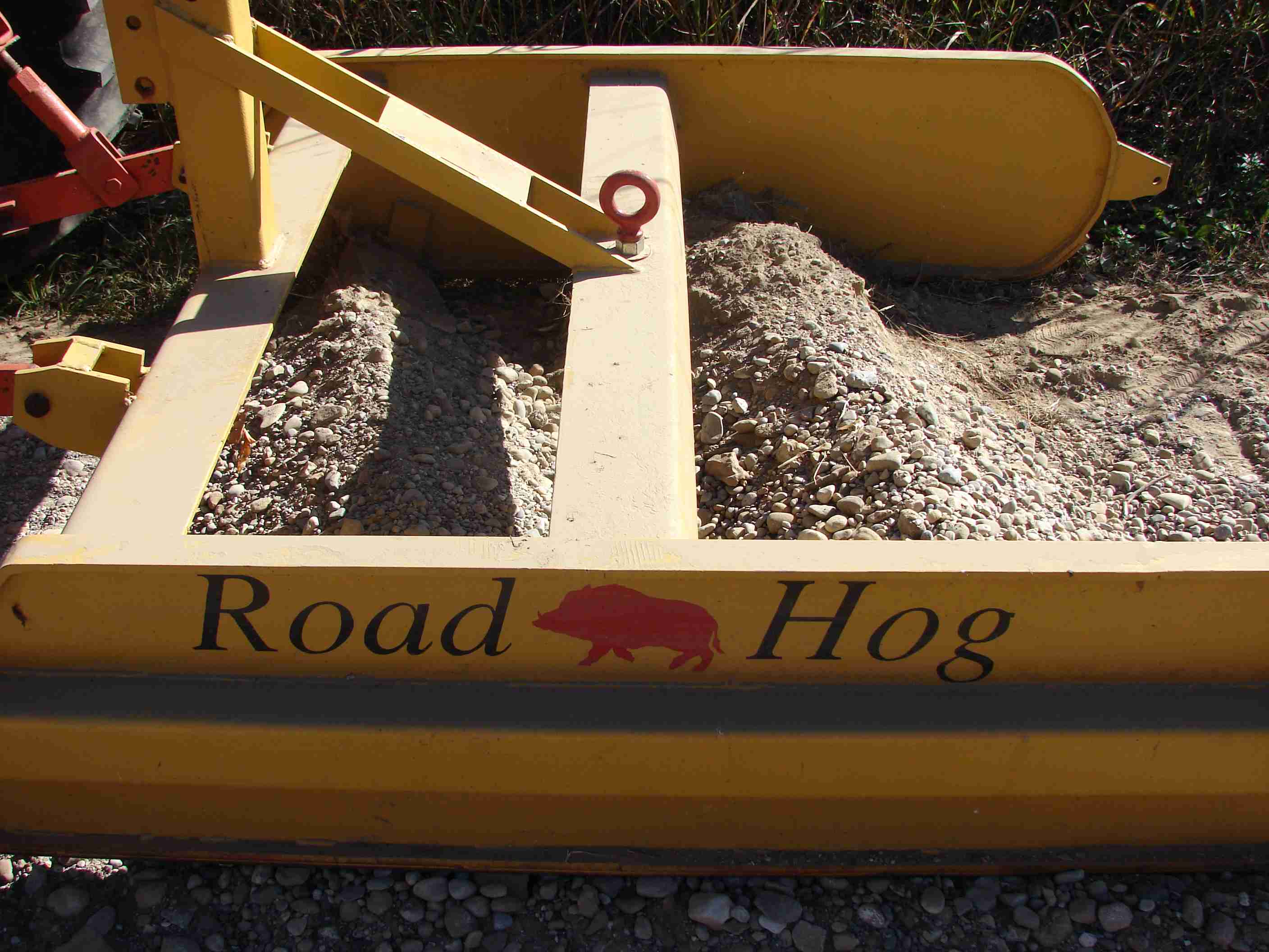

I didn't realize I didn't post any pics of the blades. BCP is right when tacking it all together the welds will pull so we tack in braces to stop that from happening.
I'll post a pic of the blades.
