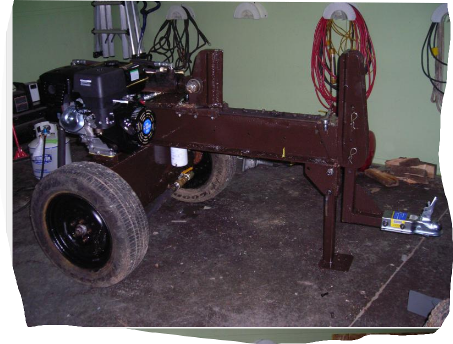

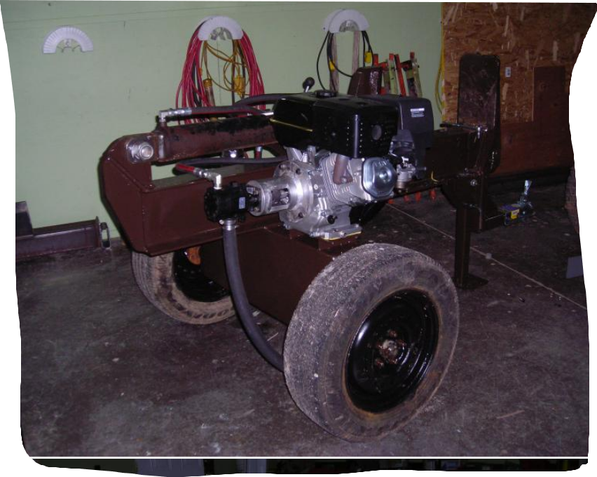

Interesting. Your hydraulic cylinder looks much longer than 1/2 the I-beam length. How do you prevent the wedge from inadvertently driving into the end plate?
On your latest setup, are your solar panels connected to 3 phase inverters, or are you using single phase to a VFD at the spitter?
The cylinder is indeed longer than the beam. The story behind that is that originally had a smaller, shorter and used cylinder, then a friend came by and he said he could get me a brand new bigger cylinder for very very good price. So I went with it instead.
With the wedge pushing against the end plate, I still have about 4" left of travel on the cylinder, if I recall correctly. My end plate is made out of two small I beam sections and I left about a 1/4" gap between them, so the axle just fits in there and doesn't damage the edge. There isn't really any risk of push and forcing it against the end plate and it also helps cutting those annoying strings that some types of wood leave.

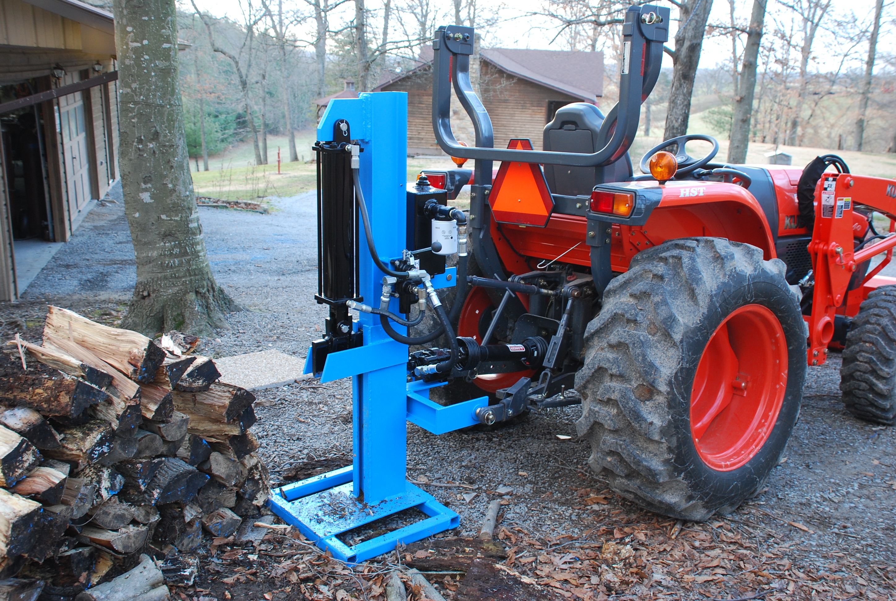

I am planning to build a splitter with a copy of a vertical splitter that can be dropped down to make it more stable. I prefer vertical because you can raise the 3pt hitch and work at a comfortable height.
the one problem I'm having is how to convert my prince valve to spring to the work port instead of neutral so that I don't have to lift the handle up to raise the wedge. I will have a mechanical linkage on the wedge that pushes down on the valve handle to stop the movement at an adjustable height. it currently has a detent to the work port and a pressure release when it gets to the end of the stroke.

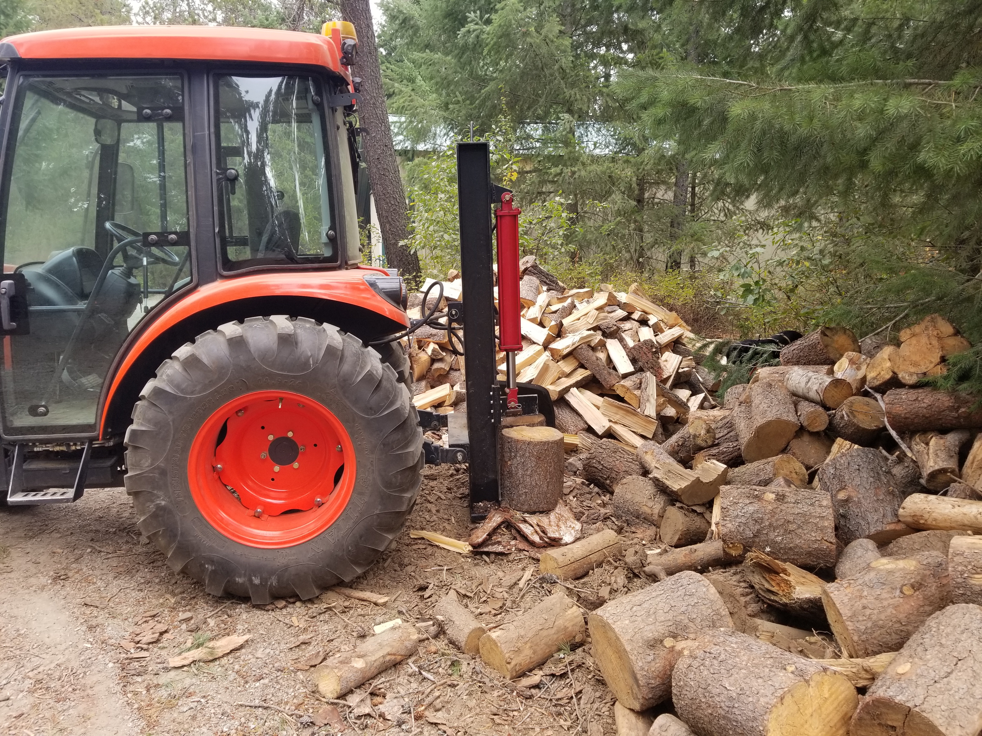

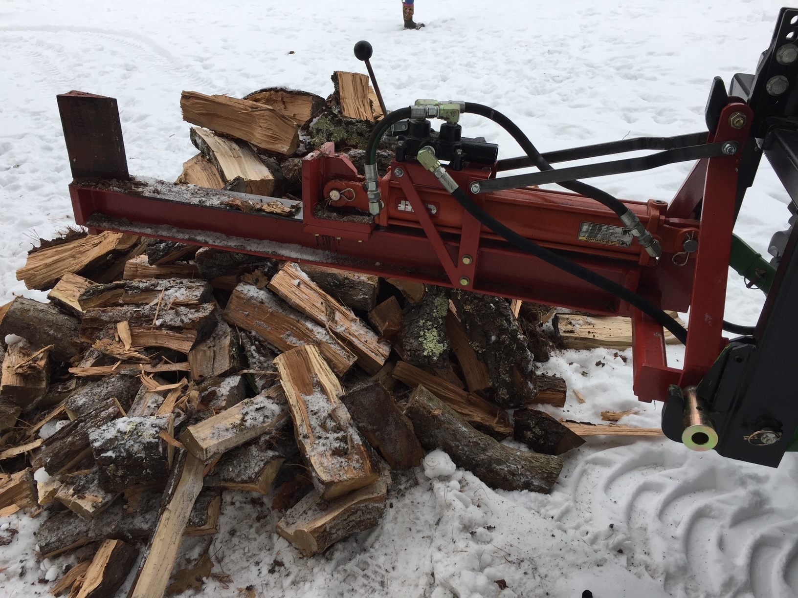

I made mine out of all sorts of scrap / surplus metal i've had collected over the years. couple pieces of short 4" wide flange beams left over fro making low- headroom headers, the triangle from a dismantled 3PH grader blade, 2" square tube crosspiece from making a trailer axle, and a hacked up 4-way slip on wedge, and lots of other random leftover pieces that fill 5-gallon pails around here. it used to have a one piece top link, when i built it in 2006, but I converted it to the current strap style pieces so it was quick hitch compatible.
Tractors have single stage pumps, while stand-alone splitters use 2 stage, so no-load applications like retract and taking up empty space on the beam is slower on a tractor. To compensate for this i sized down to a 3-1/2" cylinder, with 18" of stroke so I don't have to move as much fluid. I burn 16" wood, so 24" stroke is a waste of take-up time in both directions. I've had large hardwood on there with nearly no issues - some so big i had to lower it to the ground and roll the rounds on. only time i had any issues is splitting directly into a big knot. that was mainly due to the blunt nature of the slip-on wedge i used. I added a 1/4x1/2 flat bar to the nose of the wedge and sharpened it to a knife edge and that solved most every cut.
never a regret on the smaller cylinder and stroke since i built it.

built this one 14 years ago. pto driven still use it but on a bx 2340 now
   / Homemade log splitter. Anybody made one? #30
nice compact design, i like the bars to pop the wood off the wedge as it goes back up. that bottom plate looks kind of thin. I'm assuming there is a tube frame bar aligned with the wedge to help support the force of the splitter bending the plate.
