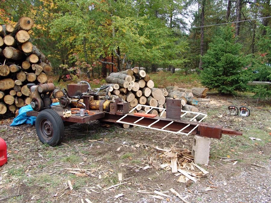

I built this 29 years ago, all from scrap parts. The engine is a Wisconsin single cylinder engine built in the early built in the mid 50's for $75. It needed a new magnito.
A friend of mine gave me the hydraulic pump. I bought the hydraulic cylinder in Denver while visiting my sister. I have no idea where I got the steel. I bought the selector valve, hoses, and fittings.
Since it wasn't an engineered product, it runs how it runs - slowly. Anyway I have split a lot of wood with this ugly beast.

That's a great looking old machine..Those old Wisconsins are beast. If it isn't lugging too much can you speed it's cycle time by decreasing the pulley size on the engine?
Does the hydraulic fluid get very warm in the tank? The tank on my 34 ton splitter is about 2 times that size.

The magnito is fine, but when I bought it many years ago, I had to replace it.
The hydraulic fluid gets warm, but not hot. It still has the original hydraulic fluid in it that I installed 29 years ago. I bought some new fluild a week ago and was going to replace it, but my mechanic friend said why bother if it is working ok. I think I will take a sample of it out and take a good look at it.
I got the cylinder from an industrial salvage yard in Denver about 30 years ago while visiting my sister at Christmas. It is hard to find used good cylinders here in the boondocks. I needed a long one, since I used to have a furnace that could burn 5 foot logs. The cylinder has never leaked. It has been perfect.
It just looks like the pile fell on it. We just had wood stacked for splitting.
I usually buy 20+ cords of wood at a time which will last 3 to 4 years, so I hadn't used it for 4 years. I replaced the spark plug. Would you believe it started on the first pull? I warmed it up and changed the oil and it has performed flawlessly.

One of my neighbors has one he pieced together that looks a lot like that. One thing he added was supports that kept the log from falling to the ground when it split. He said it saved his back and also a lot of time not having to bend over to pick up the pieces that fell.
Here's one of your pictures with the addition.
