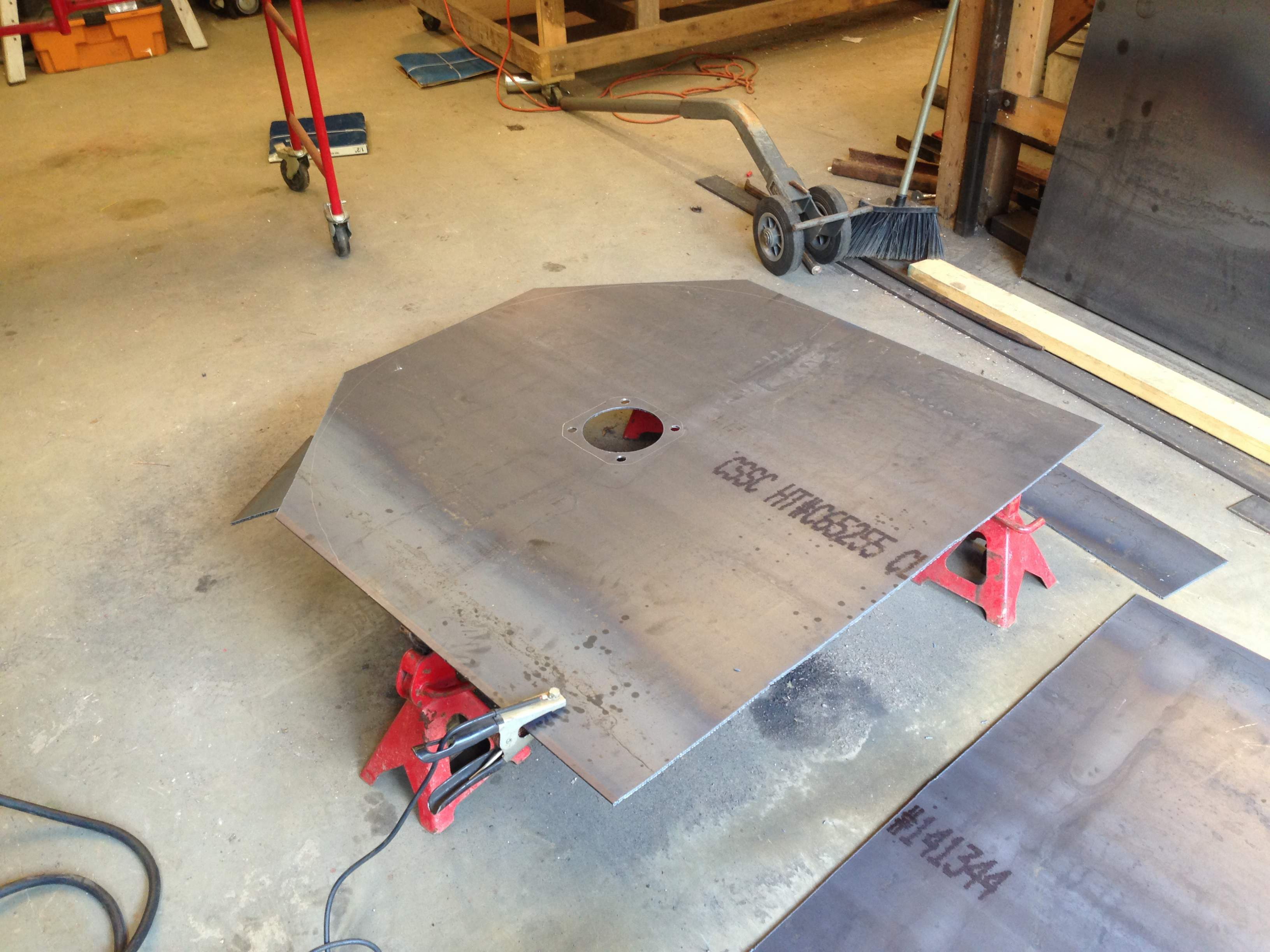

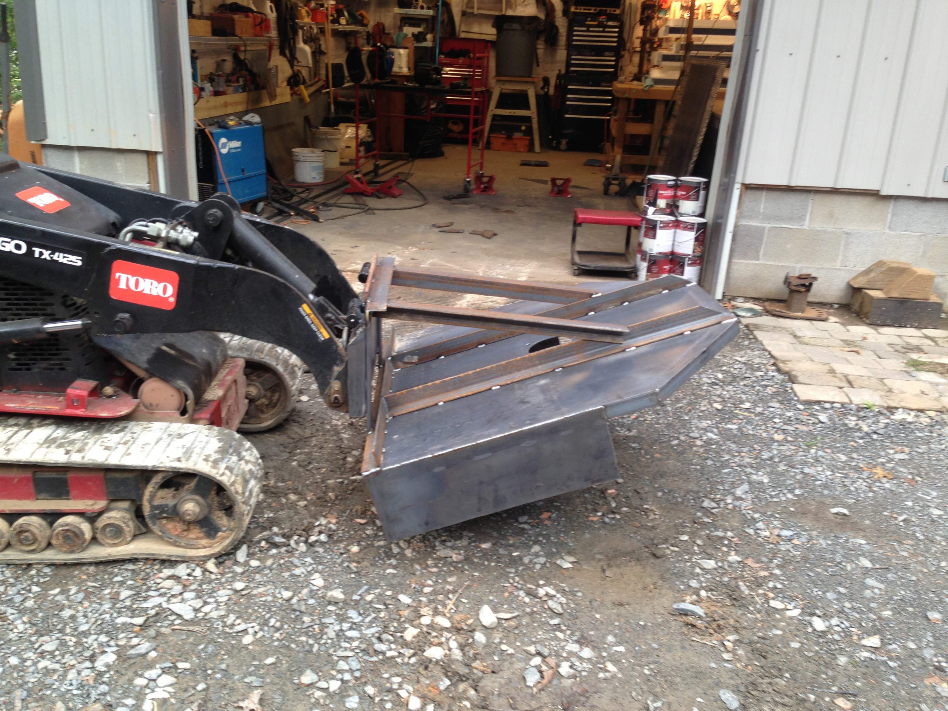

I am building a 42" bush hog for my dingo tx425. It will have a 5.9 ci hydraulic motor
Going thru a 40 hp 1:1 gearbox.

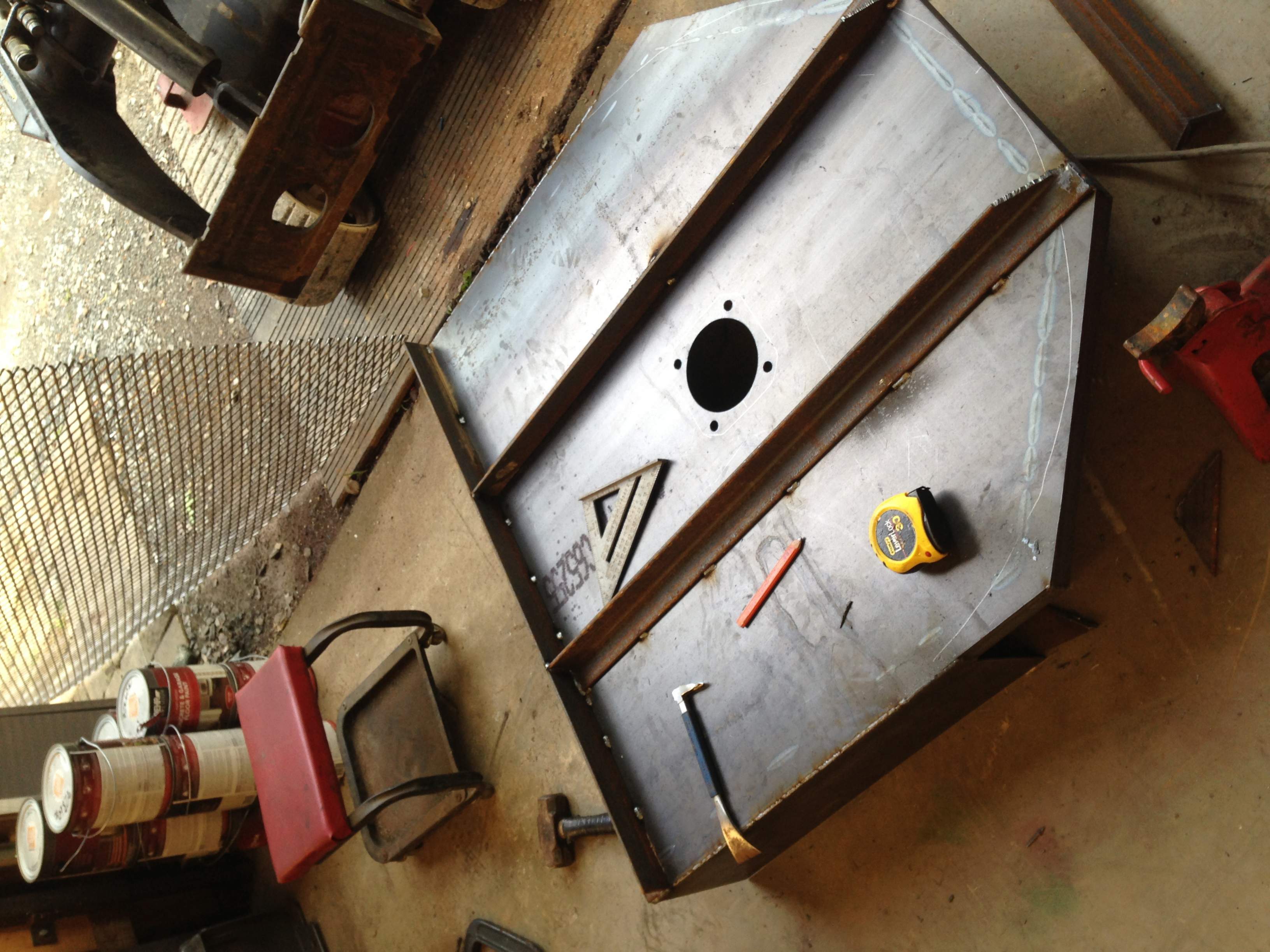

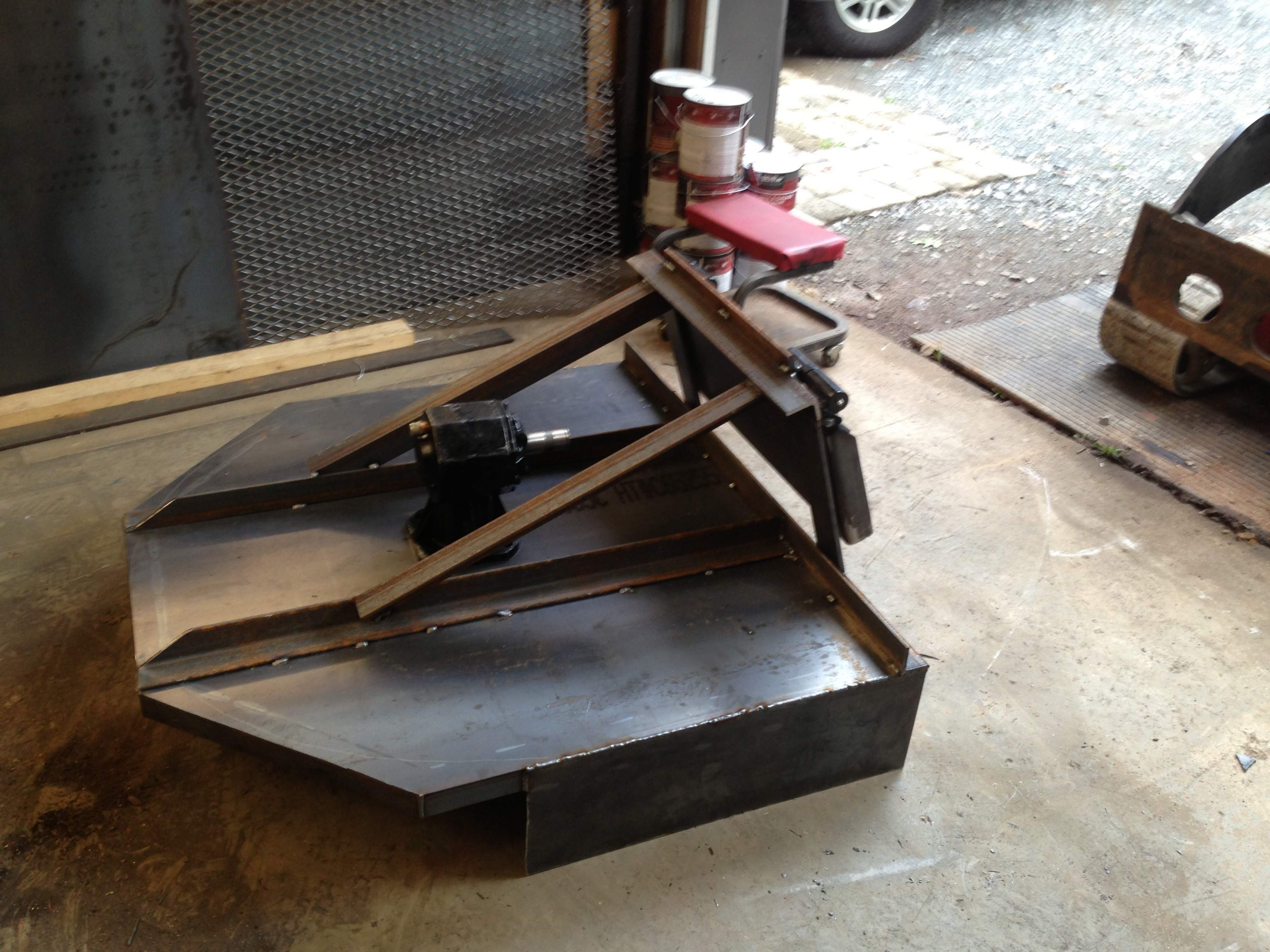

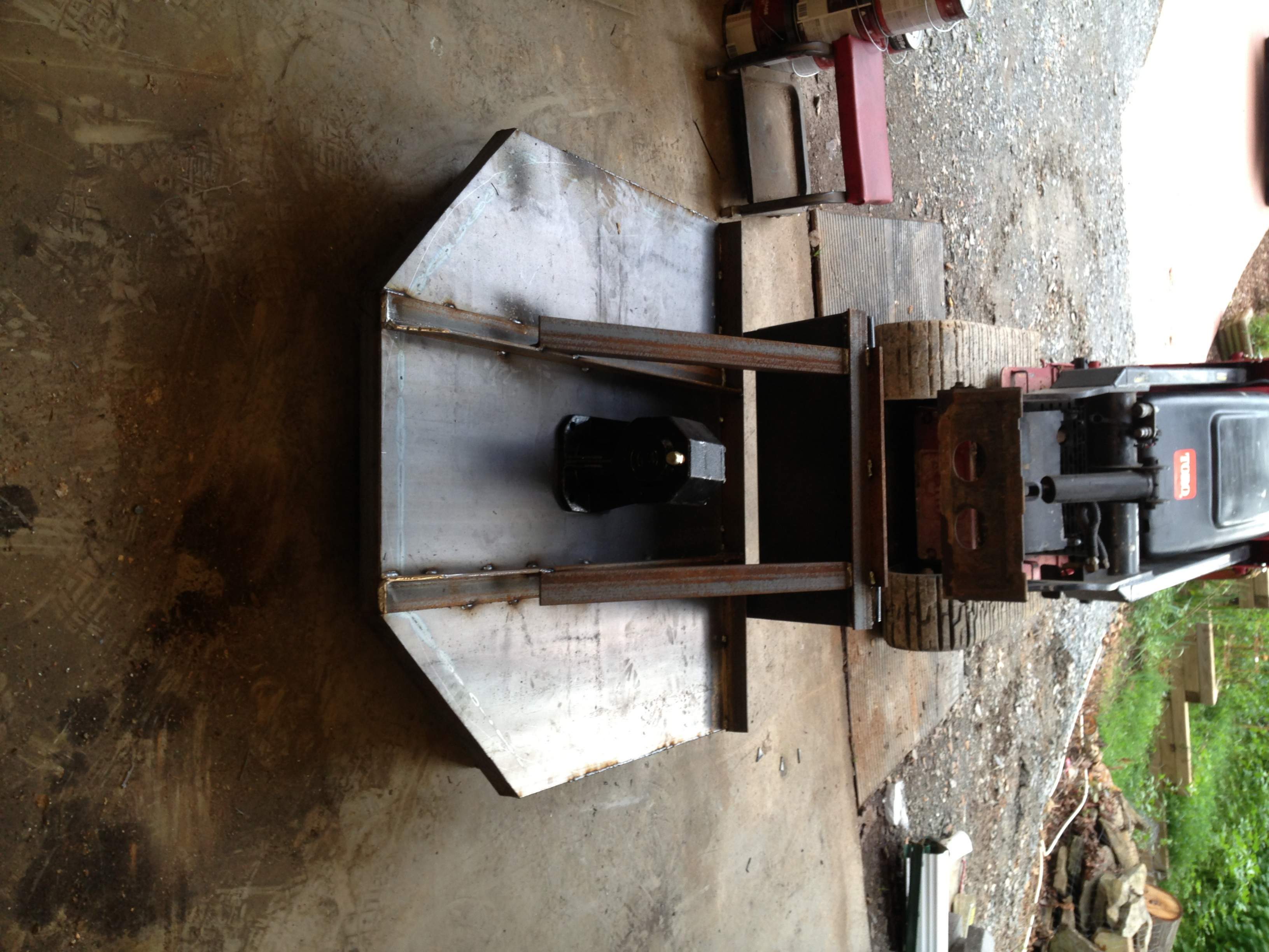

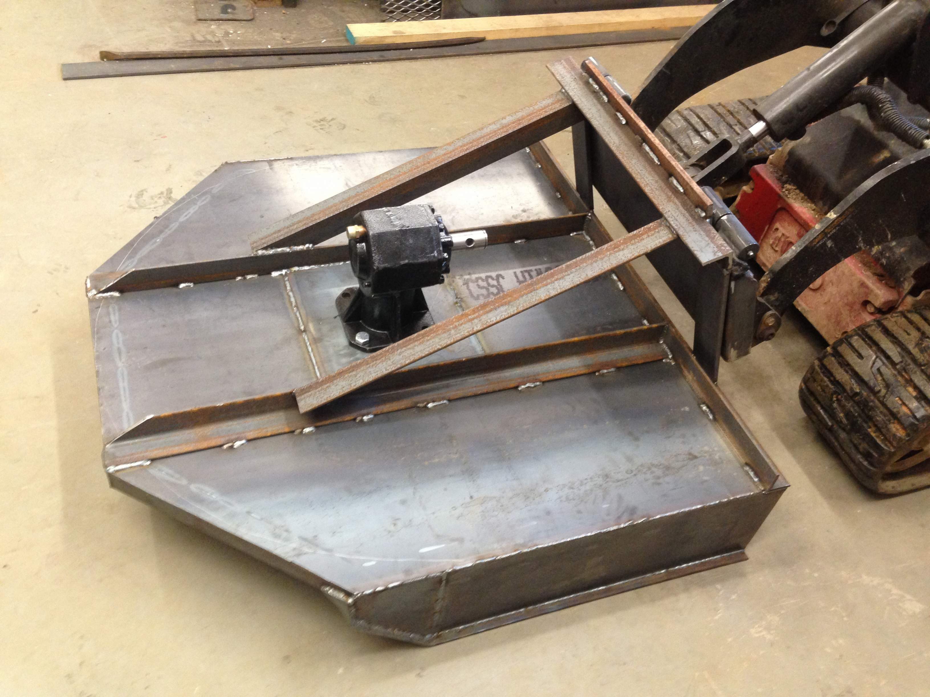

A few more pics. I put hinges at the top of quick attach for mowing up slopes

Cool! What hydraulic flow rate does the motor require?
/ Homemade dingo brush cutter #4
Pretty sweet so far. Are you going to have a pair of castors or skids at the front to limit the cut?
It is rated for 15.8 but my machine only puts out 11gpm. It should still turn 550rpms

I will put 3" flat bar along the bottom for skids. Not sure if I'll need the castors yet.

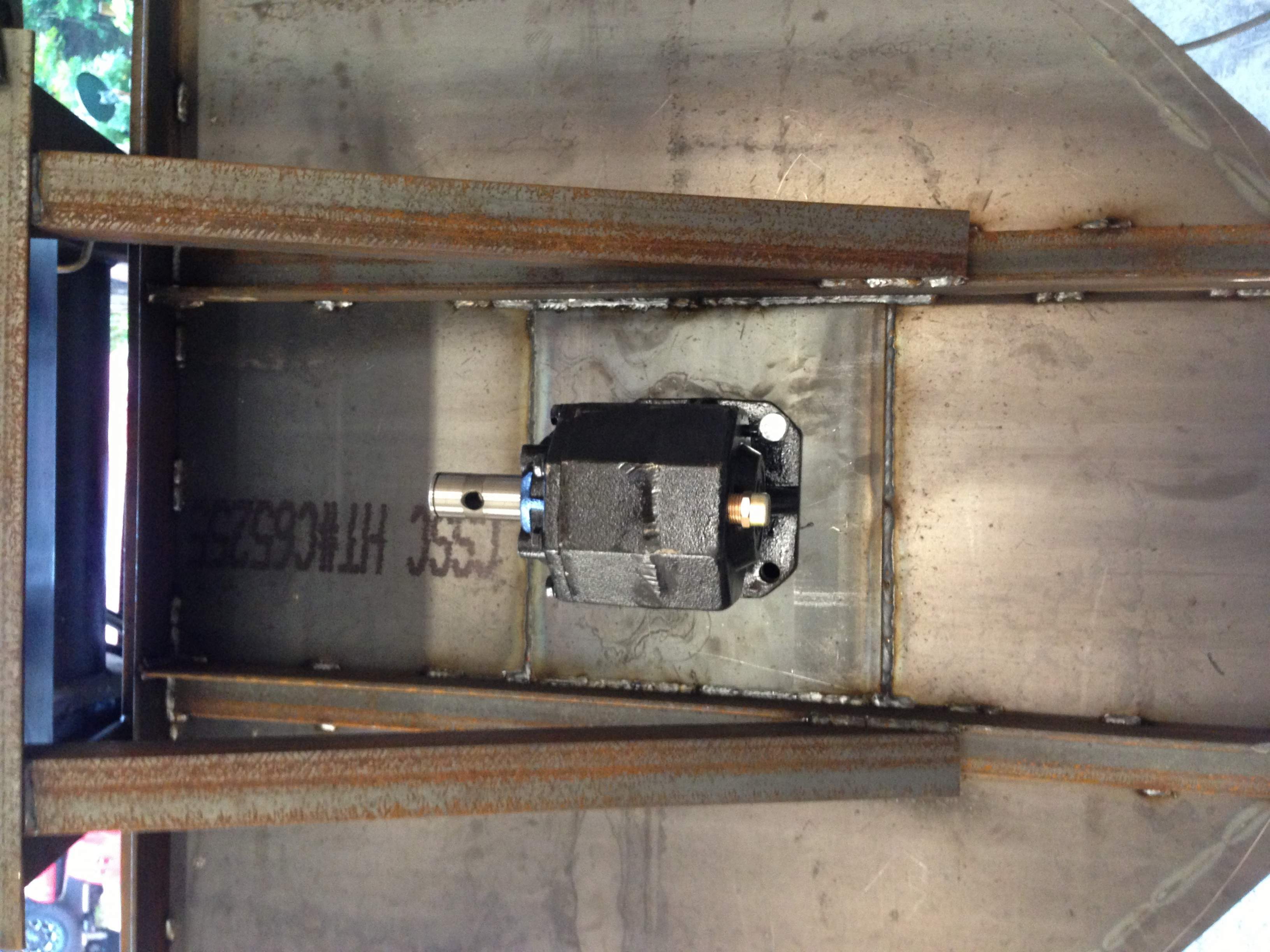

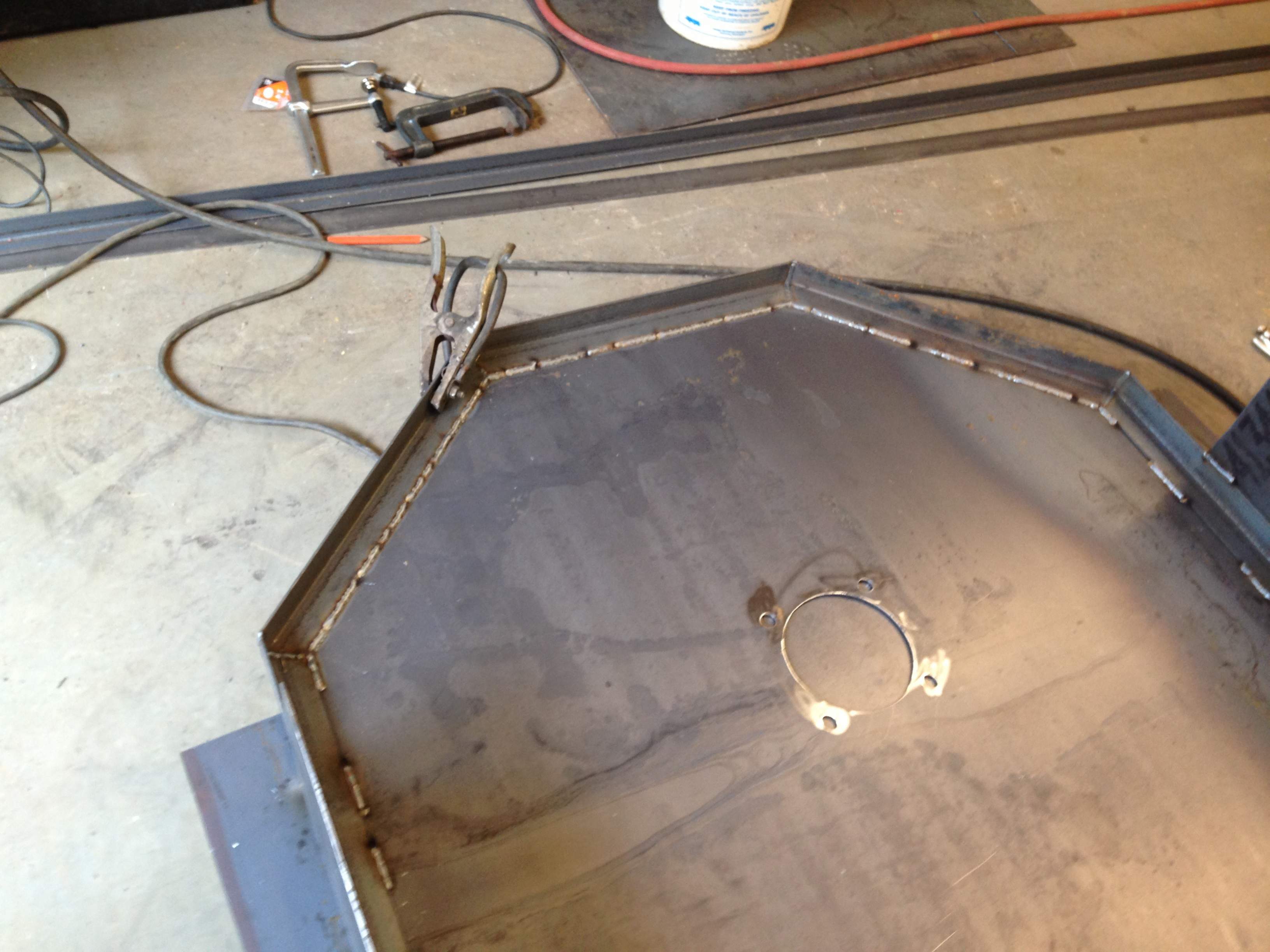

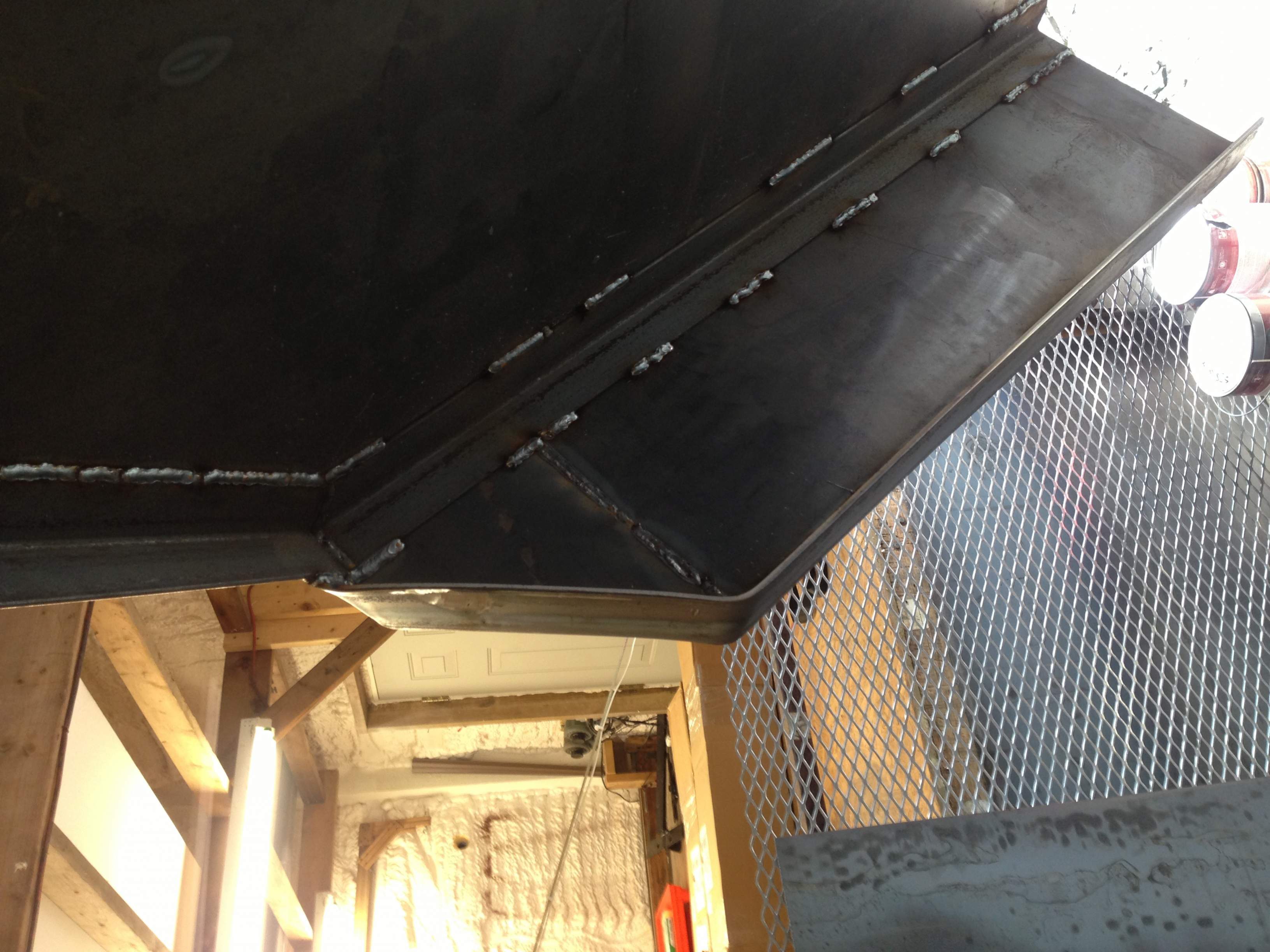

image.jpgimage.jpgimage.jpgHere are a few more pics. I got the skids welded on. I also put in the reinforced plate to mount gearbox

11 gpm x 231 cu in/gallon / 5.9 cu in motor= 431 rpm with no losses.
/ Homemade dingo brush cutter #19
You are only turning 446 rpm using 11.4 and 5.9 cu i motor, and 1 : 1 gear box..
Don't believe that is enough rpm as most bush hogs are 1:1 to 2.5 ratio.
Close to 1000 motor rpm would be better.
Try and get about 12,000 to 14,000 fpm
