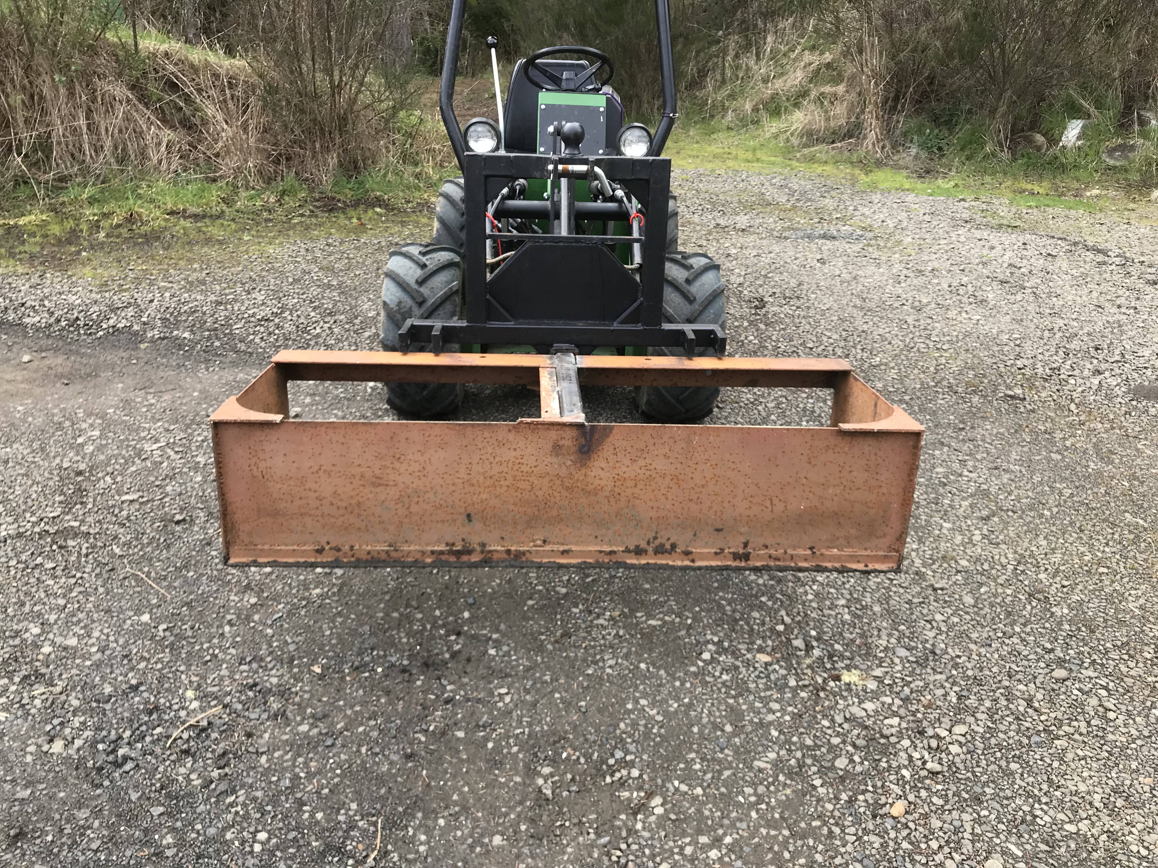

Greetings,
I am in the process of modifying the box scraper I built for my old mini dozer to attach to the hitch frame I made for my PT 425. I welded on a long 2 receiver tube. I intend to weld connector plates to pin on the sides for extra support and additional support up to the top link connector on the hitch frame. But first, I gave it a tryout. It worked really well pulling gravel on our driveway but driving backwards is less than ideal. I know the box blade from PT is also meant to be used in reverse.
I was wondering if anyone has tried to modify a box blade to push forward on their tractors? It seems like it would be much easier to control. I also thought that I could weld a longer 2 tube so that I could hook it up in either the forward or backward direction. I was also wondering if there would be an advantage in either direction regarding traction. I wasn稚 able to apply much downward force on the scraper without the wheels spinning.
What is the consensus on either wheel weights or filling the tires with some sort of fluid. Also, would it be ok to add weight to just the rear wheels? I am not sure if that would adversely affect the hydraulic drive.
Thank you for your thoughts.

I'd pull it backwards. Why? Because if you ever want to float it, you won't be able to if you push it while in float. It will bite in, and the tractor will want to drive up over the FEL arms almost immediately.

Guage wheels on a box blade don't really help with our geometry. Bobcat is just a bit lower on its pivot points, so the push is easier to attain.
I have been mulling a "3 point hitch" idea on my machine, something to pull my box blade and landscape plane.
One thing on the box blade... if you put the connector plate higher up, so the arms are sticking straight out, you might have a chance but honestly pulling is the way to go.

The PT geometry really does not like to push against the ground. I have used a rear blade both ways and in reverse works much better. I also believe it would be easier to mess up the loader arms by going forward - steel strength in tension etc

Pulling it is!. Thanks everyone for your responses. The great thing is I now wont have to undo the welding that I already did.

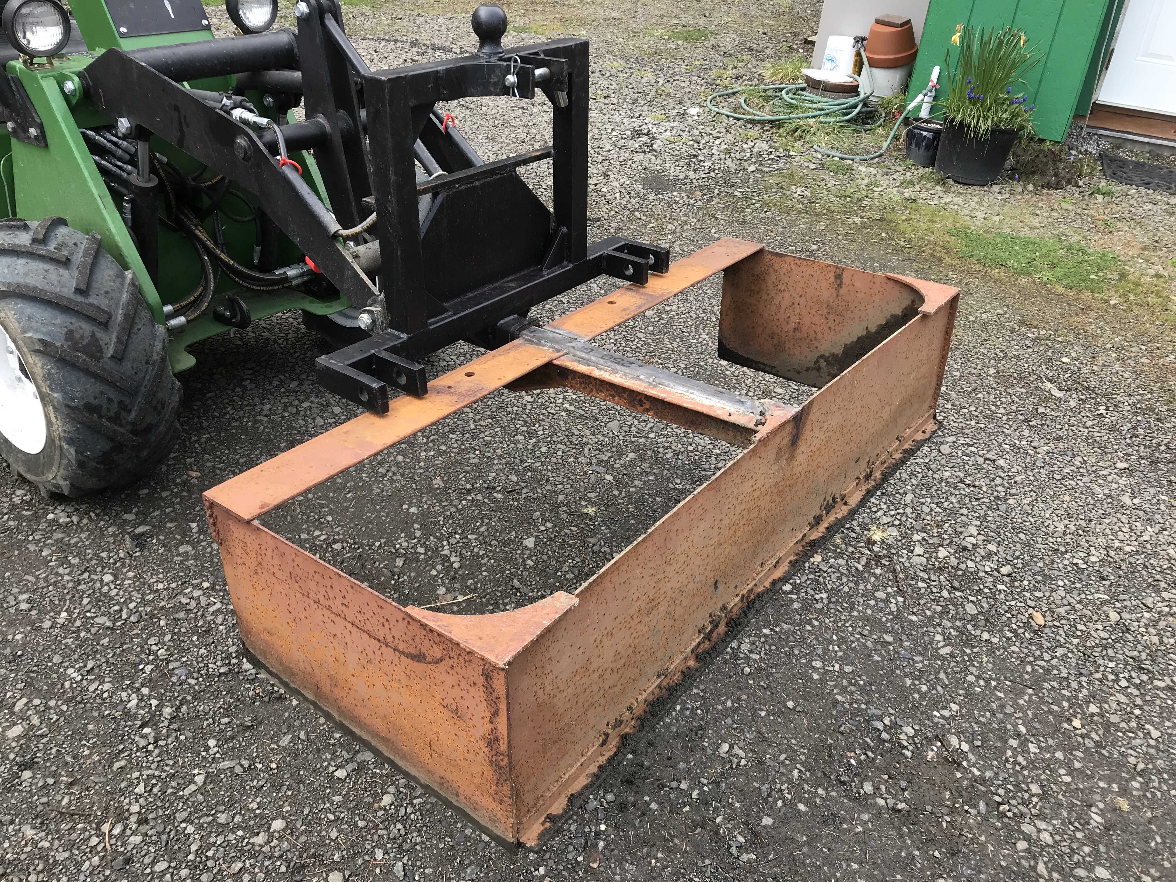

If i welded a hitch tube to it and attached to hitch receiver welded to an attachment plate. Would that be enough to support it and drag when it's shipping weight is listed at 390 pounds? My gut says it would need some lateral support of some kind. I would only use it in reverse. Does anyone have any experience with the power trac box blade? It looks like it weighs about half what this one weighs.

If I were going to be modifying a 3pt implement, like a box blade, I'd look for a used one at a farm equipment dealer, or local sales, first, before buying a new one and hacking on it. An implement like a box blade is usually pretty heavy steel, and not easily damaged. Used, it will most likely be good as new, just minus a pretty paint job.

I would think you would be better off welding some rectangular tube or C-channel with brackets across the 3 pt braces (parallel to the box blade) and then weld an attachment plate to that. I almost always buy this type of stuff used as Moss said. In this case though, it might be hard to find one that small.

The wider they are, the thicker the metal so you have to worry about weight given the leverage of the blade. He is getting close to the limit but should be ok doing what you say if it is only a 5' or possibly 6' blade. I doubt I would want to try a 7 or 8' blade.

I owned a 6' box blade for my old IH2500b. It was HEAVY... there's no way my PT425 could have pulled it with even a small amount of bite in the soil. No way at all. So I'm guessing from experience that even a 5' would be difficult. If I ever were to get a box blade for the PT425, it would be 4' maximum width, with removable scarifier teeth. Just my opinion, of course. ;)

The box scraper I built from scratch is 54" wide. I wanted something a little more than 48" but not as wide as 5 feet. It's not nearly as heavy as a commercial unit but that is an advantage pulling it with my 425. I attach it to my 425 using the 3point hitch that I welded to a spare quick attach plate. I still need to weld some pin holders on my scraper to make it a little more firmly attached.
