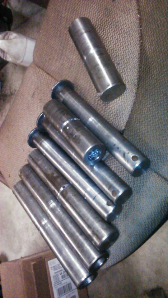

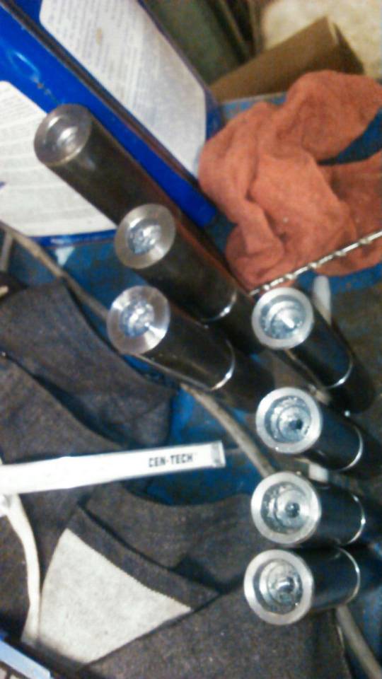

Yup, or search for "spring bushing", that's what I used in a lot of my main pivots. For my pins I made them the "grease through" type but you can have a grease fitting on the sleeve if you have access to put one. 95846621.jpeg1093831166.jpeg
