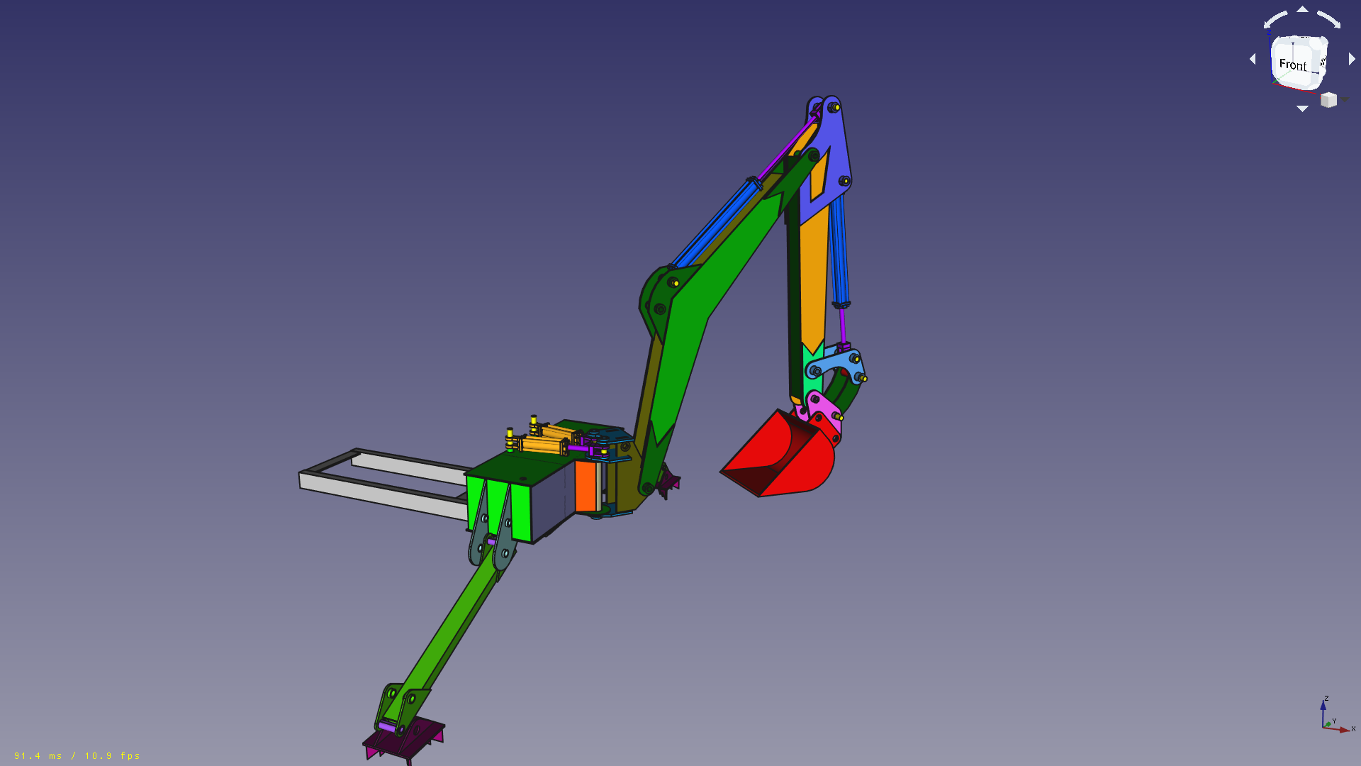

It starts to take shape. I would like to review a few things (yes, the trunnion mount is one of them!! :) :) )though. My main concern is that I have no much experience with heavy equipment and I do not know what is the industry standards.
Can you plz give your input on these things plz?
a) Pin size. Some basic calculations show that 1.25" diameter pins of mild steel are adequate. But I am not engineer so thats maybe completely off. does it sound good to you guys? What size pins do mini excavators have? If that size is at about the limits, maybe I will just buy harder steel, even though I would prefer to replace the pins and not the welded bushings. Mostl likely I will use 3" diameter cylinders on 2200-2500 psi
b) for bushings I am planning to buy 2" OD DOM tube, with 0.375" wall, and weld them, does that sounds good approach to you?
c) Unfortunately I cannot run the Finite Element Analysis. Maybe I have to simplify the model a lot and retry. But from your experience, what thickness should I go for the plates? 1/4" for the main shell, and 1/2" for the laminated ends (where the stresses are higher)?
Thank you guys!
p.s. I am mentioning it again, the model is on the link I gave you before, available to download. All my progress is there.
   / Homemade Backhoe for LS Tractor (XG3140) #37
1.25 pins should be good for most of the pivots, I would step up to 1.5 for the main swing pivots and where the main boom and crowd arm mounts. Would recommend 1144 stressproof or at least 1045. For mine I used DOM with replaceable spring steel bushing or bronze bushing for the major pivots.

Thanks for the info!. Yeah for the king pin I have designed bigger pin, 2" i think.
But How these "replacing spring bushings" work? If the DOM will be 2"OD 1.25" ID, and the pin 1.25", how they fit? I like that idea to go with harder pins and put replaceable sleeve bushings, but I do not know how.
   / Homemade Backhoe for LS Tractor (XG3140) #39
Bushings are 1/8" wall so just make the ID of the DOM .250" larger to compensate. Most of my sleeves are .250" wall DOM, .375 is a good wall thickness.
Do you have a lathe? You're going to need one to get good pin fitment either way using DOM.

Plz let me know if I got it wrong:
Pin: 1144 steel 1.25" dia
Bushing: 1.25" ID 1.5" OD Something like this?
Housing: DOM Tubing 1.5" ID , with wall either 0.25" or .375"
And the DOM will be welded to the holes of the plates, which will be a little bigger as the plasma does not cut exactly precise.
If thats the case then grease has to come through the pin? Make 2 crossed holes?
