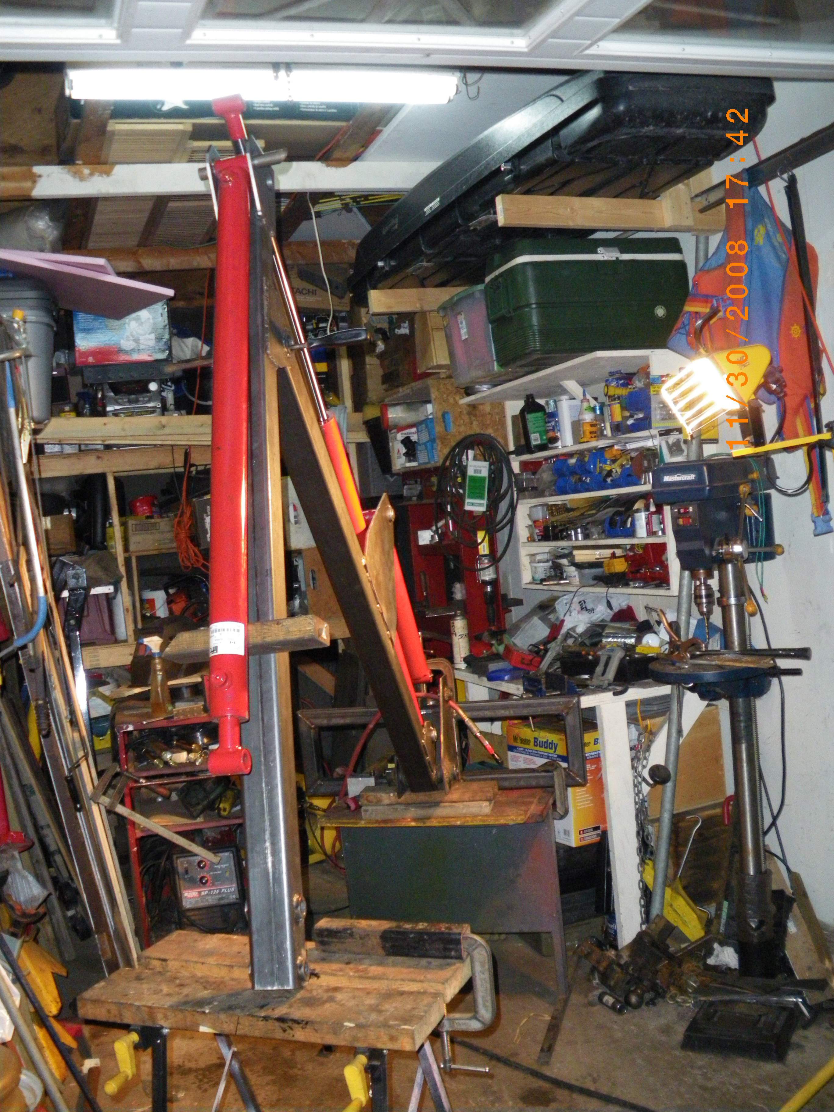

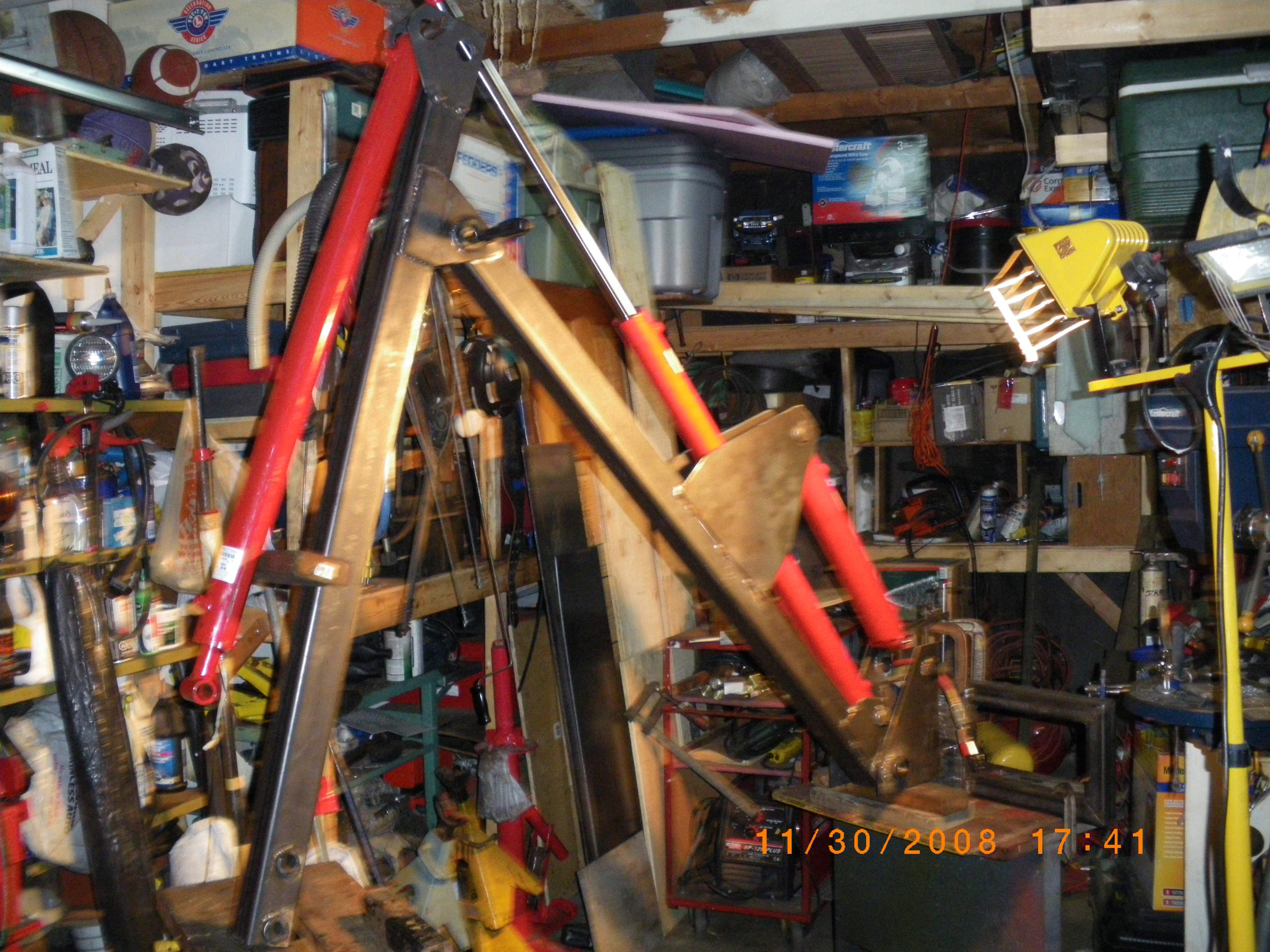

I have a couple hundred hours into my backhoe project so figured it was time to start a thread on it. I had originally started collecting cylinders to build a FEL for my Massey 135. Since I already had a FEL on my subcompact Kubota I got to thinking a backhoe might be more useful, especially with digging up the stumps that currently determine the path of my roadway. Here is a short video on the action of my bucket mechanism and some of the other pieces. Since I am building the unit around some FEL cylinders I have resorted to some unusual design enhancements. The plan is to bolt it to the rear end of the massey which is pretty heavy cast unit and the backhoe will likely be 4-500lbs.

Lookin' good, Dave! The crowd arm cylinder and bucket cylinder don't touch? I bet it's close!

Some of the clearances are close but I have tested the main boom to dipper arm cylinder clearance with a 90 degree hose and I have about 1/4 inch to spare which will give me a 7 foot digging depth. Hoping I don't have to move up to a 3" cylinder for the main boom from the 2.5 inch.

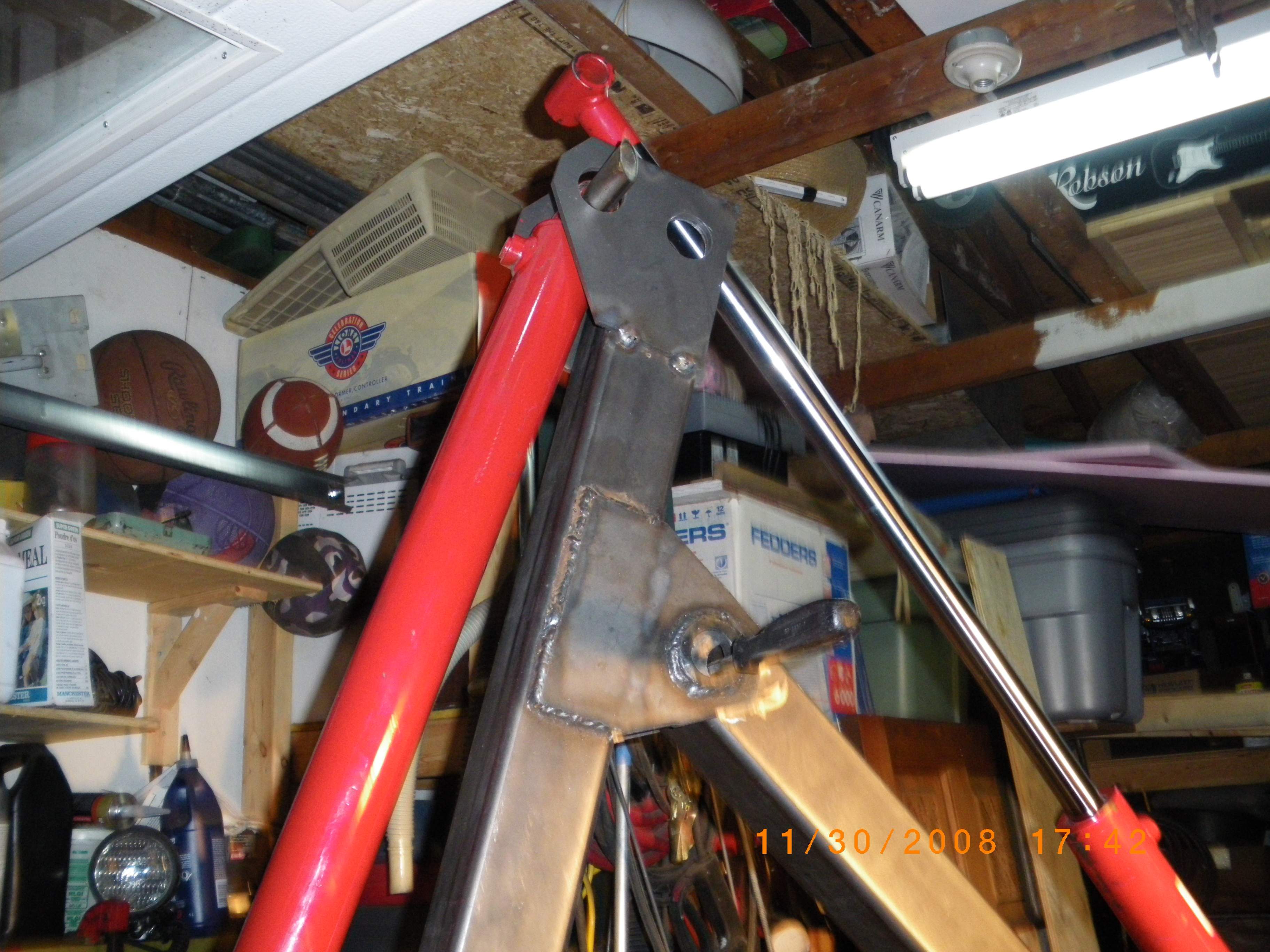

I don't know much about backhoe design. But my first thought was how it appears a bit different from most BHs and recalled how even on factory one people sometimes bend that cylinder. The factory BH's tend to have some sort of moving bracket that I think tends to help keep the cylinder in line, I'm speculating that perhaps the purpose is to reduce potential bending stresses on the cylinder. It that something you had considered?

I have studied a lot of different backhoe designs and can't think of any moving bracket. The only real difference mine will have is that the dipper cylinder and bucket cylinders will only be using about 24" of their 36" stroke. Some day when I am in need of the long cylinders I will weld in brackets for some 24" stroke cylinders. For now the dipper cylinder will run underneath the main boom cylinder. The bucket cylinder to bucket brackets (will have to learn the proper names) will be H braced. The main boom is 1 1/4 pins, all other pins are 1" which is what the cylinder ends require. I surely don't have much room with just a 10x 20 garage that is full. I have a 10x10 heated shed that contains the lathe and band saw. So far I have not burned the house down, touch wood.

I was referring to a bracket such as the one in this picture. I don't know the purpose of it. But, I speculate that it provides a means to keep the forces more straight with the piston as the angle of the piston doesn't move much throughout the motion range. I see in your video that the piston moves from parallel to about a 30 deg angle through out the piston range and it does not have such a bracket.

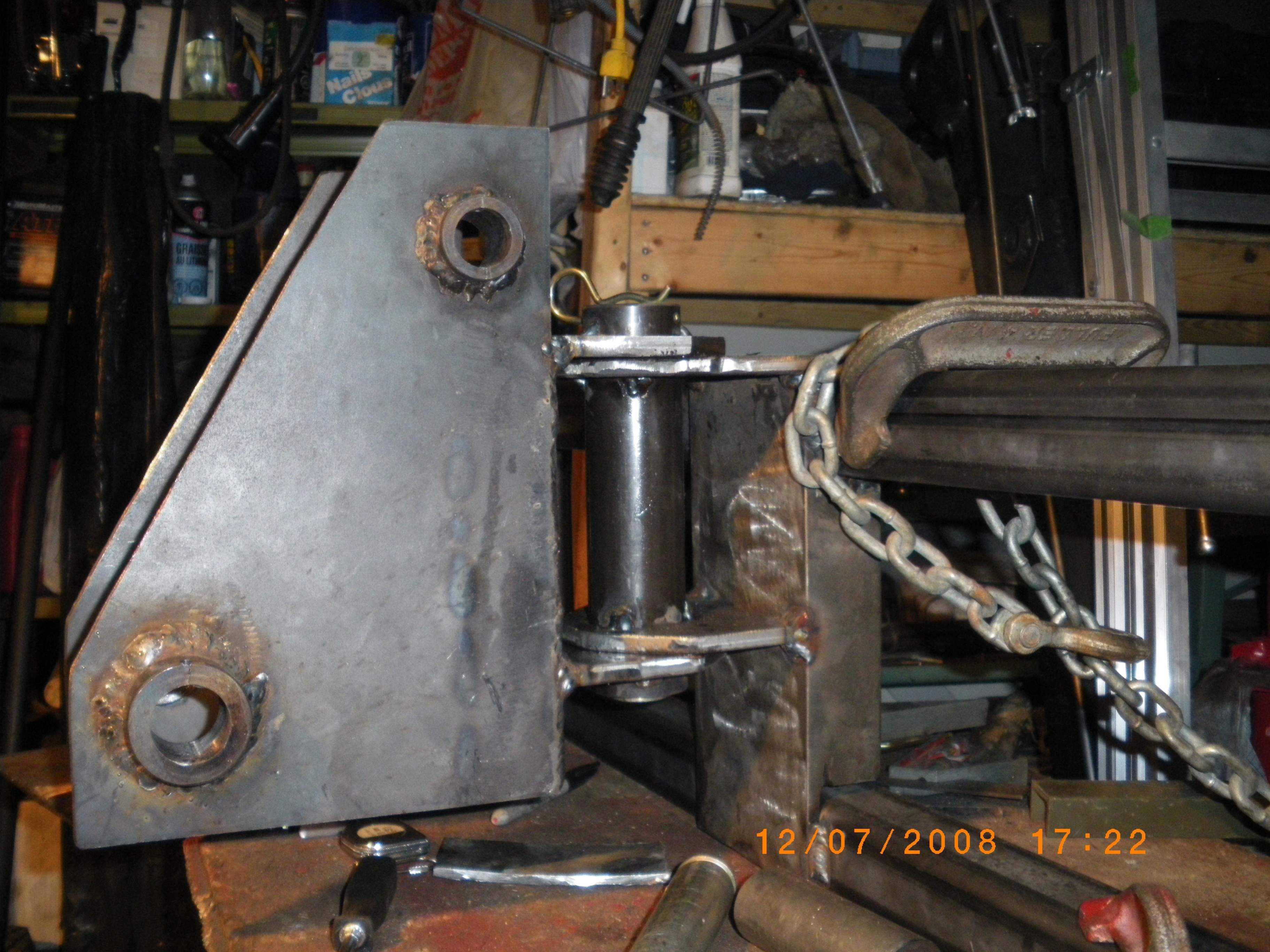

Mine has that bracket, only instead of being arc shaped, mine is L shaped. It is made 1/2 inch thick and I will be adding an H brace to stabilize it. As well commercal backhoes have like 5,000 PSI and large cylinders so they don't need extra leverage. This piece is to allow the bucket to curl without having a large bracket produding off the back of the bucket. (I think :)) Since I have so much stroke available, I made this lever longer then normal to make extra dipper power. Its potentially an expensive mistake if the backhoe does not work but its keeping me out of trouble this winter.

We use an arm like that on our commercial payloaders for years: as you said it gives extra power where most needed, in other words, gives a constant curl torque over the full bucket motion. If you use bigger cylinders, you will have power where you dont need it (speed loss) when the cylinder is also capable to generate the bucket torque in the less favourable positions of the cylinder vs. hinge points.
Designing mechanisms like this, is allways a lot of fiddling with the geometry if you want to lay out the torque in the curl positions where needed, without slowing the speed so much where torque isnt needed.

These links are part of the four bar linkage that allows the bucket to rotate more than it would if the cylinder rod was attached directly to the bucket. A bucket with links can rotate 180 degrees and have more power as the cylinder reaches full extend or retract.
