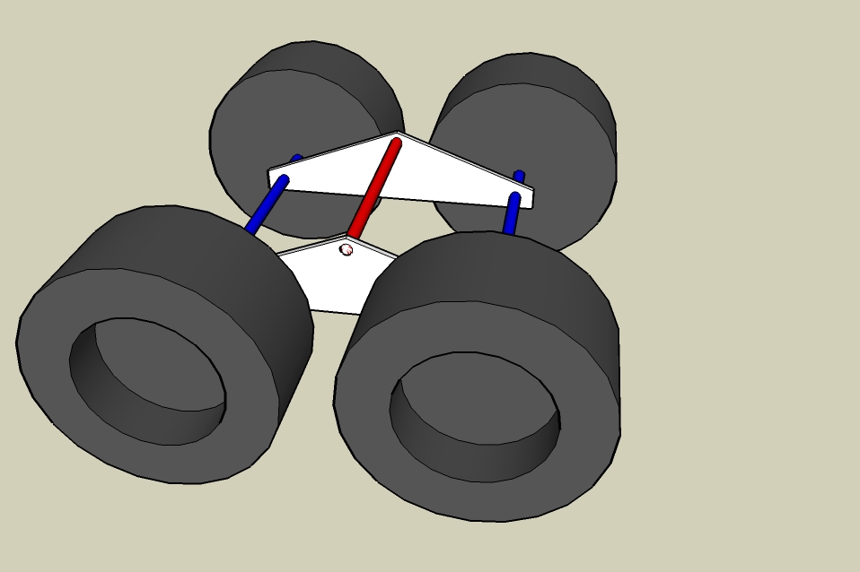

iplayfarmer- I am still debating between your advice and my preferred way to take apart the axels. The reason I am debating it is I prefer to have the axels as close to 4 ft wide as possible for stablity. The ones I have are more close to 38 inches I think. The other issue is getting enough angle iron cheap. The only thing I have is the small bed frame ones. I think Ill have to visit the local scrap yard and see if they can let me poke around for something. 5 years ago, I saw a old wave runner trailer and I really wished I grabbed that one to modify!:(
Anyway , I have been thinking on how am I gonna attach the first axle that closest to the tongue. I have envisioning that due to how well my father old dump cart is made, the cart body was attached to a triangle metal directly to the axels. This allowed for a higher dump and ease. I was figuring if I had a decent sized I beam for tongue and the rear axle connected the way I was thinking. This presents a problem with the front axle- either connect it to tongue axel solidly or use equalizer trailer parts. If front axel is solid and I go over a dip, the weight would be all on the rear. Keep in mind, It doesnt have to dump, but it would be nice If the feature wass there so in the future if the funds is right, I'll add hydralics for it with minimal modifications.

Why not make the two axles into a "walking tandem" ??
Make two triangles; each bottom corner of a triangle gets connected to an axle, one triangle on left, one on right; the top corners of the triangles connect to the frame of the trailer and must pivot.
Regardless of terrain, with a walking tandem, all wheels remain in contact with the ground.:cool:
My experience has been spot on with what BearKiller said...
BearKiller said:
...due to neglect and people being stingy with the anti-sieze, once a mower wheel has been on there for a few months, it will be siezed up and rust-welded solid, and nearly impossible to get off.
Your mileage may vary, but I predict you'll have a very hard time getting the wheels apart from the axles. If you decide to go wider, my advice would be to scrounge a trailer to modify or poach rear hubs off of a front wheel drive car. GM hubs are nice because they come off flat on the back lend themselves well to DIY projects such as this.
As for attaching your axles, you might consider putting the two axles on a walking beam with a pivot in the middle of the beam. I attached a sketch of the setup. The blue rods are the axles. The red rod is connected to a single pivot point on each side of the trailer frame. Then the axles can flex and adjust to the terrain, etc. You'll have to work around it when you're adjusting your dump angle, but that's entirely possible.
For nearly all trailers, the optimum setup is for the midpoint of the wheels to be 60% back from the front of the trailer. For a two axle, 10' trailer this means putting the midpoint between the two wheels 6' from the front of the trailer.
