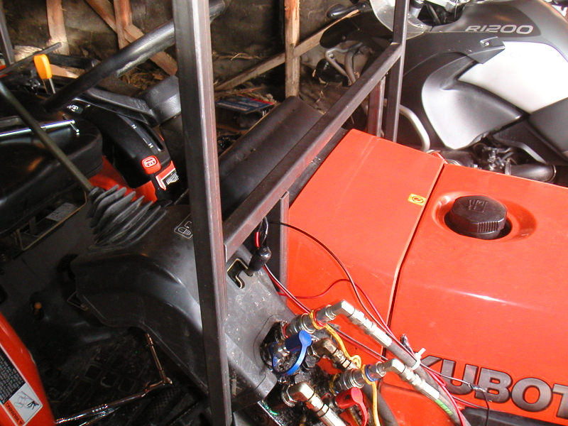

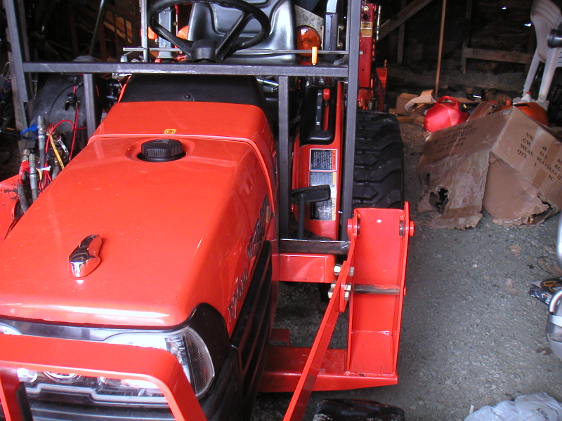

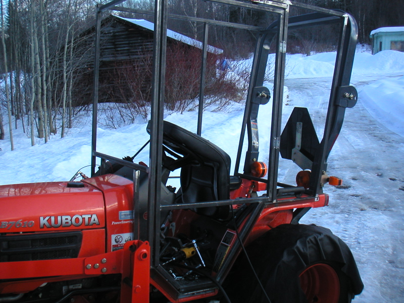

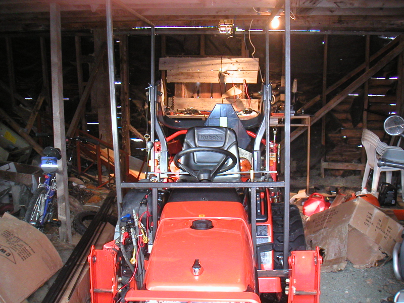

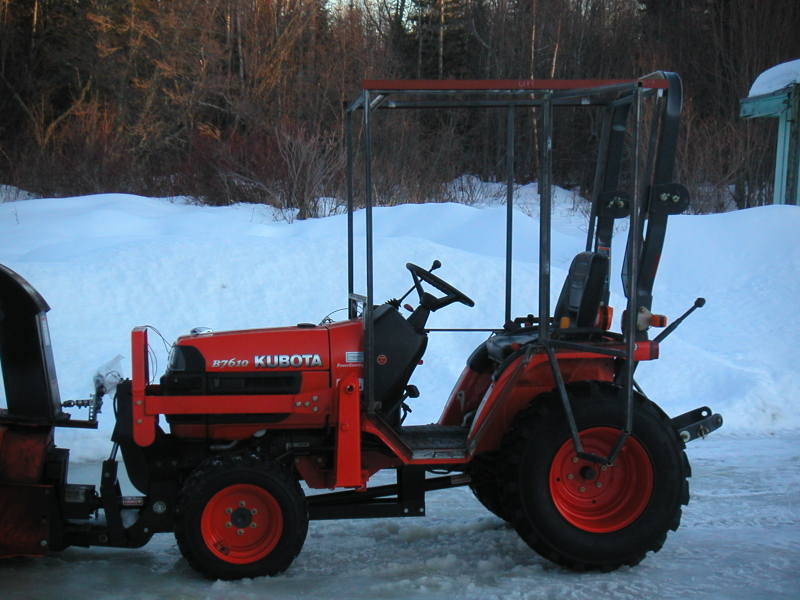

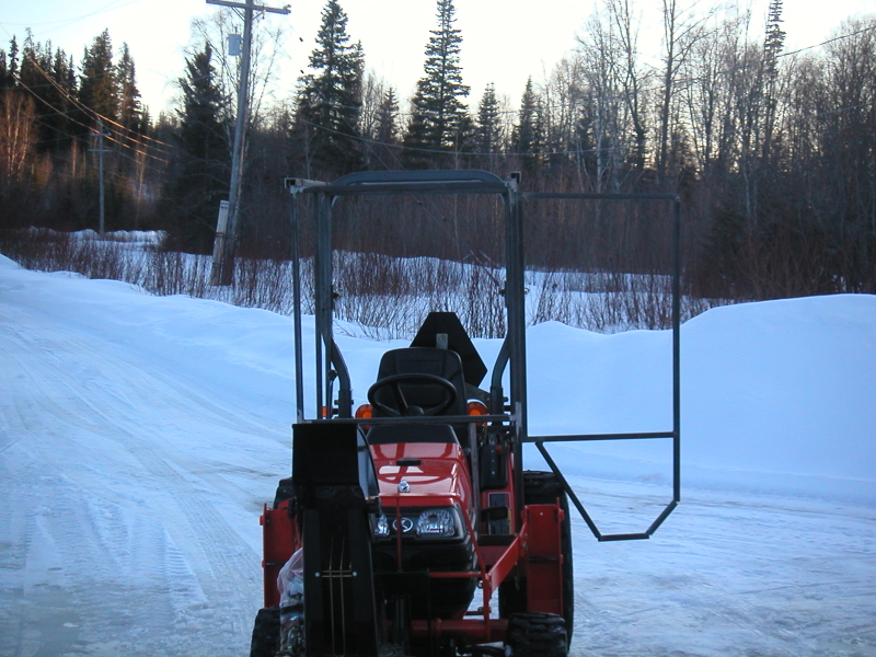

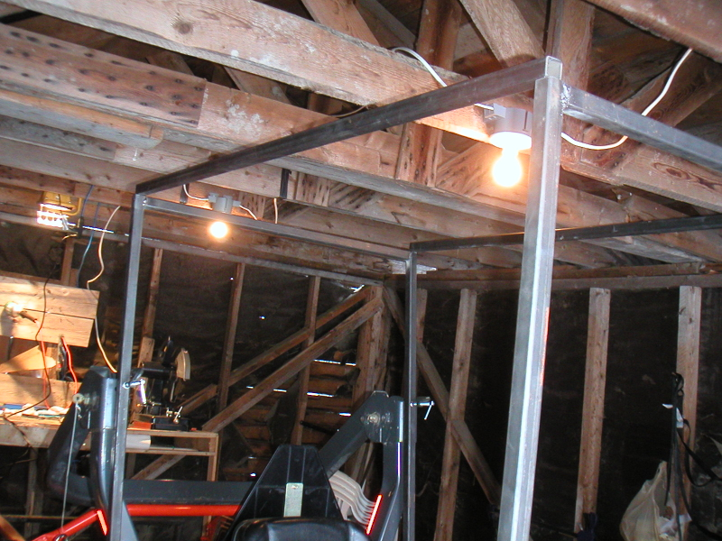

I have a Kubota B7610 with a front mounted snowblower. I got tired of getting covered with snow as the wind swirled around the trees. This motivated me to build my own cab.
It is built out of 1" square steel tubing and 1.5" angle iron. The roof is 16 gauge sheet metal. The windows are going to be 1/8" lexan.
I welded the 1" tubing together for the frame and attached the roof(1.5" angle iron with the sheet metal welded to it) to the frame with bolts.

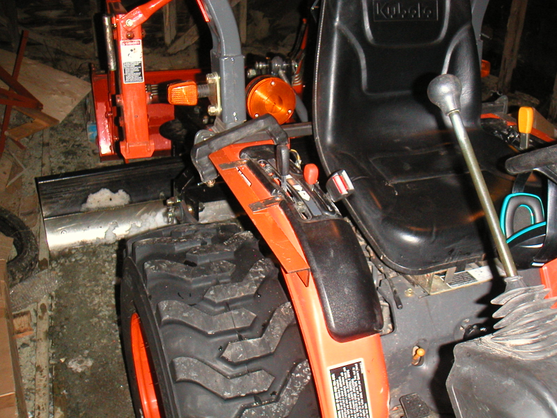

The whole cab assembly is attached to the tractor with bolts for easier removal during the summer. I have a door attached to the left side of the tractor. Door is constructed from 1" tubing as well. I just used two normal door hinges to attach it.
/ Home Made Cab
#2
Here are the pictures

Very nice job. I made a cab several years ago for a Ford 1310 then retrofitted it to fit my B7510. Probably should have started over but after a while I got it to work. It had just a left door on the Ford but added a right door for the "bota because I always thought I wanted a door on that side and I am glad I did.the first cab was 3/4 tube and Aluminum skin with windows from the junk yard. The reinvention was same tube and windows but skinned it with dark Plexi glass. Mine is removable in five pieces and two doors.
Keep up the good work can't wait to see the finished product.

nice looking cab, not much clearance from the rafters, keep up the good work!

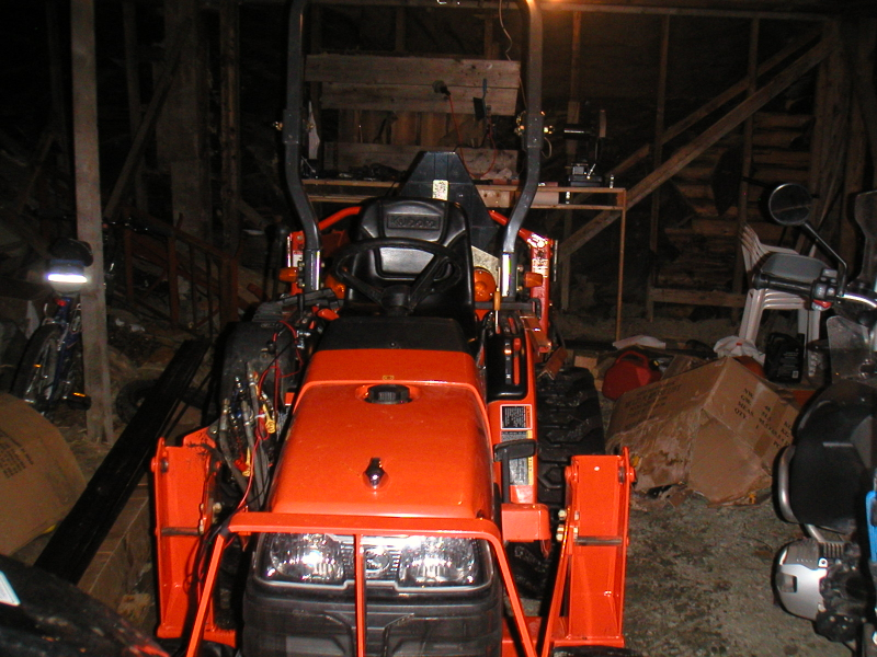

The last few days I have been working at putting the lexan windows on my new cab. I got some lights for free from my father, but they didn't work very good so I bought a couple cheap floodlights from princess auto. I'll test them out tonight.
I bought some rubber matting today and made a panel to attach to the back of my cab and under the toolbox too seal up under the seat.
I got a heater with a fan on it for free and have to figure out how to mount that.
I still have to paint my cab but that will have to wait until it gets much warmer out.
