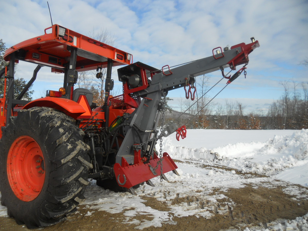

Thought I'd bump this to get some fresh projects added.
I posted the begining stages of this one a year ago on this thread. (and propably a few other times):laughing:
Kinda proud of this one.

You should be very proud!!! That is a very beautiful & functional machine!

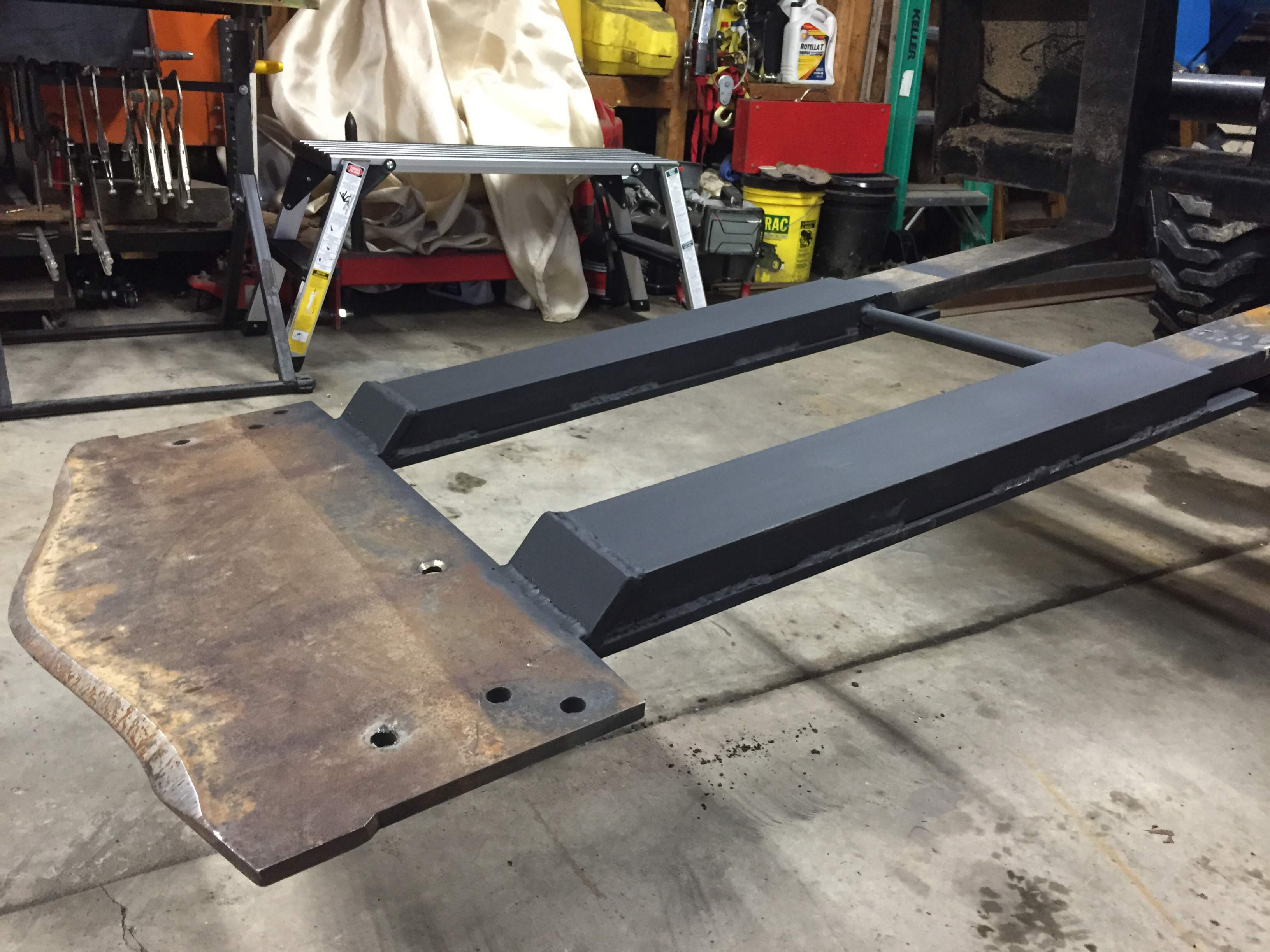

A quick little spade/shovel attachment I made with some scrap for my forks;

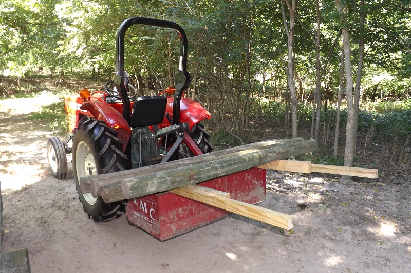

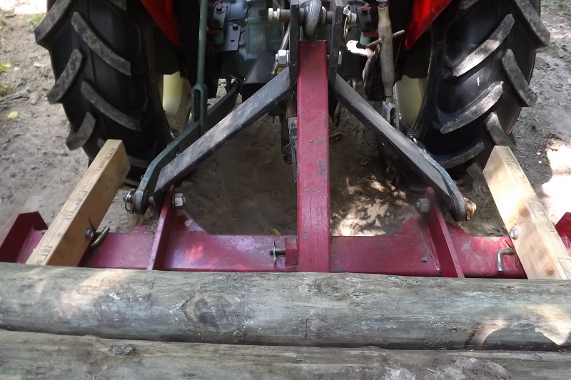

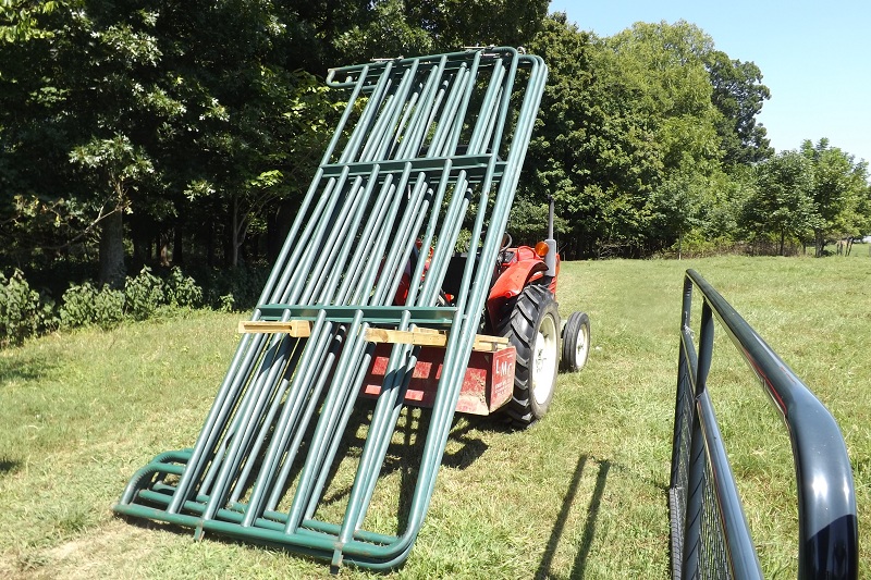

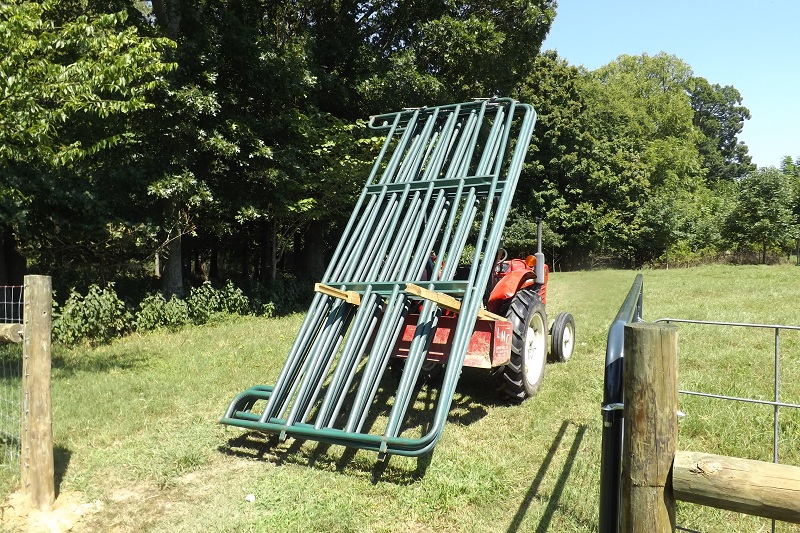

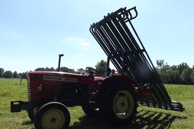

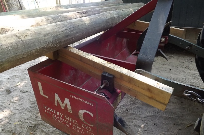

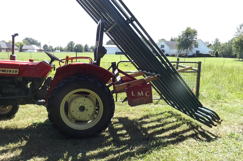

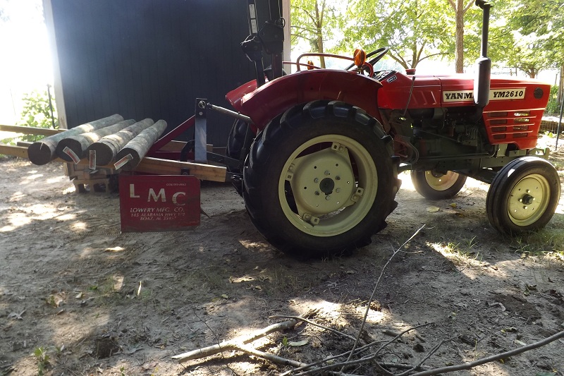

I'm poor, but not without rich ideas. I turned my box-blade into a BIG carry all tool.

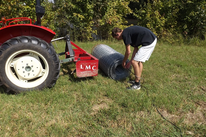

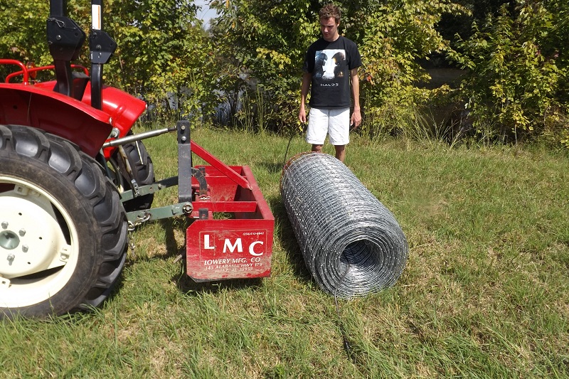

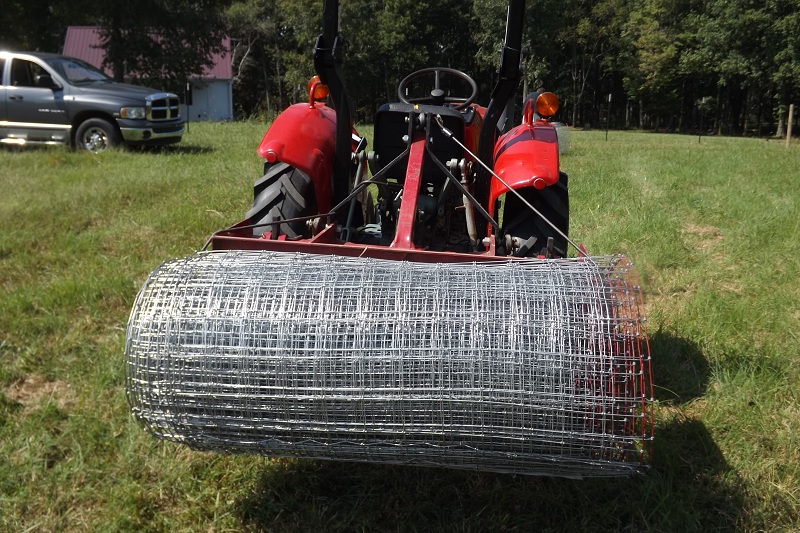

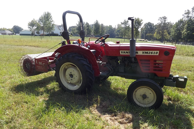

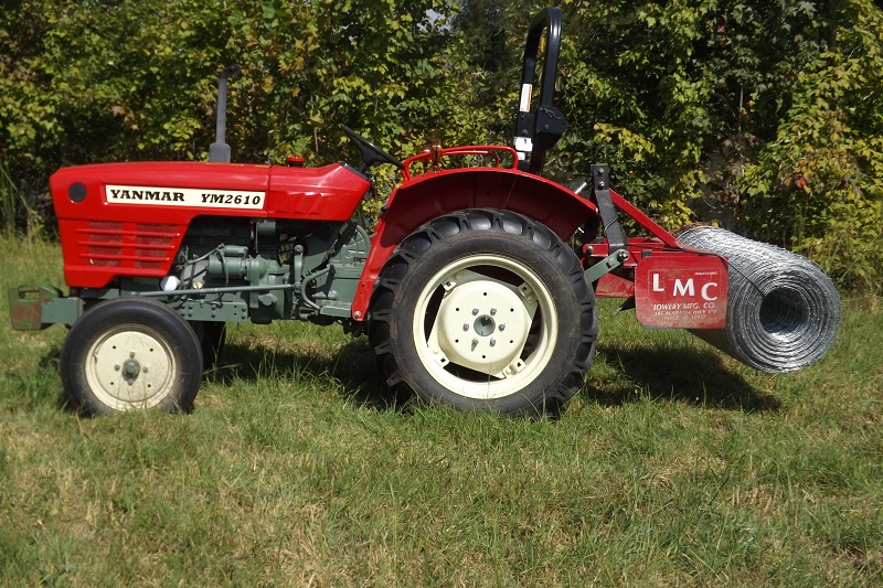

Well, this isn't so much of an attachment, but how to use one in a totally different way.
Again, I used my box-blade for this easy feat. How to lift a 261-lbs 330-foot horse fence roll without breaking your back while moving it across the pasture.
Well, the pix uploader put the order in backwards. Take two joined coated 6-foot cables, feed it through the fence bundle as shown, and clip it onto the box-blade. Jump on the tractor, raise the lift and away you go.
I am trying to see how you anchored the 2x4's to the box blade but cant determine. Next to last picture appears to show bolt going through ripper into 2x4. Is that correct?
