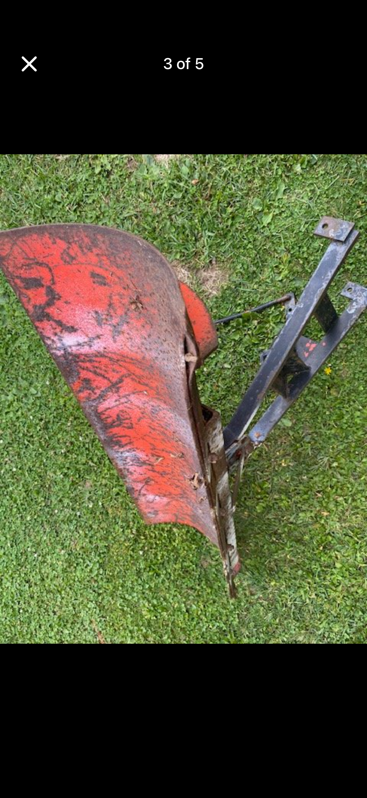

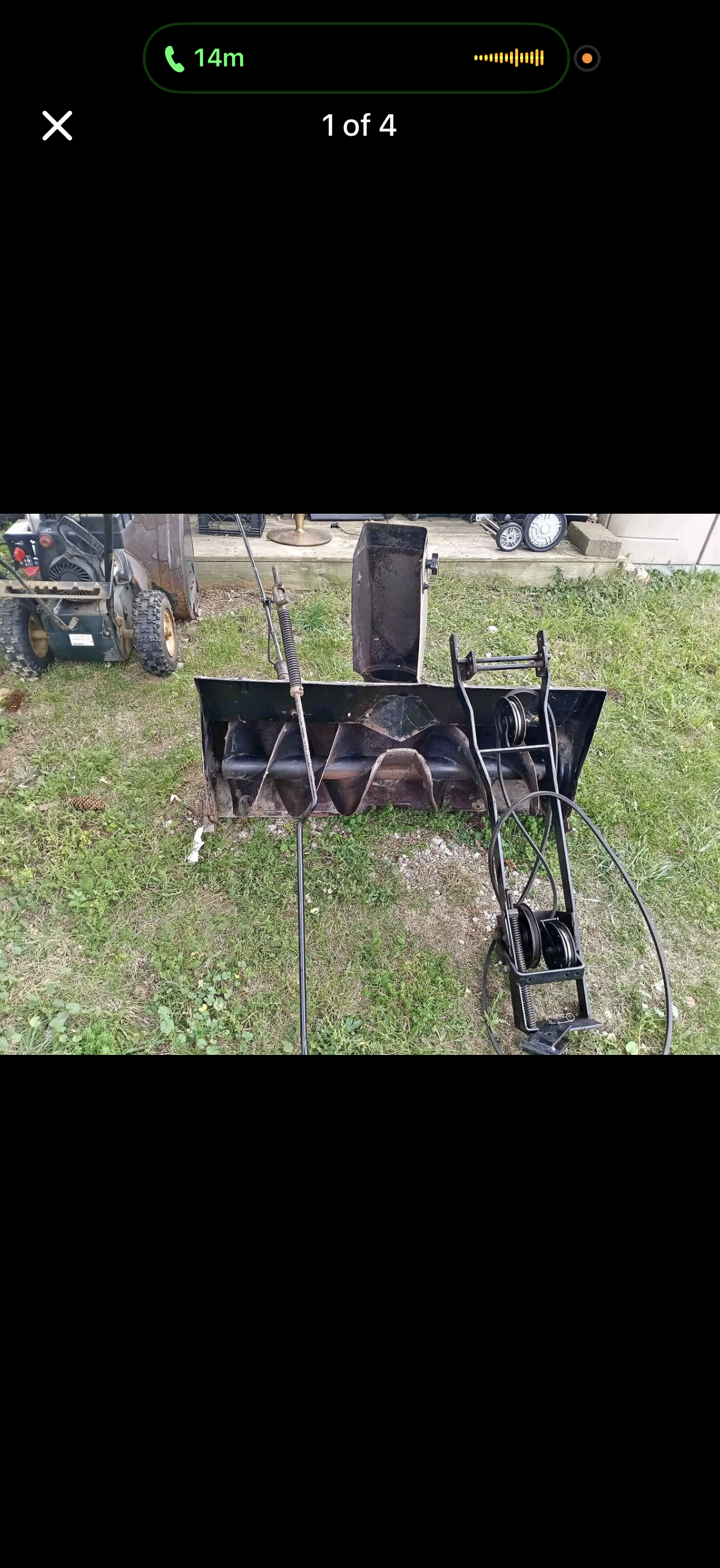

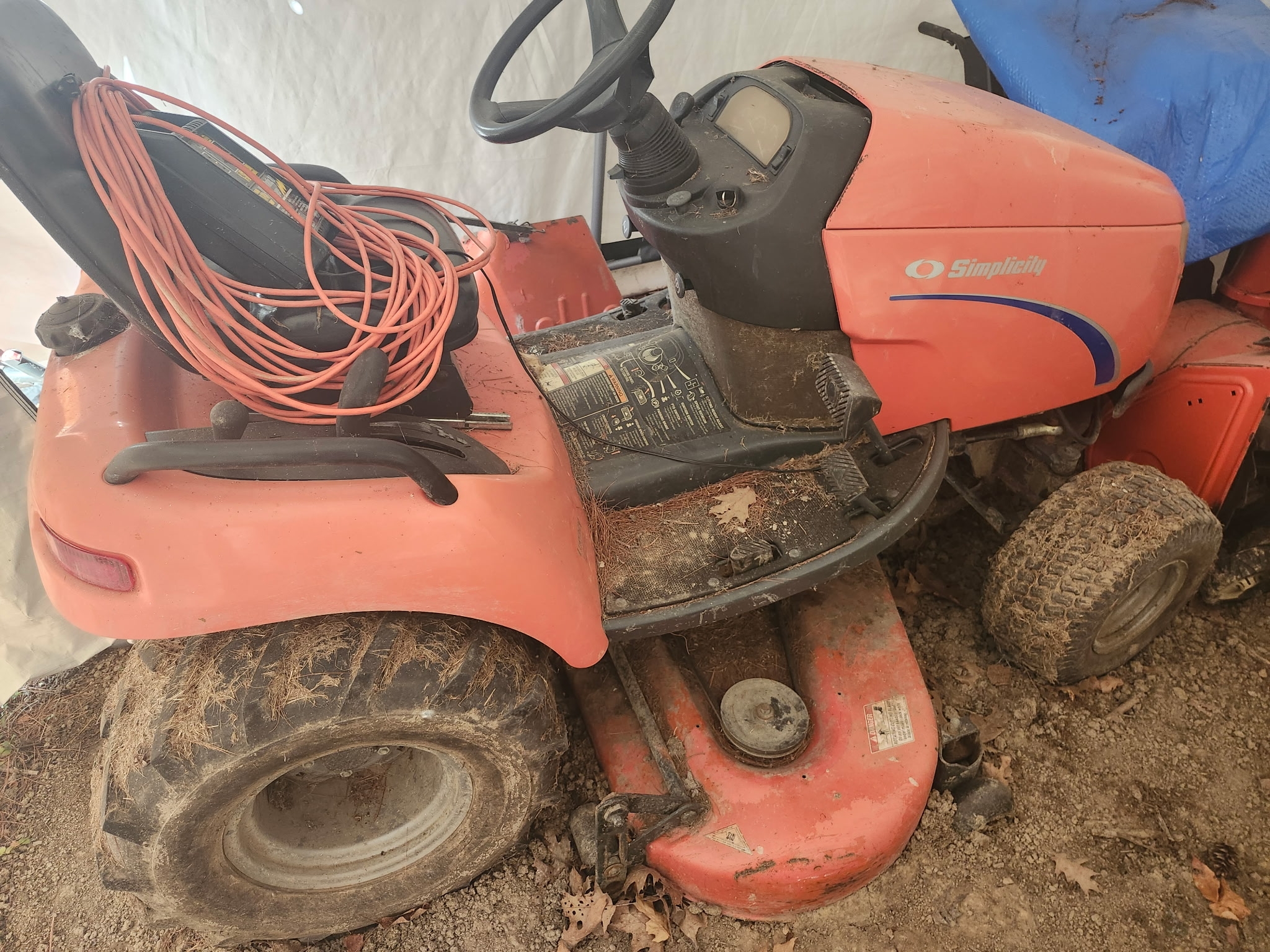

Just got a 25 hp Simplicity legacy given to me by my uncle. The thing is a beast, but I’m wondering what would be the best attachments to get? Looking to snag a single stage 42” snowblower, 42” plow and a 24” tow behind roller this week. Are there any specific attachments you recommend? I will be using this for projects around the home and would like to start a small business if possible.

IMO, If you want this to last any amount of time, stick with what it was meant to do - mow grass
& what makes you say that? Wouldn’t make sense to have the attachments available if it wasn’t made for it. I could see with a lower end model, but this is one of the more powerful gas mowers Simplicity offered from my understanding.

Make sure that blower and blade will fit, it appears the blower in the picture is belt driven, the Legacy uses a shaft driven blower.
The front blade appears to be for a different model, the blade for the Legacy uses a different mount type and a subframe.
The Legacy is a stout machine that is very capable, I have the previous version of it, the Sunstar, there are some differences but a lot of the structure is the same.
I have a 2stage blower on mine, it'll move some snow!

These were offered in multiple configurations, including diesel and 4wd.
They offered a factory loader and backhoe for them, usually manufacturers won't do that due to warranty if it's not able to handle it.
That machine is on par build quality with many scuts and very capable, not to be confused with the similar looking models that are pretty much just mowers.

Don't think you really want or will find single stage snowblower. Two stage is preferable. If that model uses PTO for snowblower, I consider that a plus, as mine for my Kubota is PTO as well. Have had belt driven and IME was a nightmare.

Do you have any idea what I should be looking for in terms of parts that fit? I can’t seem to find any guide online that gives a clear understanding of what accessories fit this machine.

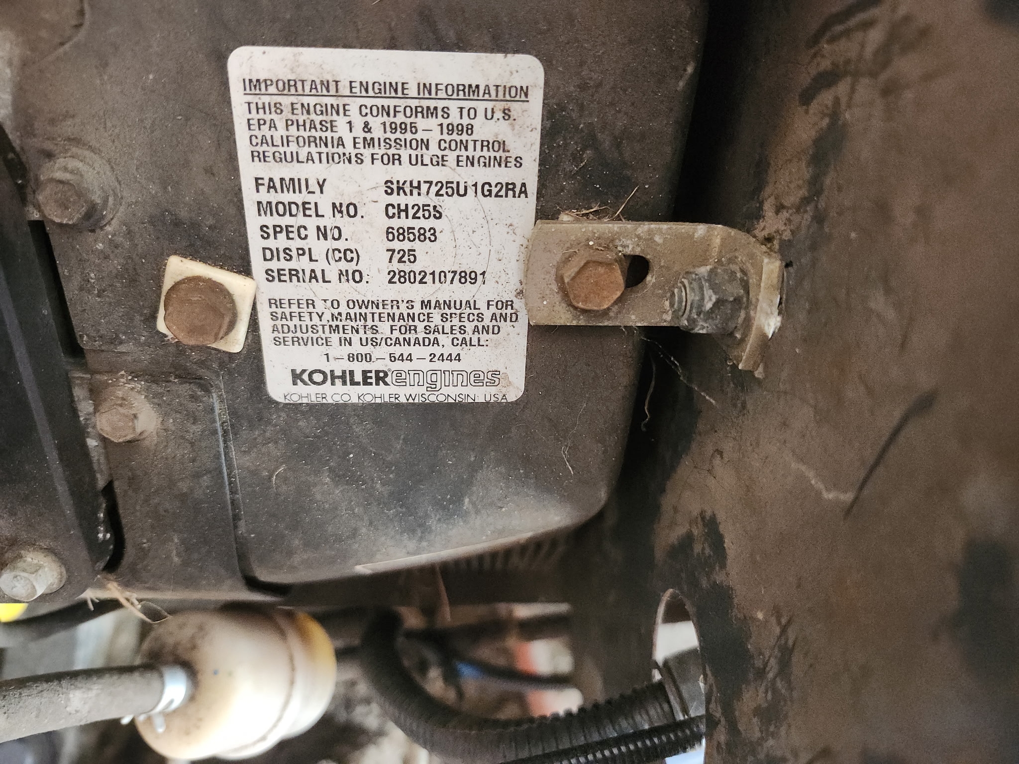

Be sure to record those engine numbers somewhere safe. Some day, some how, they'll get rubbed off or damaged.
I have a CH25 in my machine. Very similar. It's 25 years old with about a thousand hours. I like it.
