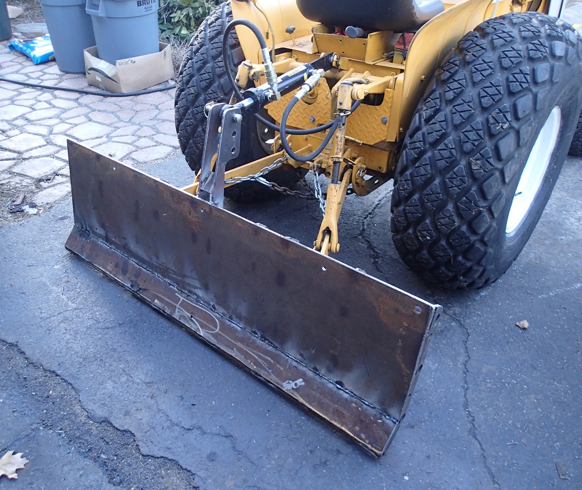

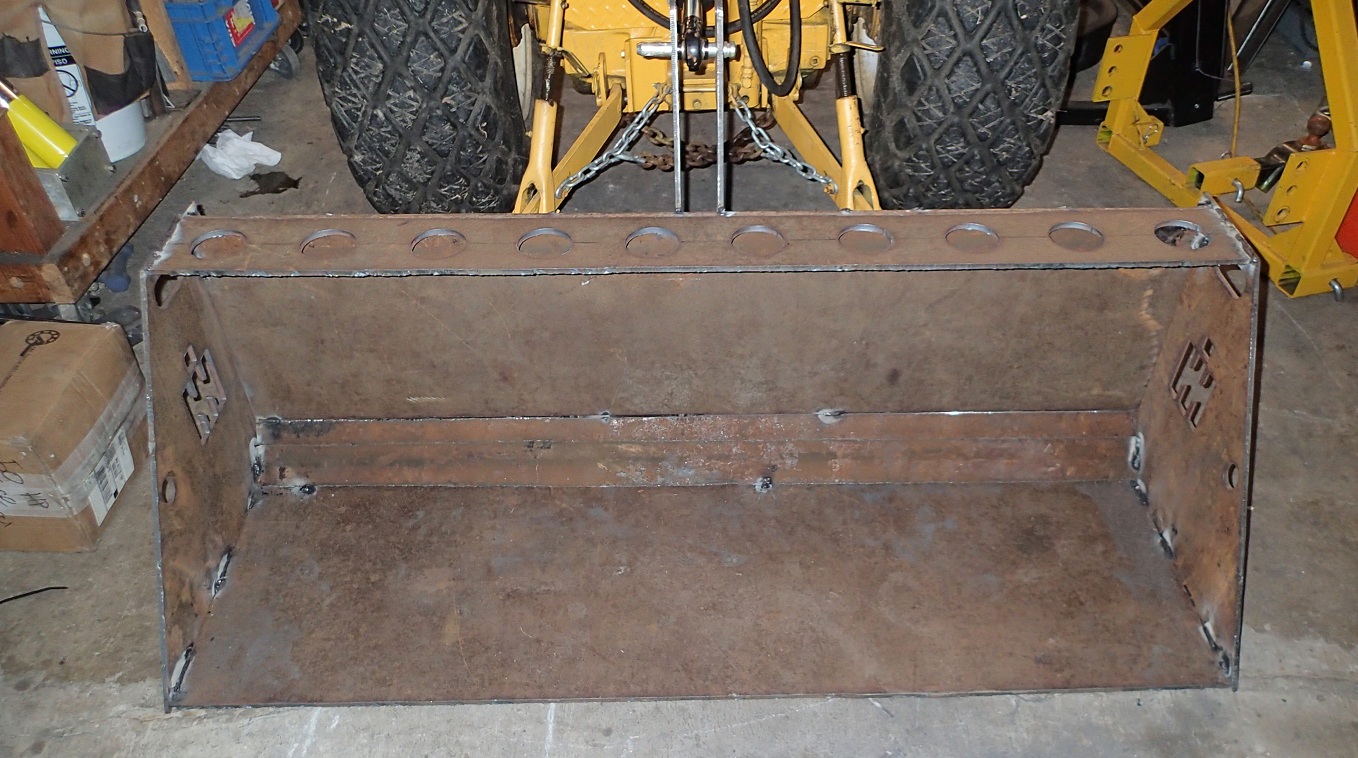

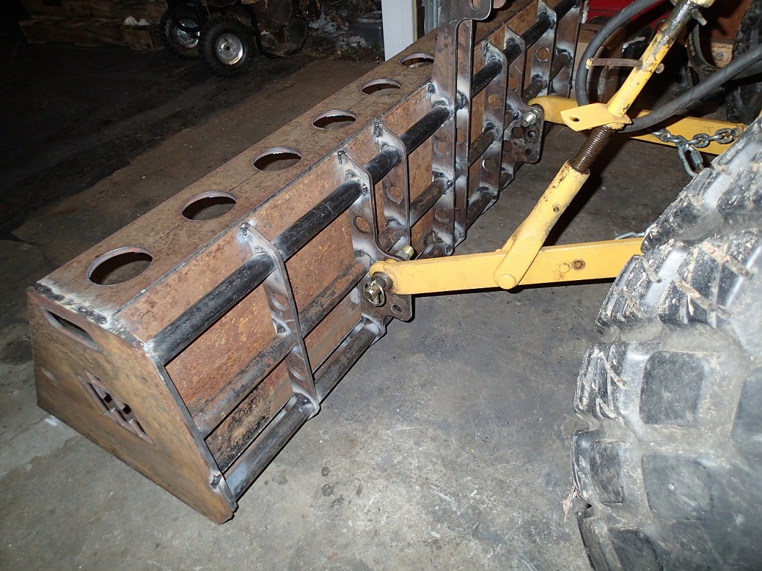

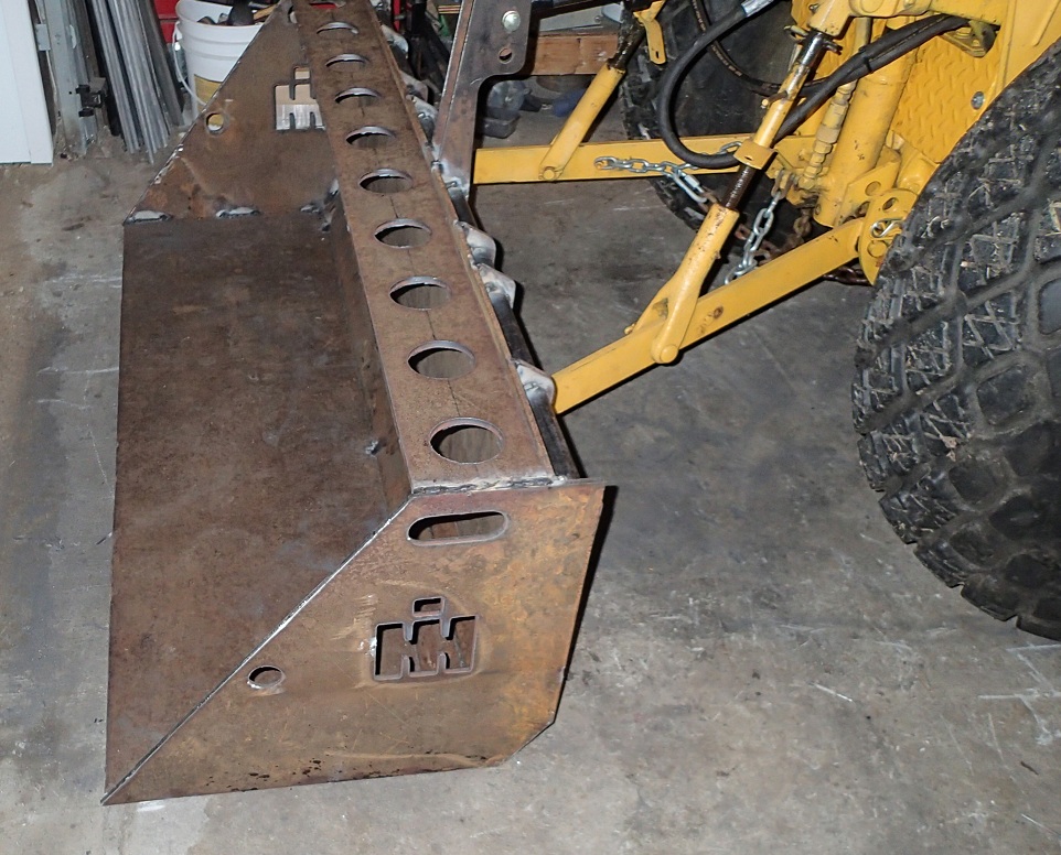

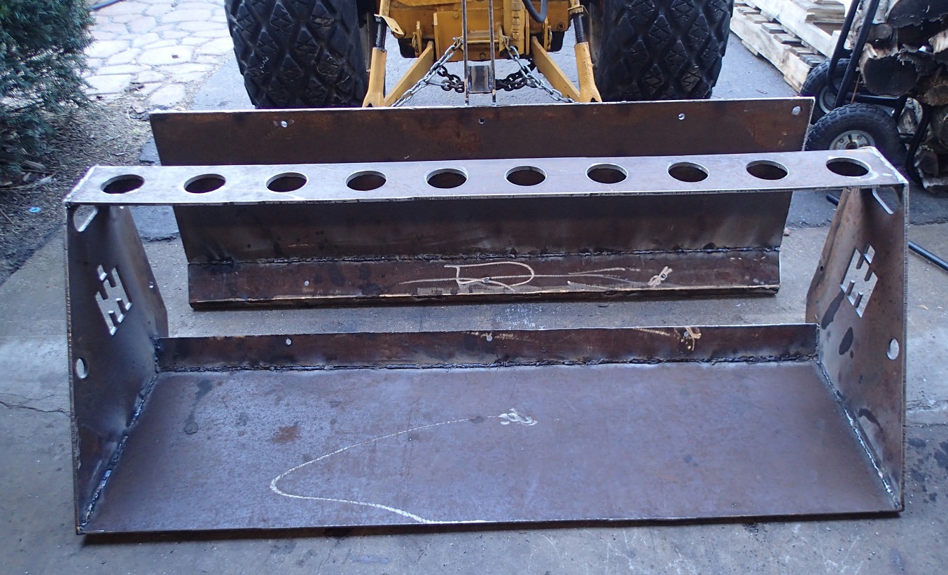

If you couldn't tell from the multi-hitch design I like attachments that have more then one purpose. My next project is the plow/bucket. Bolt the bucket section to the backing plate and it'll lift 350 lbs of whatever you can throw in it. Replace the bucket with a cutting edge and it'll be ready to do battle the worst New England winters.
It was assembled and put to work last week to help my father-in-law fill in an old pool foundation. I plan on cleaning the edges and painting it when it gets back to the shop.
The original design called for 1/4" plate, but my supplier said he's sell me a 5' x 8' piece of 5/16" for the price of 4' x 8' 1/4" if I'd take it with a little rust... So I did.;) Only downfall is she's a little bit heavier then expected. Tipping the scales at 300 lbs empty I had to do everything I could to cut weight, which is why I CNC plasma cut the chain holes, hand openings and IH logo into the bucket.

Would I be right to guess that your hyd top link will extend far enough to dump the bucket?

CDN Farm Boy: Depending on material and pin setup the bucket dumps 75%. I would be nice to have full dump, but I'd loose most of the curl with the current cylinder. I've found a few nudges with a flat shovel help the remaining material out of the bucket.

I must be missing something! What keeps the plow attached to the bucket?
Or is it welded as one.
