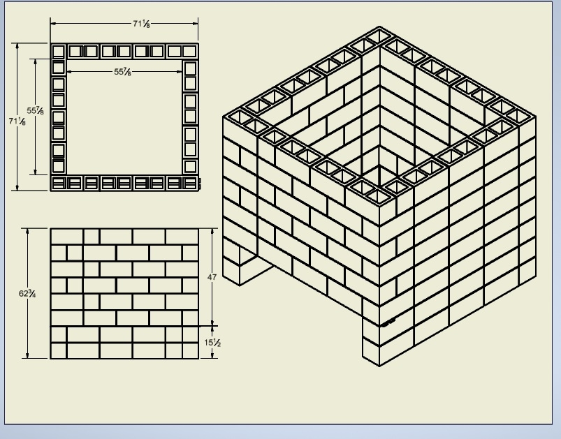

/ Home incinerator project #29
My Dad made one in the 1950s, my drawing is terrible but the idea. He poured concrete first about 5ft x 6ft. Cinder block & morter up about 4ft, then "chimney" in back. Overall about 6 to 7 ft tall. At chimney top a cinder block sideways with tin a few inches up to keep rain out.
The bottom front 1/4" steel plate about 18"×30", hinged to open for air & to clean out ashes.
Top similar steel plate slides across for opening, spring handle on it. It's all made out of scrap junk. 70+ years old still used today.
/ Home incinerator project #31
Burning anything in typical cinder or concrete blocks will destroy the blocks very quickly.
The burn area has to be lined with fire brick.
(Blocks disintegrate because they are full of moisture, water is what cures the cement holding the block together)
Even with fire brick lining, too much heat from a high energy fire will still crack the blocks that are holding the firebrick in place.
My BIL tried for years to have a burner for their beach pavilion.
He must have rebuilt a half dozen times in a decade.
No matter how it was built, after a year or so, the block would crack.
He finally gave up, and bought a propane grill for use at the beach.
Steel is the best answer to building a trash burner.

I'll take pictures of Dad's (rip)...70 years and still going strong
