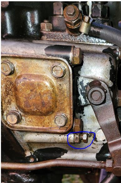

Ha - Too late for that. I haven't blown up the engine, but I did turn what looks like a throttle stop - see picture. I was able to get the throttle up to about 2600 rpms. Not sure if I messed something up or if I have other issues. The engine lost power and died. It will start back up but will not stay running now. I'm done for the day. I'll check it in the morning when it's cold.
I'll see if I can order an inexpensive laser tach from amazon or perhaps Harbor Freight.
/ YM220 Project - Will not start
It doesn't look like it took my picture. Let's try again.
/ YM220 Project - Will not start #11
2600 on a 3 cyl.!!?? I woulda laid down and died too.. lol
#12
That engine is rated for 22 HP at 2600 RPMs. I would expect at least 2900 without any issues.
/ YM220 Project - Will not start #13
That’s w new valve springs..
I wouldn’t push it past 2800.,
But is your machine..
Make sure the decomposition lever isn’t interfering and floating the valves..(if equipped)

Yes, once I realized the gaskets were copper washers. I replaced them and the orings. I hear your concerns on the age and overall condition of the engine. I adjusted what I think is the high idle... I found it very interesting that the wire locks had been removed. Obviously it had been adjusted at some point before.
The decompression lever wasn't making contact when rotating the engine over manually. I'm not sure how to check while running. I'll have to go back under the valve cover to adjust the valves. I didn't adjust previously as I wanted to minimize making changes and adjustments until I had it running. The valve lash seemed excessive to me. However, I didn't break out the feeler gauge and measure it.
#16
I've had a little more time to tinker with the tractor. It holds high speed very well. I ran it about 20 minutes between 1500 and 2600 RPMs with most of that time at 1500.
It doesn't like to hold the low idle very well -- Say around 500 RPMs. If I'm not careful it will die. Does anyone know what the low idle should be for a Yanmar YM220? There's a lot of slop in the throttle linkage so it might just need adjusting. I'll have to look at the Parts manual to see if there are bushings or other wear items missing that need to be replaced.
