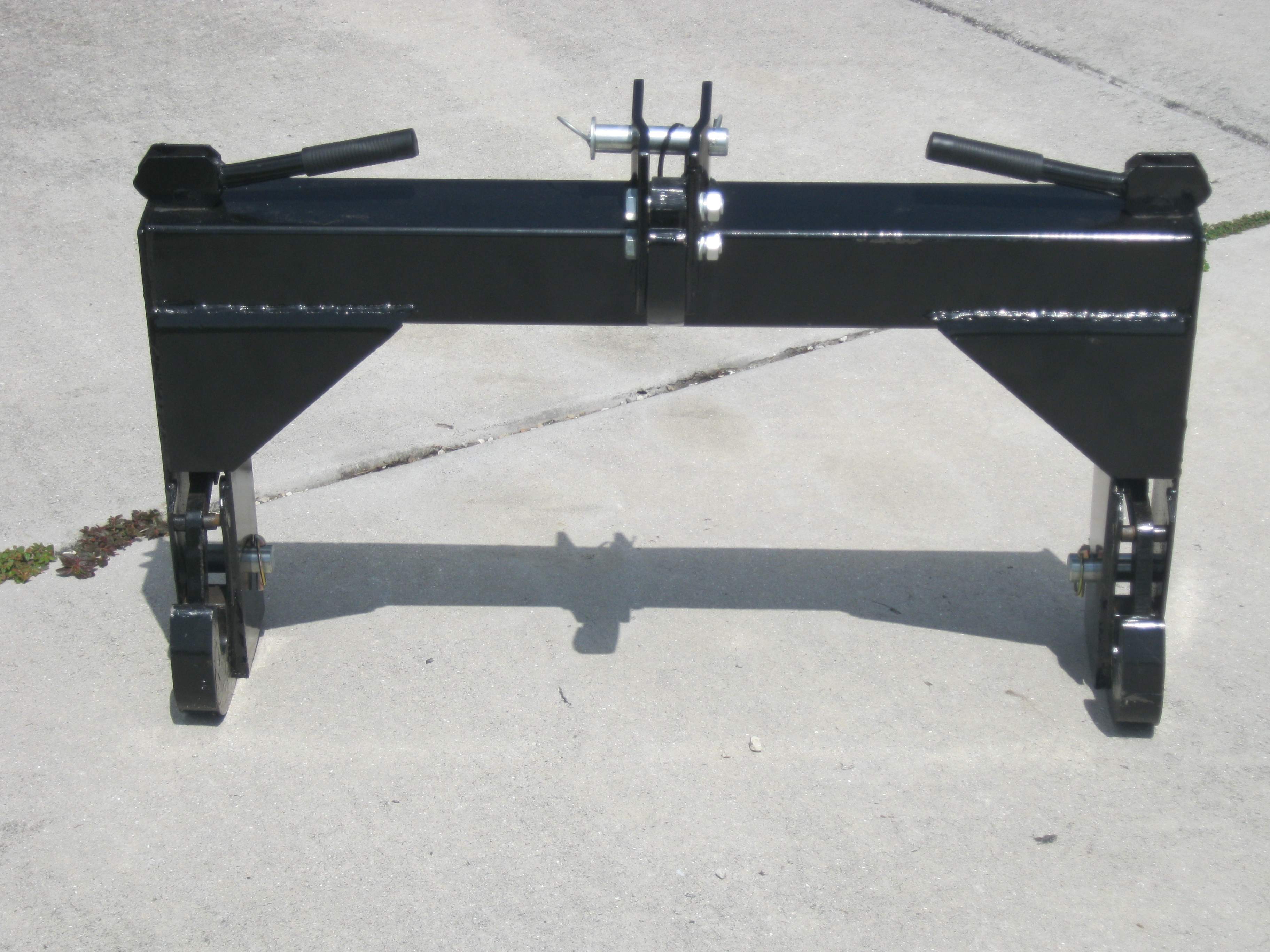

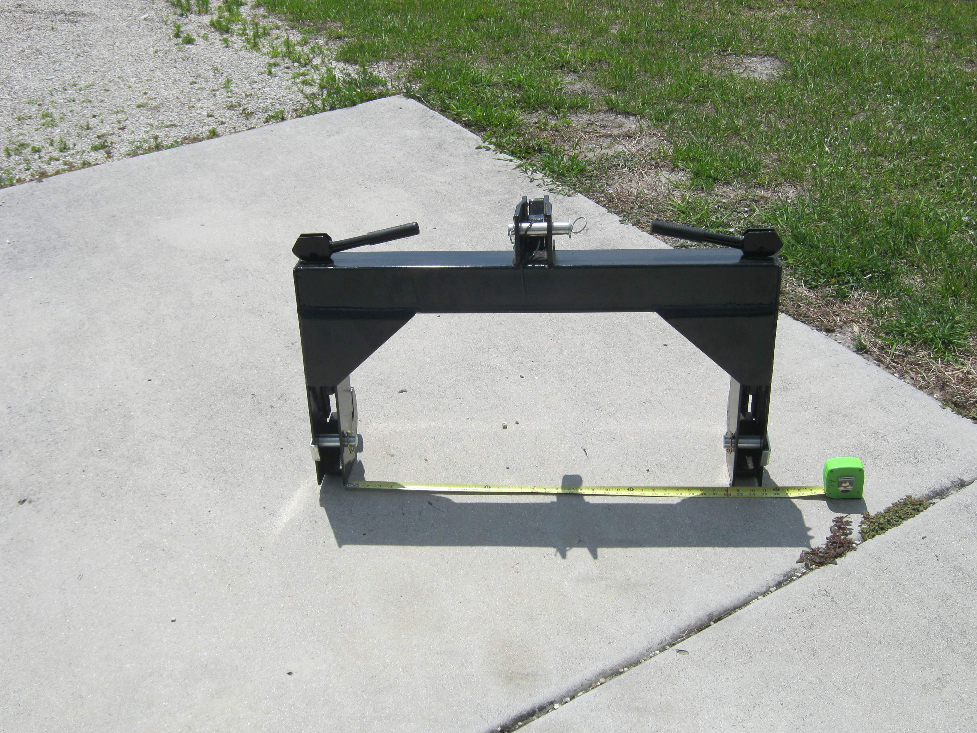

/ HF Quick Hitch #19
Went to HF this morning with a friend who was in need of a cheap air compressor . Anyway while looking aroung I knowtised they did not have any quick hitch attachments on display. I did not need one but asked manager if they had any. He said yes.
Turns out they had a CAT 2 in back, manager said I could have it for $ 67.82 tax included. :thumbsup: Then while at register it turns out they had some kind of promo where I got a tape measure thrown in with deal. :cool2:
He said it was the only one they had in stock. Also BTW those little generators they (HF) sells for about I believe for about $100 were sold out due to potentential FL hurricane threat. I also asked manager if they had any return generators out back I could buy "as is" but they did not have any,thinking I could buy one and repair cheap.

/ HF Quick Hitch #20
Boone
I did not know that they had a cat 2 qh.
