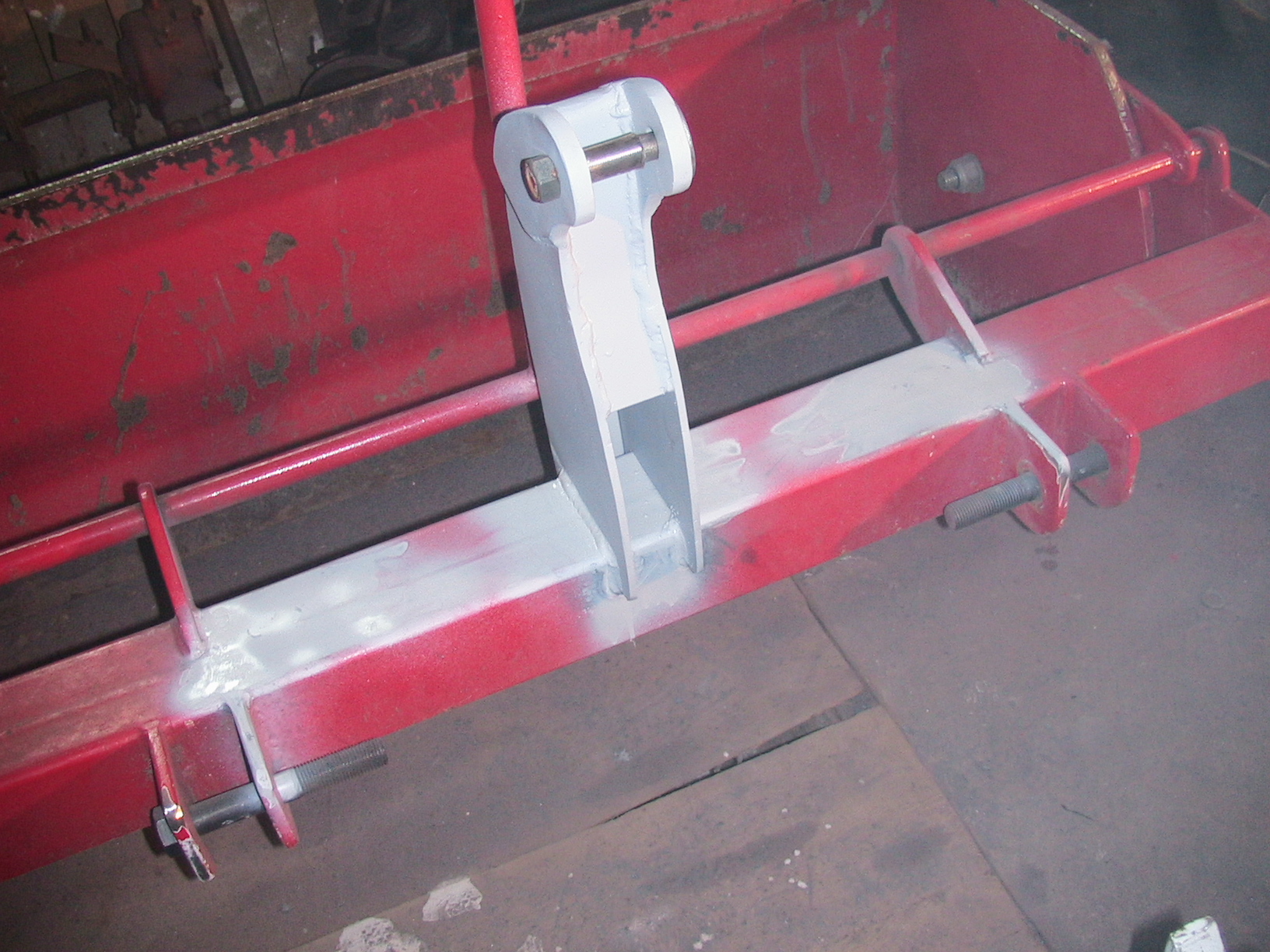

You could add a lot of strength in the lower pin area by making it a captured pin-a pin with supports on both ends. If the QH will fit between the square box and the pin then just a small piece of 1/4" with a 7/8" hole lined up with the existing hole, weld it on about 2" inside the other and get a pin that fits through both. You have a stronger pin area, and have solved your location problem.
I would definitely do what was necessary to make it fit--having a QH is just too handy.
Mike
I guess I dont quite get what you mean by making it a captured pin a pin with supports on both ends, could you draw me a diagram what your talking about? What sucks is im going off the HF dimensions, and the inside dimension of the blade hitch hookup is 28"
/ HF Quick hitch too narrow #22
It would be a clevis design and the QH would grab the pin between the two arms of the clevis.
This is how the lower link hook up of my RFM works (although it needs to be modified to fit my quick hitch too).
Based upon your measurements of the rear blade, I think doing something like this would require substantial modification. "Substantial" is a relative term depending on your skills in fabrication.

This may be what is meant. It is a clevis-style as Roy pointed out.
Notice the large nut with a washer welded to it as a spacer. That would allow your QH to fit tightly if the current lift pin mount will work for one end of the clevis hitch. Also in the photo is a CAT 2 bushing - which you don't need.
Anyway, you'd have to cut off your present lift pin mounting plate and weld on a couple of plates with a hole in each one. Depending on your setup, it may not be possible. A welding shop can make them for you.

I have included a pic of my rollover that I made which has "captured pins" and the QH which I also made. :D You can read about my process of modifying my implements to fit the QH. I am so thankful that I did. Just the other day I knocked down some piles with the rollover and then made a nice road with the RB. The time to change from one to the other--not much longer than it has taken you to read this post and definitely shorter than it has taken me to write it. :(
Mike
Mike
Very nice work Mike, sorry i was a little slow on this concept, thanks for the idea. this just might work for me. a little modification but i think I will wait till i get my QH before any mods. Thanks again
