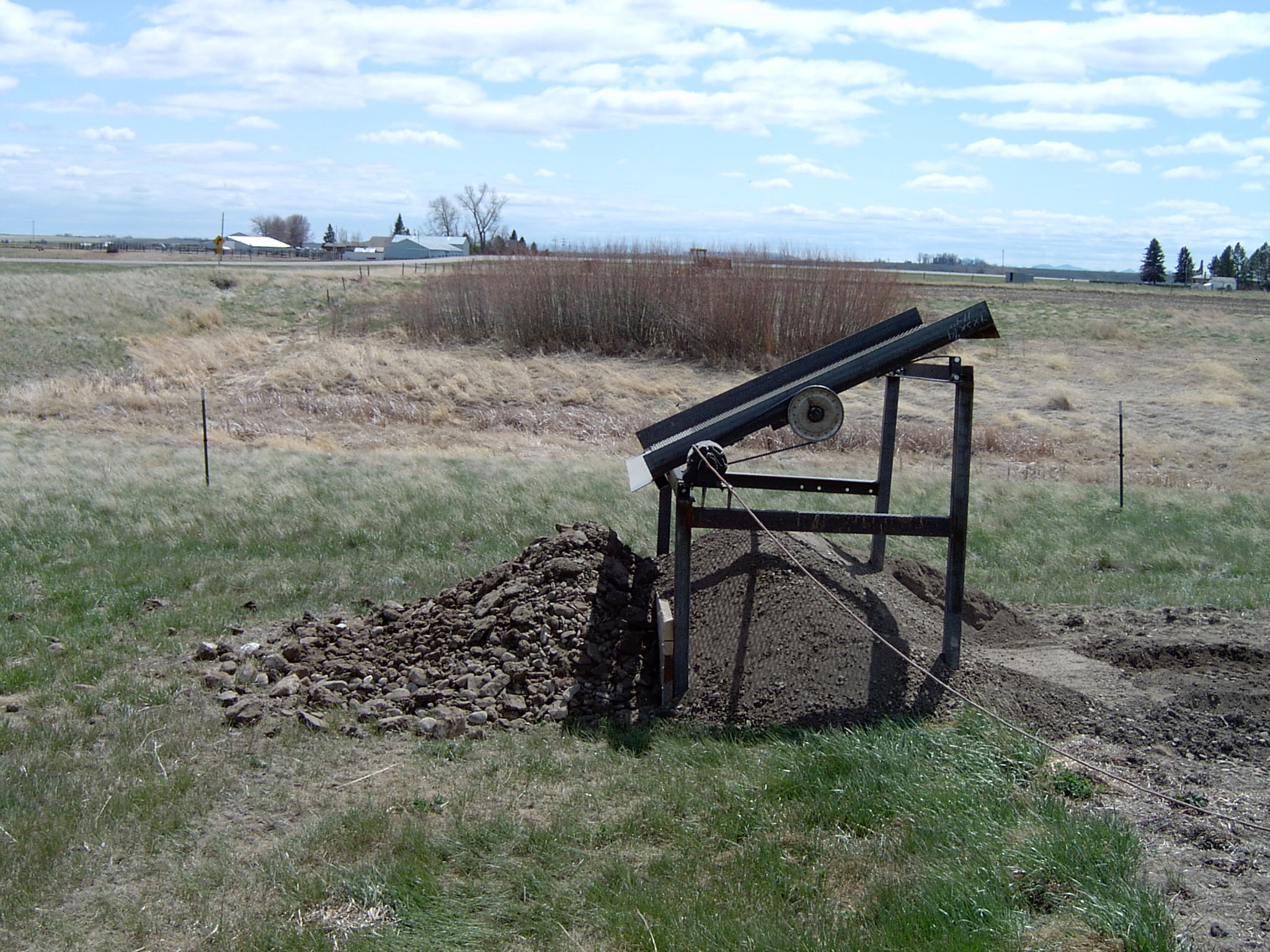

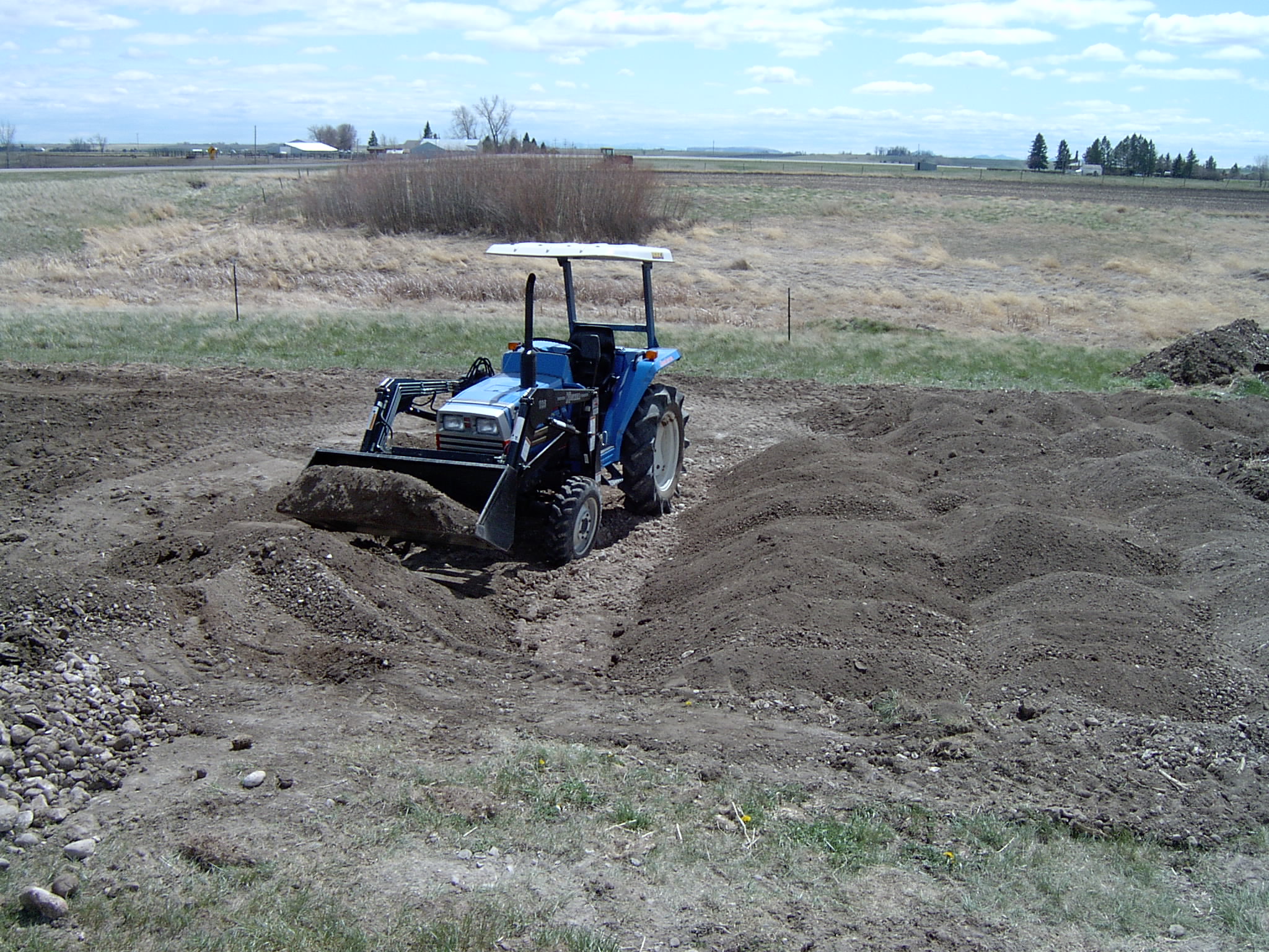

/ Hey soil screening builders #23
here's my answer to the hydraulicaly operated towed screener
/ Hey soil screening builders #24
ChickenMan, your machine is approaching "legendary" status. I have stared at those photos quite a bit.
Question for you, Are you shaking the grate mechanically, if so, how?
Or is it just the conveyor with mostly gravity doing the sifting work?
/ Hey soil screening builders #25
after sorting out the bugs im pleased at how well it cleans
it picks up all but pea sized stones 1/4 to 3/8 inches

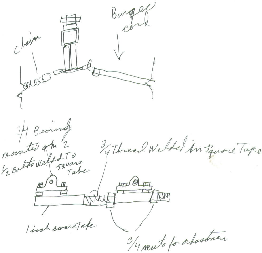

/ Hey soil screening builders #31
I made a crank from a 1" cold rolled rod welded to a 3/4" bolt with head cut off offset to one side mounted in 2 1" pillow block bearings
then mounted the pitman arm in the sketch to crank and to bolt welded to angle welded under screen frame
a v belt pully on shaft and engine or motor and your in business
the chain and bungee cord are to stabalize pitman arm
an eye will have to be kept on bungee, you may want to have a spare handy
