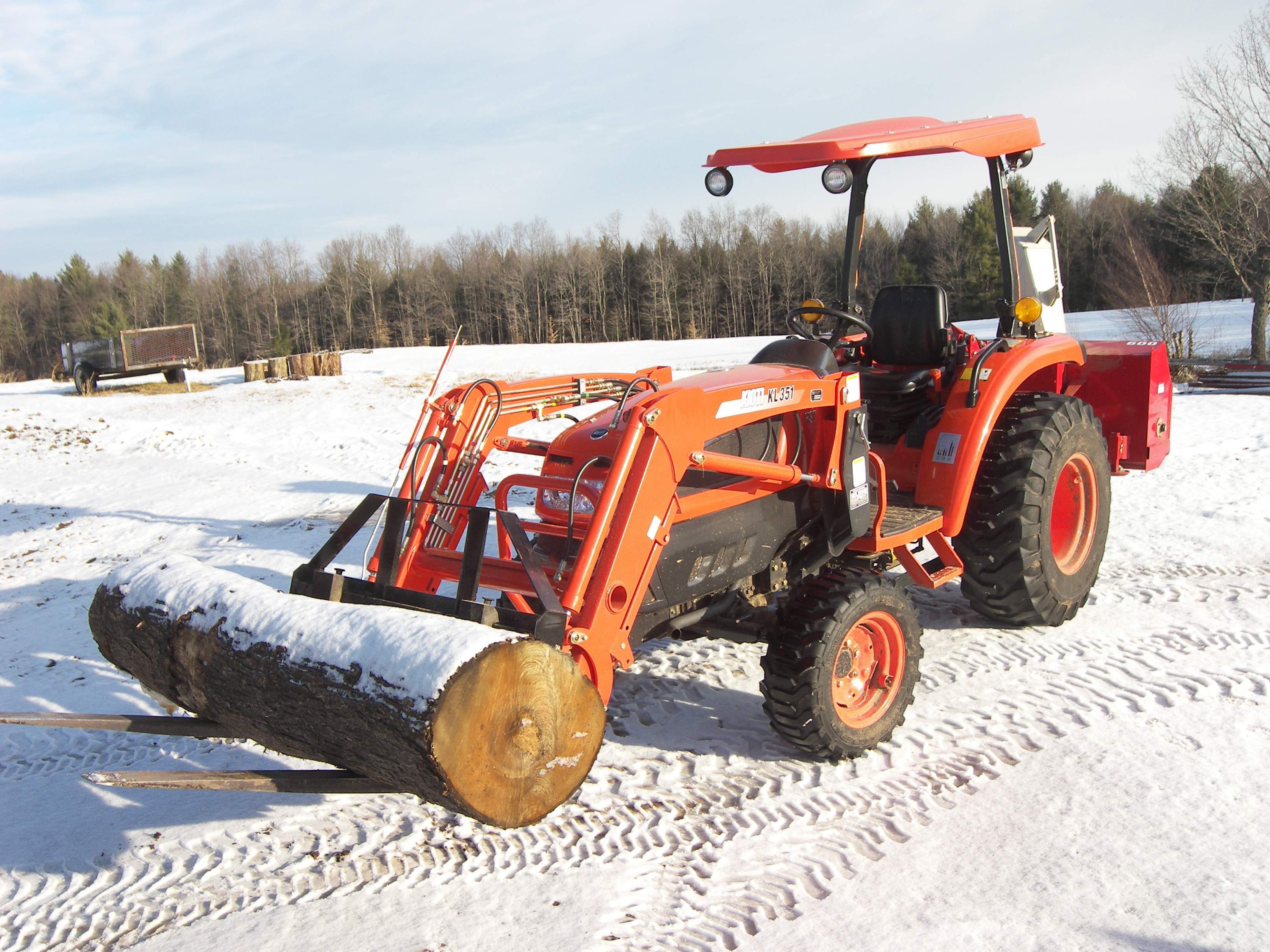

Here's my chainsaw mount.
Bill
How did you cut all that wood without getting the tractor or chainsaw even a little dirty:D:D
Jeff

Thats a really good job! I have a Kioti DK35SE HST with a loader, I need to carry my 3 saws, any idea's, in the bucket doesn't count .. .John
