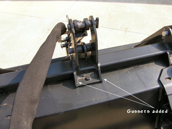

Firedog, I have had some thoughts on reinforcing the tube some. My thoughts are to add a gusset between the rod anchor point and the second bar. The second bar is welded to the plate so every thing should be strong enough than.

Charlie see if this picture gives you any ideas. This grapple has been in service for a few years and has held up very well. Gussets were added to the tube behind the hydraulic cylinder and each of the pivot points and bolted directly into the bucket.

I had thought of something like that Mike, but it was going to be a piece of flat stock.That shown in your picture may be a better way to go. Thanks.
The area that I did have some concern was where the rod end of the cylinder connected to that 2" sq. tube. I think that is where it would twist first.
