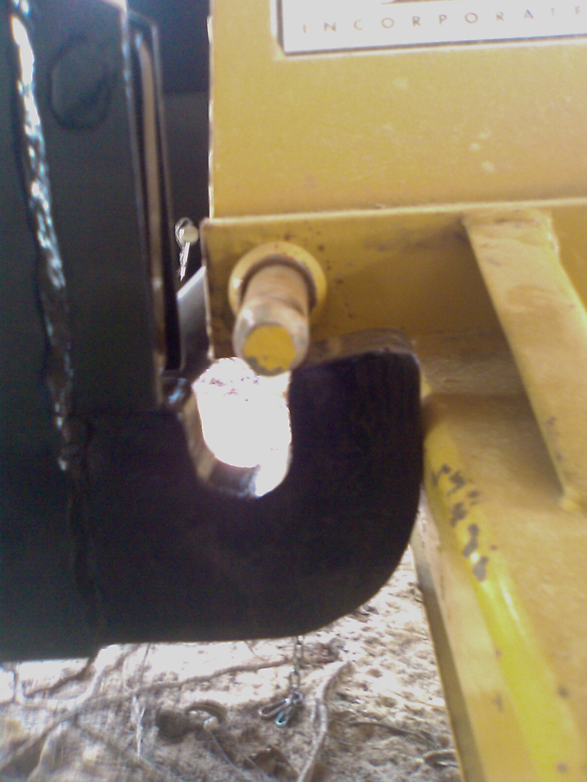

On the other hand I bought the cheap HF QH and wish I had bought the PEC. I got the 27.5" model and it was still not wide enough to fit the KK 60" brush mower when assembled as shown in the KK documentation. I moved the mower lift arms that the lower hitch pins attach to from the outside to the inside of the mower webbing and lost an inch, so that problem is solved. But the QH top link J-hook opening is too small to let the 3/4" pipe top link spacer on the mower slip into it. So I have to get the QH J-hook opening machined about 3/16" wider.
On my KK 60" tiller I have the same top link problem, but worse than that the QH lower hooks hit the tiller housing before the tiller lower pins align with the QH hooks. Just no way, they are at least a 1/4" too big. I guess I will grind some off of the QH lower hooks. Attached is a cell phone picture that shows the issue.
My old 72" box blade lower hitch pin width is too narrow to safely use with the QH, so I bought some longer pins for it, same for the middle buster. Even my cross drawbar is too short to fit the hitch and get latch pins in.
I'll probably be happy after I get all the issues worked out, but they are more of them than I bargained for.

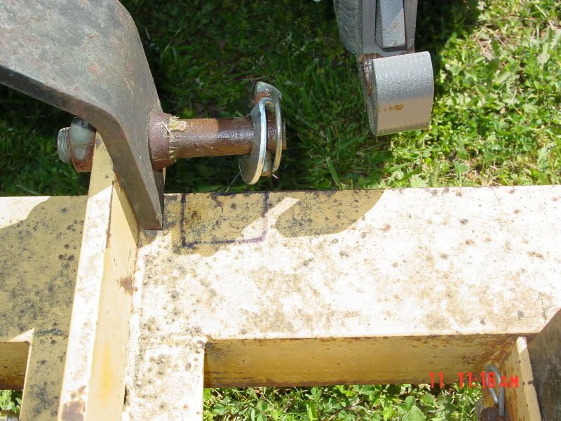

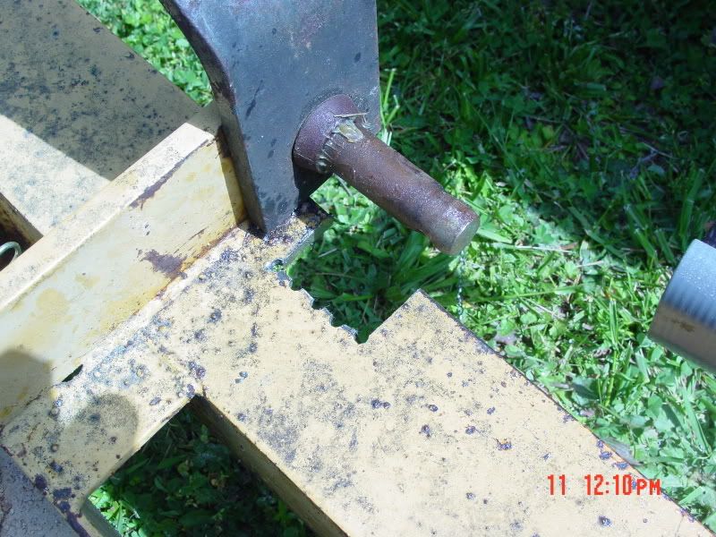

Finally got around to modifying my boxblade today so it will work with the PEC system.
Here's the marks to cut out the area needed for clearance:
Here it is after cutting it and with a Sawzall (and drilling five 1/4" holes on the backside). Once I did the cutting and drilling, I just took an adjustable wrench, set it to 1/4", put it on the cut area and worked it up and down till it broke off.
Finally, here it is after the cut and the BB hooked up with the Easy Change in place:
And just a pic of the whole boxblade hooked back up. I don't think it will miss that little bit of metal at all. Maybe one day I will get a small grinding wheel and a file and work the backside cut so it will look nice and straight, and then paint it. Obviously I got to hook up the BB with the Easy Change in place and I got both side pins hooked up in no time flat, with no cursing this time!! :) BTW, previously I didn't know who made this BB but upon reading the tiny little silver warning label on the side of it, there was the name Wallberg Farm Equipment Co out of Winston-Salem, NC. Never had paid it any attention before! Duh....
