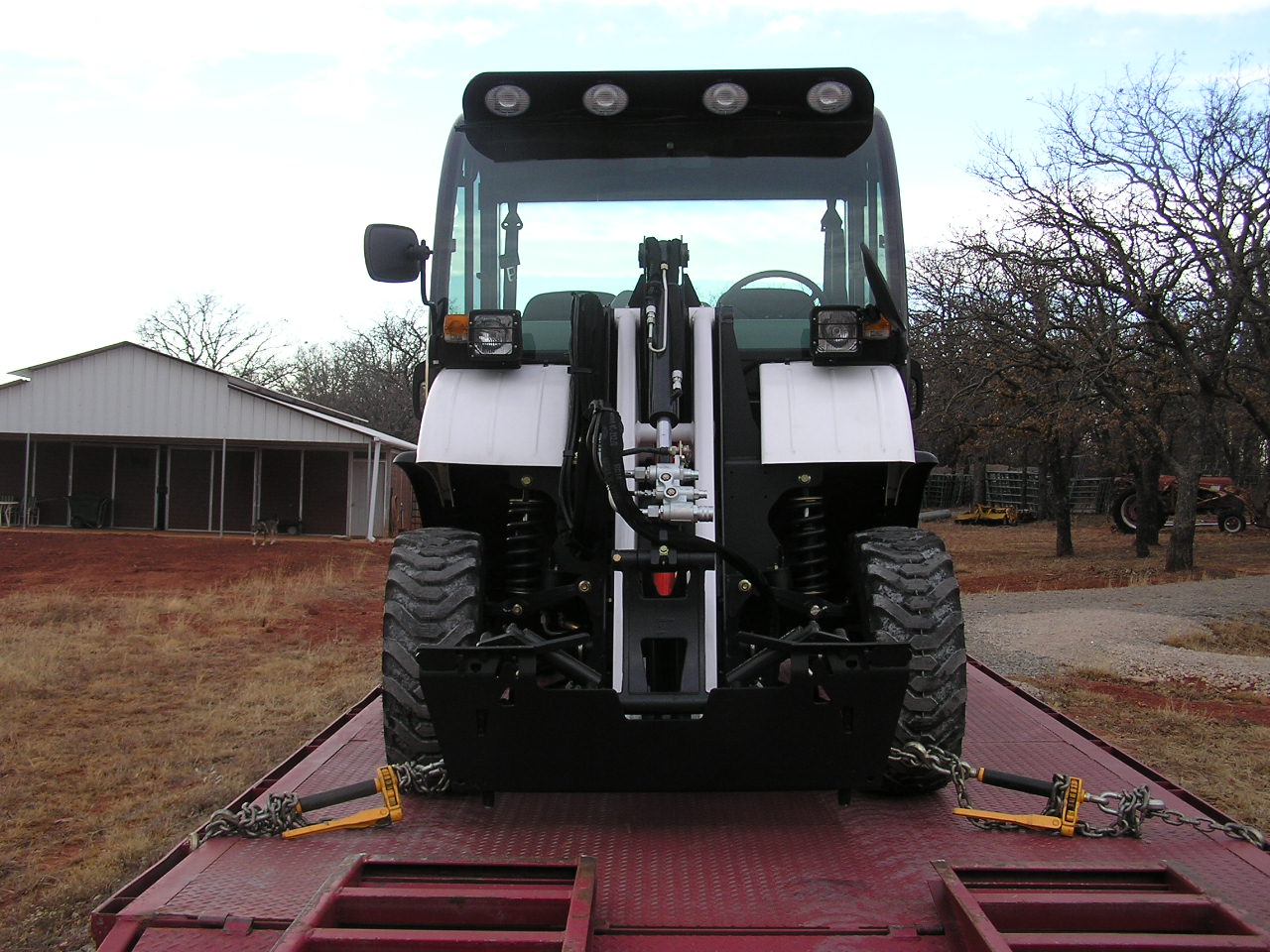

I found the perfect trailer for me, 4' pop-up dove tail, 5' dovetails tend to drag a lot.
For hauling square hay bales, ramps make a back stop.
For round bales, leave the deck down and ramps hold the last one or two in place.
For equipment, ramps slide in to match tread width, and support the rear when driving up on them.
