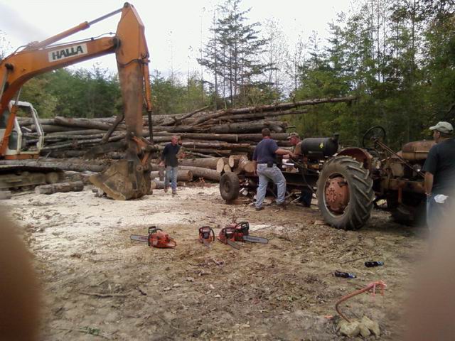

I could not produce 4-5 cords of wood per day processing a whole tree or by just cutting from a pile already stacked in 20-30' lengths; that is if you are talking about wood ready to be burned. By the time one or two people cut, carry, split, and stack wood that is being cut in a day's time, 4-5 cords is a real stretch unless of course you also own a wood processor set up with conveyor etc. Now if you're only talking about cutting up rounds to make 4-5 cords in a day, I agree it's possible, but to get what I consider "firewood" cords, I would have to sit back & watch
As far as for throwing in the limbing & processing: from cutting the tree down, limbing, rounding, splitting, moving & stacking, 4-5 cords........:confused: I do know for the limbing I would have recommended the 346xp, not the 372xp, but for production, for me anyway, it's the 372xp.
Some of the guys that cut with me are 65yrs old and all they say when using the 372 is that it is a pleasure to cut with; not full time cutters, just trying to stay warm and help each other out.
As I said, there's nothing wrong with the 357 (or the 262 and the 257 you mention, both close to the same hp family with the 357; 262 a bit more, 257 a bit less), I have one of those too. If I were to have to use only two saws it would most definately be the 372xp & the 346xp for saws of today. For quick cutting of firewood though give me the 372 any day!
Oh, and a few things to make gathering a bit easier:

My reference was toward the 357 being an all around saw and being able to hold up to the tune of 15-20 cords per year. My suggestion was based on not knowing critical points of the op and him buying one chainsaw. As far as producing the amount of wood I stated, it was indeed firewood. Skidder would drag up stems. Stems were sectioned to 18". Wood was split on a traditional splitter and belted to a stake panel holding 2 -2/12 cord. We would do that twice in one day ( don't get me wrong, we had all the saws and bigger stuff would warrant larger saws for bucking. Another factor as to the saws we would use was which saws were working.) No stacking or leg work. My point being that these smaller saws held up for that kind of production. No wood cutter can make do with one chainsaw. Even if the op needed experience, the 357 would have made a good first saw and then a good limbing saw if he found he needed more hp of the 372. (My saw of choice after the 357 would have been the 385) but I do agree that the 346 and 372 make for a very nice two saw combo and would be all the saws a home ownwer would need for 10 or more cords and for under that, I'd go for the 357 with a 16" and 20" bar for the one all around saw or a saw to gain experience on.
