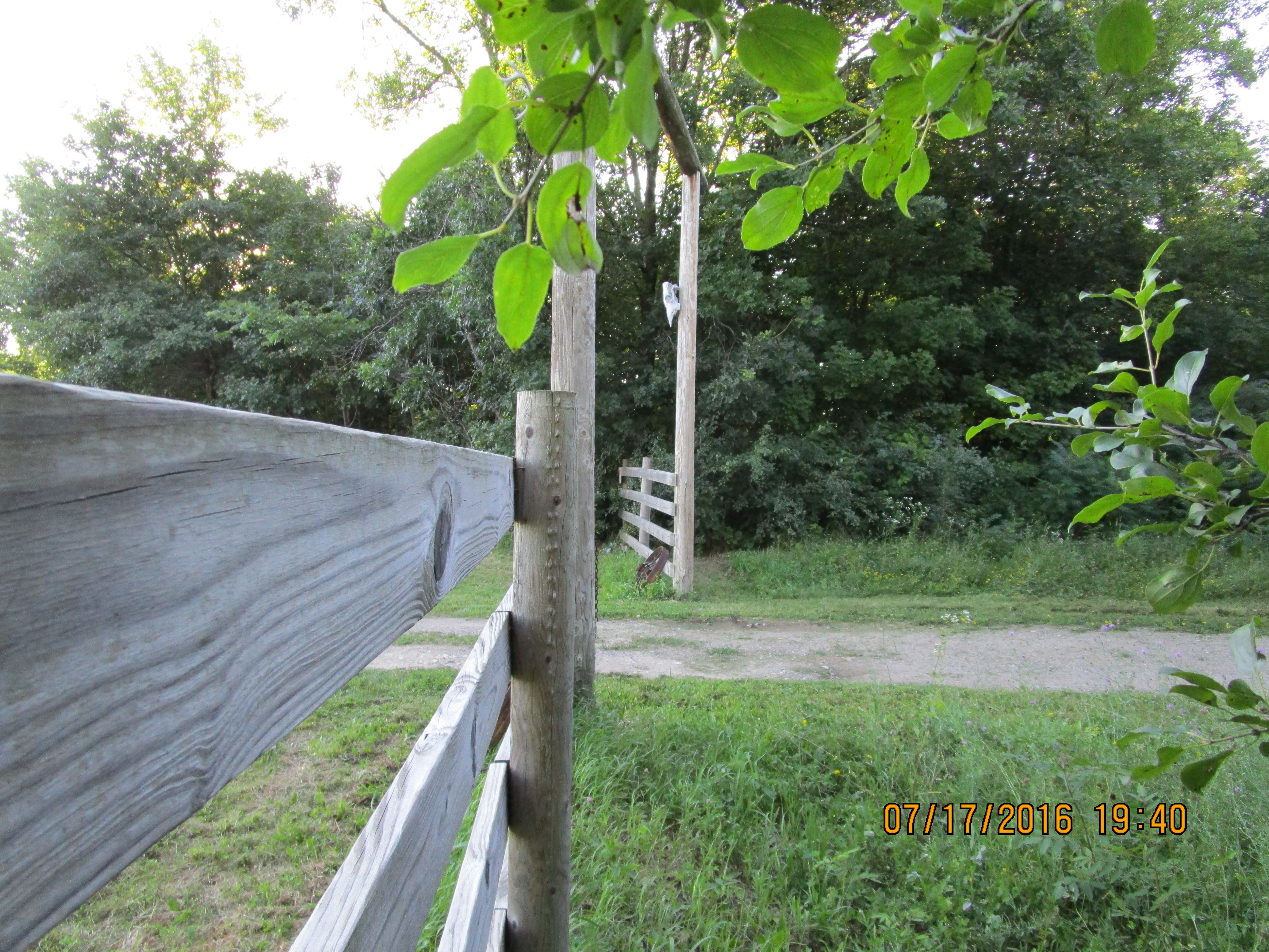

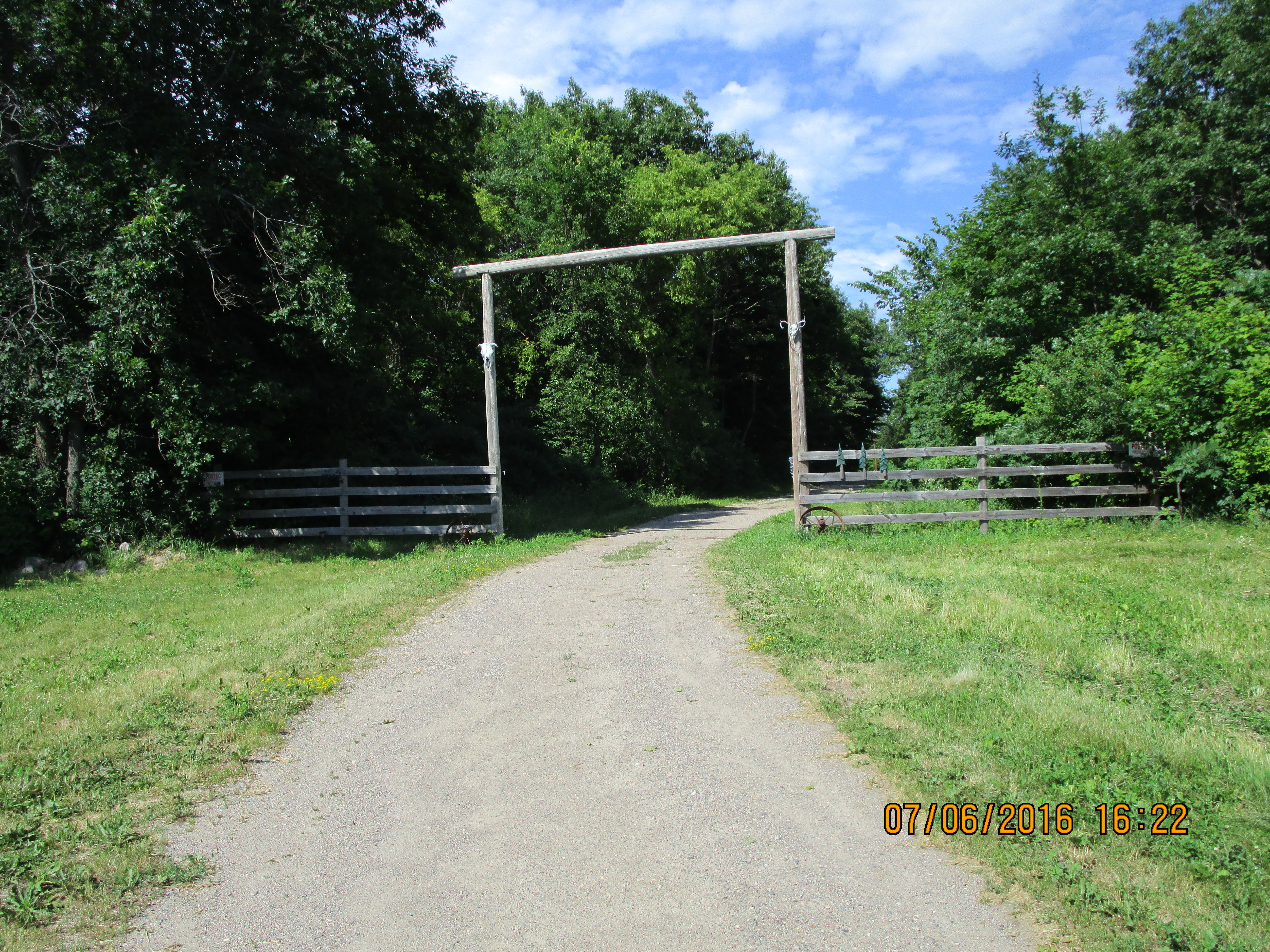

Hi Everyone,
I have an arbor part way into my driveway, about an eighth of a mile from the house. I've always wanted to do something decorative and functional here, as its the entry into my residence. The standard eight foot gates that a person can buy in a farm store are too short, a ten footer is too long, and I don't really care for the look of one ten and one eight foot gate.
The posts on the arbor are sixteen feet and eight inches apart. I am thinking two gates that are a full eight feet in length and four foot high. I have inch and seven eighths schedule forty pipe and premade ninety degree corners that I can use.
I am thinking that one day I may have an automatic opener on these gates so that may play into the design, and they will need to be able to be locked in some fashion.
I would like to ask the tractorbynet community for some creative design ideas.
Thanks in advance.

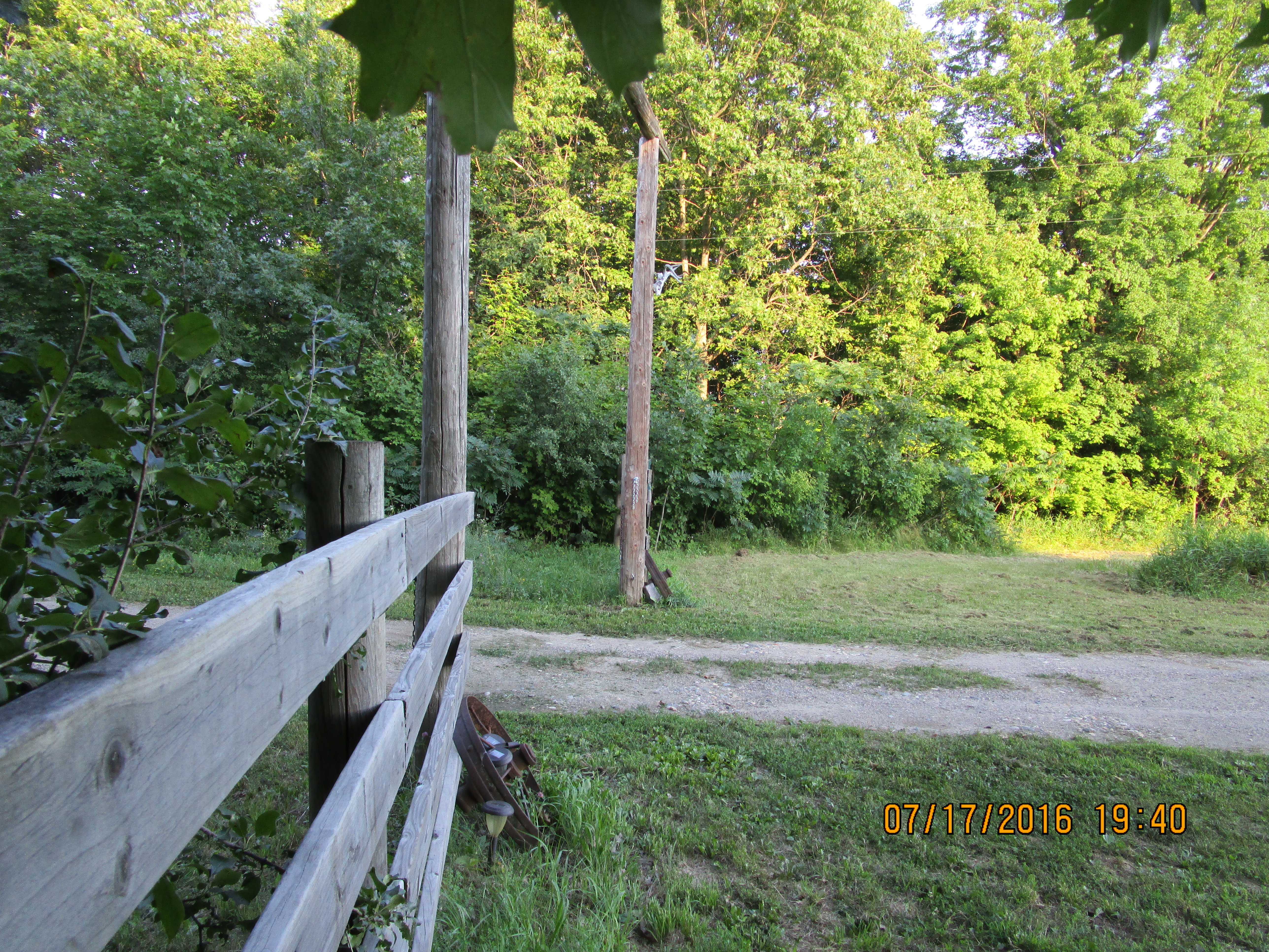

Thanks for the thoughts everyone. I've thought of the sliding gate, but I don't think it will work for me. I had a snafu when this was put in six years ago. The two upright posts are canted from each other rather than in a direct line of being straight across. This came into being because in the drilling of one hole, I hit a boulder, so the hole was moved thus moving the layout of the arbor. A sliding gate may not work because it won't track directly behind one side or the other. Still open to other suggestions to solve this.

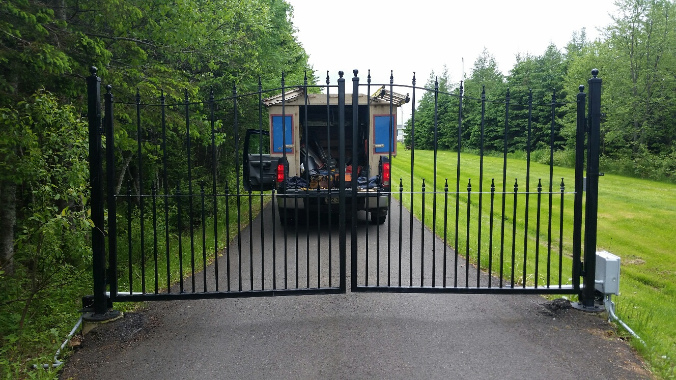

I have swinging gates on my driveway. Being in Canada we get feet of snow and it is not a issue for me. The gates are about 6 inches of the ground so it takes a good storm to block them. They also swing in so I can clean up to them after a storm.
I bought my own parts for the operator with the thought if something breaks I just need to replace that part from20160616_153618_resized.jpg the local stores.
It has been in operation for 5 years now and like it.
Could you track from the inside of one directly to the offset post on the other side with a slider? This would take away from the appearance of the gate being "behind" the fence.

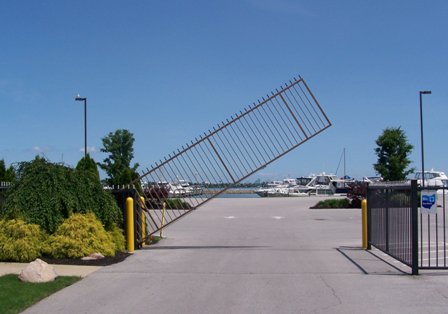

/ help with gate design #18
Have you thought about a vertical pivot gate? They have one at the storage unit and that thing goes up/down 100's of times per day without a problem.
