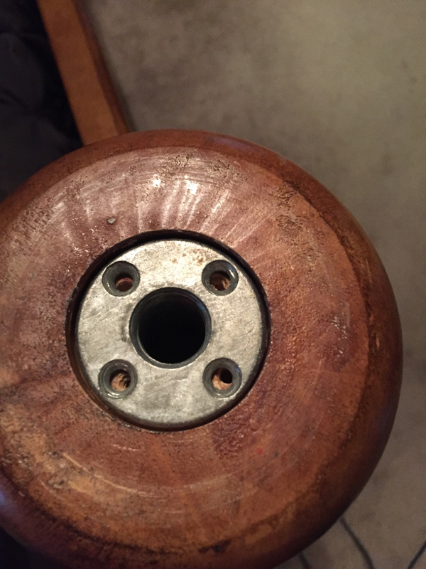

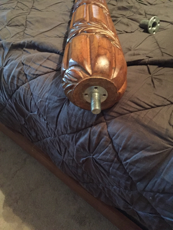

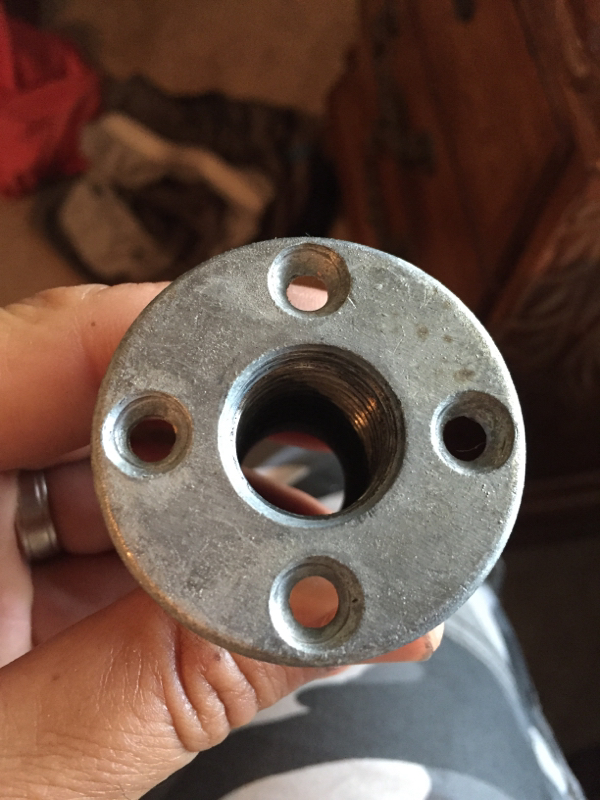

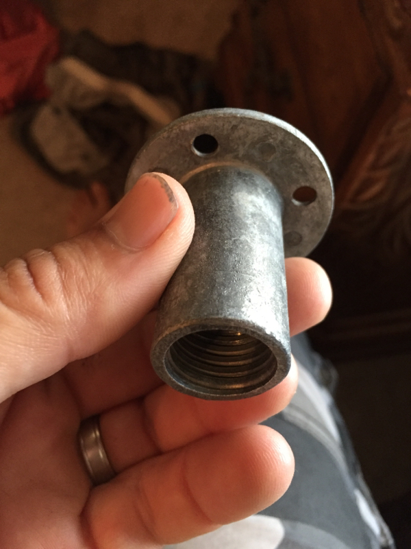

Anybody have any idea where I can find these parts? They connect the bed post to the bed. The male thread is 3/4 and two inches long. The female is the part that broke all up. In including pictures of the same part off another leg. The bed has been discontinued and was made in China so no luck trying to find manufacturer. I don't have a clue what these parts are called to even try and find them. Any help will be appreciated

Got a little rambunctious did we ;) I would call that a threaded T flange, hand me that welder over there.
Maybe another way to look at fixing it; threaded rod is relatively cheap, if you can make that hole go all the way through and recess it at the end, you could probably bolt it all together with threaded rod, nuts and big washers that are easy available at your local hardware store :D

It's hard to tell from the pics if those are made from that brittle pot metal that they make carburetors out of or if it's galvanized. Couldn't locate anything in google, so if it's not pot metal and not in more than two parts, weld it up. If it's broken in several pieces, you'll probably have to fab up a new one from a big washer and some heavy wall tubing threaded to match. If it's metric (which I suspect) it might be cheaper to make the matching half from a SAE bolt rather than purchase a big tap for the job.
If you really want to source one, try taking some close cropped detailed pics at different views and do Google image searches until you find something close, the ones above just give generic hardware.

It's pot metal which is why it broke in 10 different pieces. I going look at making one. A 3/4 washer will work but have to fine something that has inside threads that I can weld to it and fit in the whole. Thanks for the replies

I'm thinking that a nut welded onto a washer would work fine. Then you either drill the hole in the wood bigger or grind the nut down so that it fits into the existing hole.
/ Help with bed post repair #7
3/4 coupling nut coupling nut - Google Search welded to a washer, you might have to turn down the OD of of the nut.
Maybe a piece of 1/2" pipe threaded inside to 3/4" bolt, it's 7/8" od x 5/8" id.............Mike

It is called a "TNUT" ot "Tee Nut" and comes in many sizes and screwed on or hammer in. At hardware or big box stores. Or try Fastenal.

I was able to take a big washer and drill the holes for screws then JB weld it to the threaded two inch sleeve. No way I could find the replacement piece because the manufacturer went out of business in China. Hope this helps

I know this is an old thread, but I had the same problem. Brittle "pot metal" insert that shattered into a gazillion pieces. Looked for months for a replacement. Finally found one on Amazon, shipped from china, that is so perfect that I don't even have to replace the threaded portion. Details below. Cheers
uxcell M2 Thread Bard Hole Tee Nut Insert Nutsert Flange Rivet Bed Leg Fastener - - Amazon.com
uxcell M20 Thread Bard Hole Tee Nut Insert Nutsert Flange Rivet Bed Leg Fastener
Price: $12.90 & FREE Shipping
Product Name: Bed Leg Fastener; Package Content: 1 x Tee Nut, 1 x Flange Rivet
Main Color: Silver Tone; Material: Carbon Steel
Tee Nut Size: 43 x 50mm / 1.69" x 1.97"(Total H*Flange D); Flange Rivet Size: 79 x 50mm / 3.11" x 1.97" (Total L*Flange D)
Thread Size: M20; Flange Rivet Pin Length: 37mm / 1.46"
Drill Hole Dia.: 24mm / 0.94", 18mm / 0.71''; Mounting Hole Dia.: 6mm / 0.24"; Mounting Hole Distance: 25 x 25mm / 1'' x 1''(L*W)
