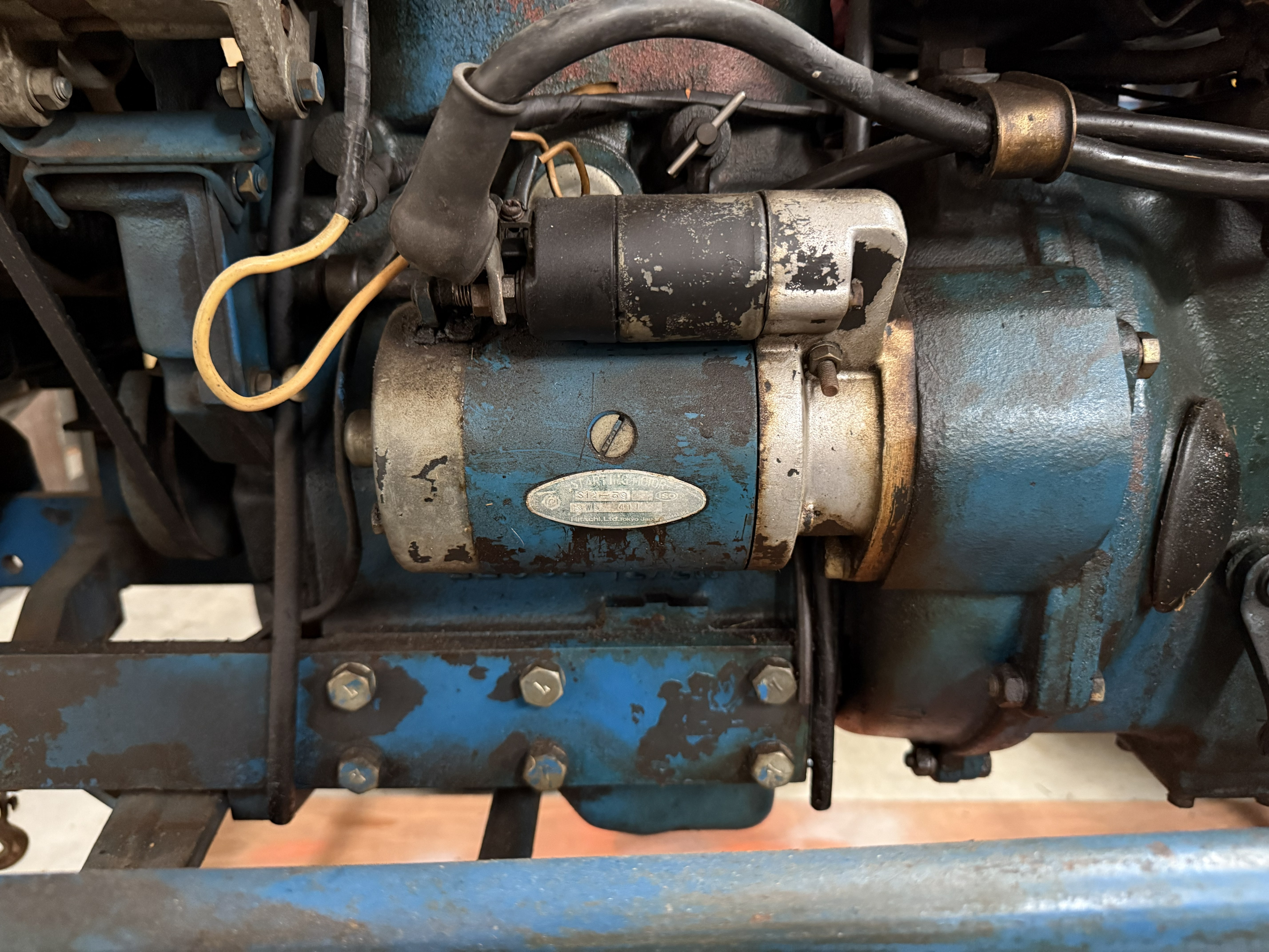

Good Day All,
I have looked around the internet and found just enough information to confirm I have no idea what im doing.
I had a no crank situation, just a click. I tried placing a screwdriver across the two largest connections on the silinoid and got a click once. Tried again and nothing. Tried from the small wire to each of the large connections and nothing. The battery is charged. I get power to the small wire at the silinoid when I turn the key to crank. I have power at one of the large connections on the silinoid all the time (it comes stright from the battery).
I think its an issue with the starter or the siliniod. What do you guys think? How do I determine which is bad?
Can/should I dissassemble starter and try to repair? Is it repairable or must I replace.
Any help would be appreciated.

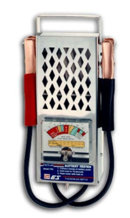

The battery may be charged (showing 12v on your voltmeter), but may not have enough starting amps available to turn over your engine. You need to load test your battery before getting into other things. You can buy one of these:
Or, take your battery to any auto parts store and they will test it for you.

Ed, I had already used one of those testers and it showed good as expected since the battery was bought just last year.

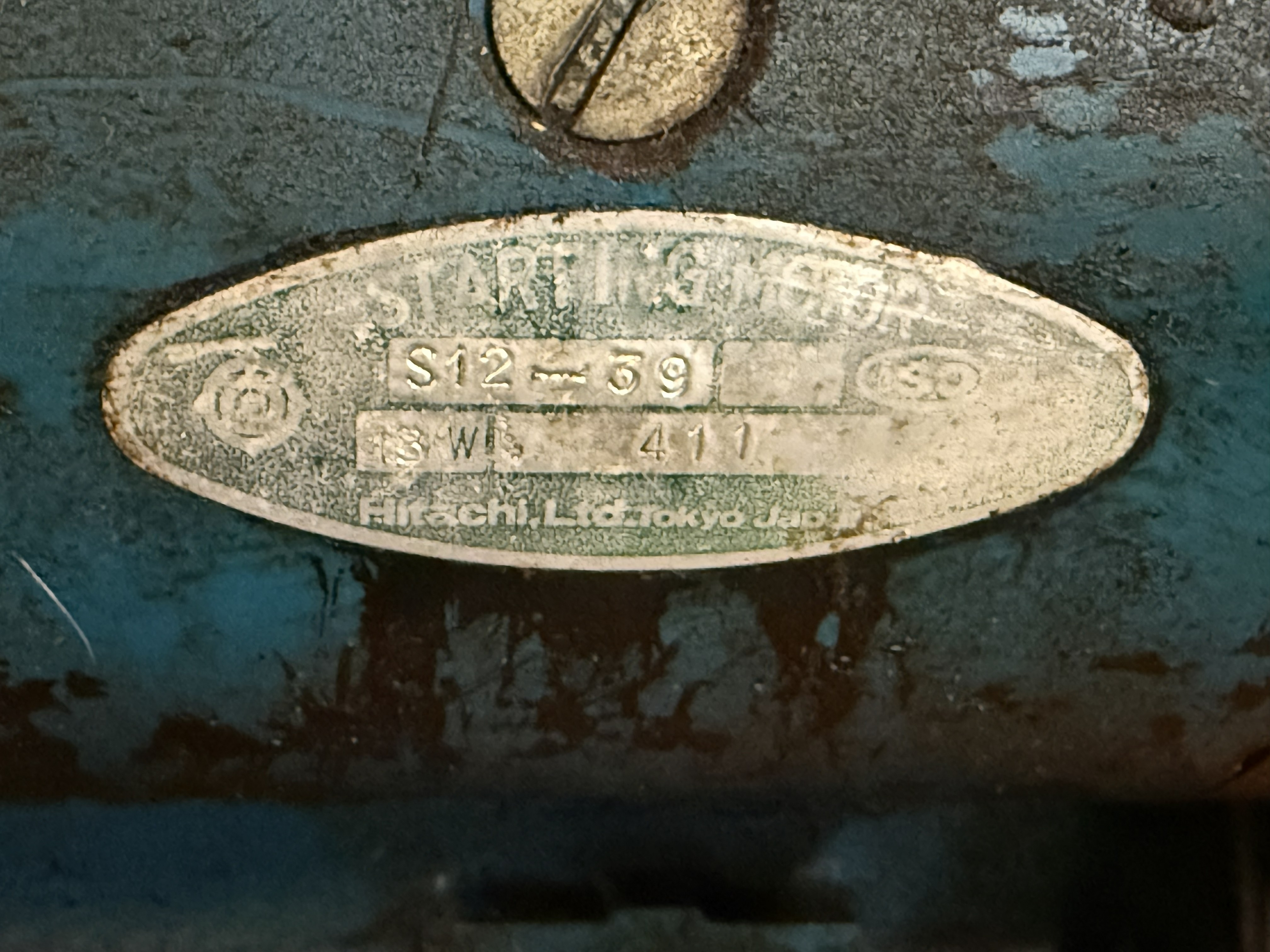

Trying to add a few photos but get a red document icon with folded edge with one the other comes up as a photo with insert.
