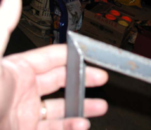

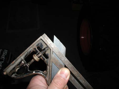

Guess my explanation wasn't so great. Mebbe two pictures can save the best part of 2000 words?
Here's the first showing the 45 degree cut of one leg. Both legs were cut at 45 degrees..........
/ Help......What Angle?
#12
Next shot (OK, a bit fuzzy) shows the less-than-90 degree corner that results with 45 degree cuts. The ends of the angle need cut at 45 degrees while being held at a 45 degree angle...............chim

BXMMCC, that's the way I figured it could work, but my problem is that I have no bandsaw or chopsaw at home. I do have a sawzall, but that doesn't help. What I'm trying to do is make the cuts with a hacksaw, and I haven't been able to determine how to mark the material for cuts. So far, the best idea I can come up with is to measure the acute angle I ended up with, then add half the difference between that angle and 90 to the 45 degrees. Maybe Wifey needs to approve a trip to Harbor Freight for a saw? Thanks..............chim

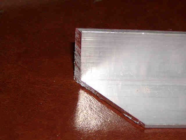

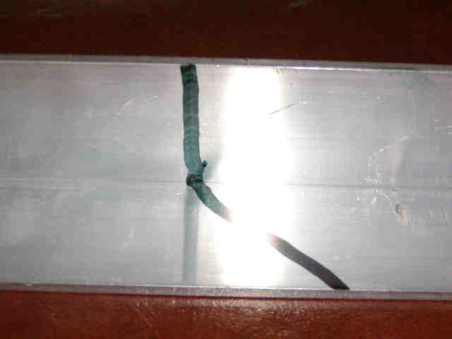

I had a hard time telling what you want to do, but after seeing the finshed part you had already made, I think I understand. I don't know much about metalworking, but this problem is simimiliar to the "crown-molding-cornundrum", which is that you will always run out of crown molding before you finish the room. The trick is to mark the layout lines while the material is in the position it will reside when finished.
The attached pic show the first piece marked up.
/ Help......What Angle? #20
First piece cut. Note one face is perpendicular to the length, and one is at 45 degrees.
