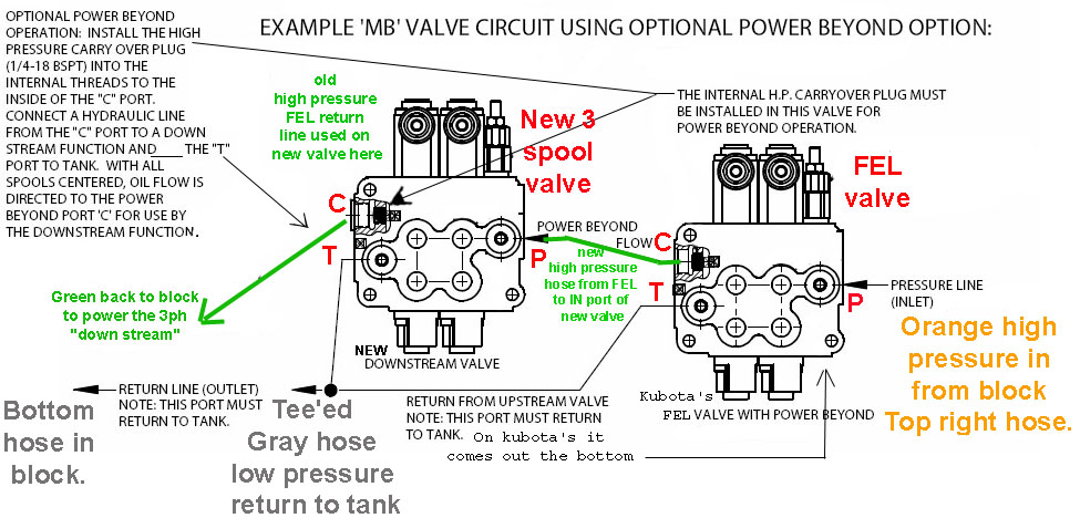

Found this, don't remember where I got it - Steve
Oh, even though PB and IN are reversed I'm not sure it would matter since the PB adapter makes those two ports CONNECTED to each other, but NOT to the Tank port??!?

   / Help ordering hydraulic fittings (for rear remote) #47
   / Help ordering hydraulic fittings (for rear remote) #48
BukitCase
The diagram you posted is correct.
The PB floe from the FEL is going to the new valve IN port and the PB from the new valve is going downstream.
If he did not use the the optional rear hyd blk, then the FEL flow would go to the IN port of the three spool valve and the PB flow from the three spool valve should go back to the hyd blk and the flow will continue to the 3pt.

I understand this much better now, and when I go out to my tractor this weekend I'll follow the hoses & get it right. Will be there for Mem day weekend. If anyone can find a good schematic of what my system ought to be, that may help too.
I'll have a look in my Kubota Workshop manual ... not sure, but it may cover the B2710 as well as the B2910/B7800.
Sure hope I can add PB to the Dinoil, if they are $18 & a hose that doesn't hurt much ...
You'll need one more item (see below)
(and do I have to add the rear Hydr block too?)
No you wouldn't have to.
You could just run a hose from the (new) power beyond outlet on the rear remote valve to the power beyond inlet on the mid hydraulic block. Basically just move the hose that's attached to the return port on the rear remote valve now to the new power beyond outlet on the rear remote valve.
Then pick up a hose to run from the return port on the rear remote valve to to the tank/reservoir return port on the side of the tractor.
Then you add a JIC run tee to the tank/reservoir return port on the side of the tractor (to allow connection of two return hoses - the one from the FEL valve and the one from the rear remotes)
