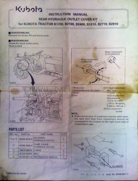

Kubota did offer a rear hydraulic block assembly as an option - which provided two ports (Out and In) to allow installation of a valve block (with Power Beyond), in series, just before the 3PH. If memory serves, the (female) ports on that hydraulic block were 1/4" NPT thread ... but I would have to check the instruction sheet or do a visual to make sure.
The threads on the rear hydraulic block (what is likely feeding your valve, assuming the dealer did it right) are 1/4" pipe ... looked earlier today on the B2910 to verify it. The flow rating on the rear hydraulic block is 4.5 or 4.7 gpm (from memory) .... which is somewhat less than the hydraulic block for the FEL is rated for (6+ gpm)

I say the rear auxiliary hydraulic block - which is the inlet/outlet on the rear axle case that's probably feeding your Dinoil valve - is 1/4" pipe (female)

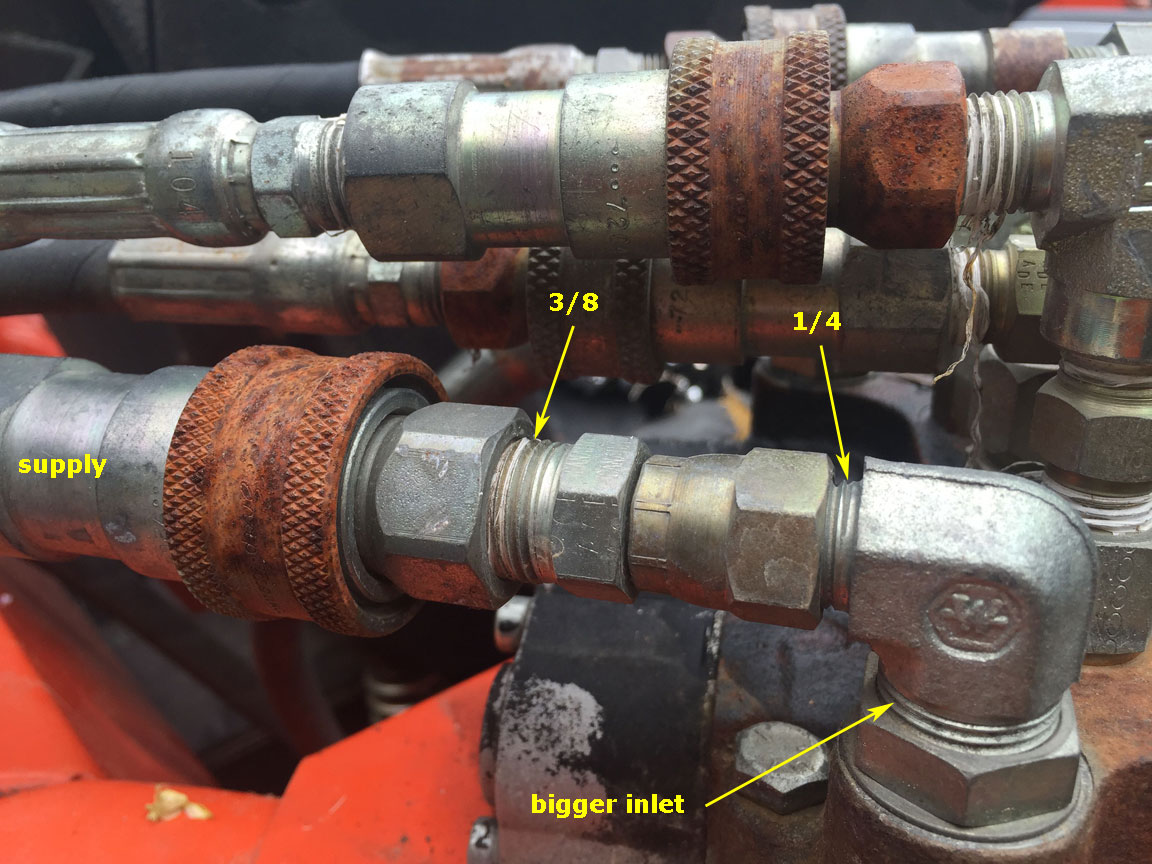

Anybody know what's going on here? Why would there be a 1/4" NPT ftg (& swivel) in the 3/8" supply line. RS, you say that the aux hydr block is only 1/4" pipe?
Why does that bigger inlet elbow have a 1/4"pipe on it?
Well ... not to put too fine a point on it, but I think BukItCase kinda nailed it earlier ... :D
The more interesting question is why in the world would someone place a quick disconnect in the supply, return or PBYD lines for a valve that is permanently mounted on the tractor ...
You'd think they would have been plumbed permanently ...
Based on my visual inspection of the hydraulic block on my B2910, yes - it appears that the threaded inlet and outlet (both female) of the hydraulic block are 1/4 NPT.
I have the actual installation instructions for it up in the shop in the folder for the tractor ... I'll verify it in a little bit, when I go up there.
Hard to say ... whoever did the install had that particular fitting in stock and wanted to get rid of it, etc., etc.
Probably no real legitimate reason for it ...
Based on the stated flow in and out of the hydraulic block, it does bottleneck it slightly.
Forgot to look for the hydraulic block, see where this all comes from. Will report back.
Looking at the tractor from the rear, it's on the right side, behind and north of the rear axle.
Look for a plate that is bolted to the rear case and has a pair of tubes welded to it, and a square/rectangular block of metal welded onto the tubes (which is where the threaded holes - which face rearward - are ...)

But keep in mind that the FEL hydraulic block is rated for almost 50% more flow (6+ gpm) than the rear hydraulic block is (4.5 gpm)

425456-help-ordering-hydraulic-fittings-rear-img_2130-jpg
