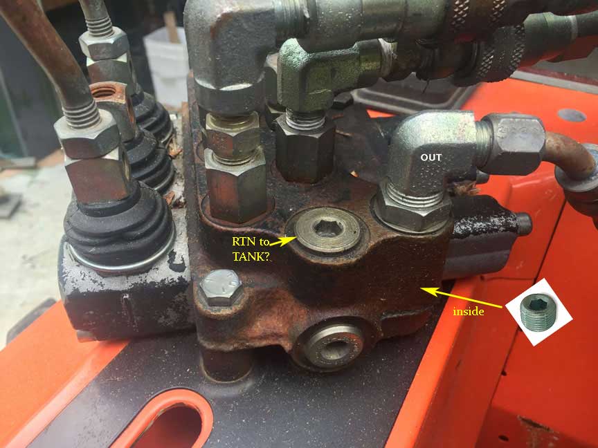

OK I'm back out in the mountains and here's whats inside the "OUT" port.
Down at the bottom of the hole there is a thread that's about 1/2" diameter, they are barely visible in the picture. (Not referring to the reflection image on the oil surface).
From this pic, can anybody tell me is this port likely configured for a PB adapter? If you think so I will start chasing Dinoil for one.

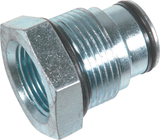

As you can see in the picture below, there is only one set of threads on a PB adapter.
The purpose of the PB adapter is to separate the main gallery and the tank port by the tip of the PB plug.
The other style of PB adapter is a hex screw to separate the tank port from the main gallery.
The new picture you posted, is it to infer the wrong way to install a remote or accessory with the circle and line through the circle?
Did you draw the red circle with the line, which means NOT.
Say you had a QD on the input to the remote valve with engine at max, and the QD popped open, what would happen?
If the PB port does have a second set of threads, then it is designed to use the PB hex screw.

The new picture you posted, is it to infer the wrong way to install a remote or accessory with the circle and line through the circle? Did you draw the red circle with the line, which means NOT.
Yes this is my (blue) notes on Prince Hydraulic's diagram showing how NOT to do it.
The other style of PB adapter is a hex screw to separate the tank port from the main gallery. If the PB port does have a second set of threads, then it is designed to use the PB hex screw.
Very good info, thanks! So If I plug the gallery below with the hex screw, then the fitting I labeled "OUT" becomes PB? And then do I have to remove the plug adjacent to it for the rtn to Tank?

You need to check with Dinoil about the PB if any of their valves has the capability.
If in fact the hex screw is correct, you need to get the exact screw that fits the Dinoil valve. It could be SAE or metric.
Looking through some of their valves, I did not see mention of PB.
The port labeled tank/out should go to tank.

I labeled it "OUT" in the pic only. Haven't found any labels on the valve. Will look again carefully for port labels on the valve.
