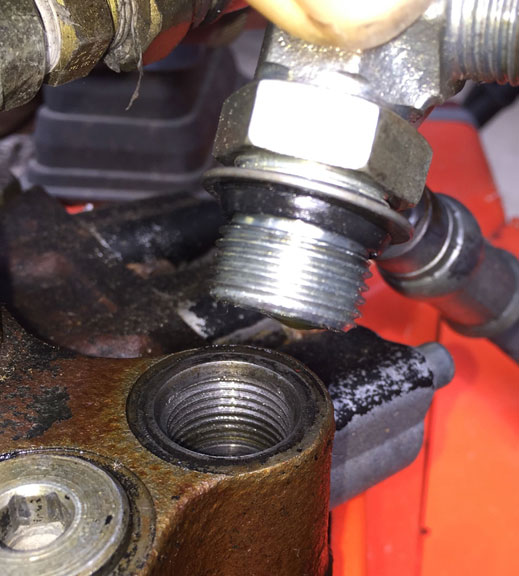

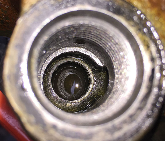

OK I'm back out in the mountains and here's whats inside the "OUT" port.
Down at the bottom of the hole there is a thread that's about 1/2" diameter, they are barely visible in the picture. (Not referring to the reflection image on the oil surface).
From this pic, can anybody tell me is this port likely configured for a PB adapter? If you think so I will start chasing Dinoil for one.

The good news - I can see no other reason for internal threads lined up with the outer ones EXCEPT for a PB adapter - the (sorta) shiny circle just ABOVE the inner threads would be the sealing area for the inner O-ring. I'm about 97.5% sure you need to bug Dinoil now :D
But - "It makes sense that this seal arrangement (where there's an o-ring pressed down by a washer) is intended only for a low pressure "return to tank". -
NOT so - That's a standard SAE O-ring Boss fitting, got bigger ones just like that all over my Case, runs @ 2300 psi. One advantage of those is that, unlike TAPERED threads, you can aim the other end of the 90 ANY direction you want, then just tighten the locking nut/washer and make your seal.
Didja ever find a part # on your valve anywhere? If not, it's probably gonna be about as much fun as a poke in the eye with a semi-sharp stick :confused: Then again, you might get lucky and find the one person at Dinoil that WON'T ask you (in Italian) "Would you like fries with that??!?"
BTW, I'm guessing that the OTHER, blocked, port NEXT to the one in the pic DIRECTLY connects to that sideways hole I see ABOVE the inner threads - if so, that'd be your new "Tank" port once you find the adapter.

I'd concur with BukItCase ... given the number of holes for ports on that end, and the machining inside the one, it looks like the valve is power beyond capable with an adapter.
