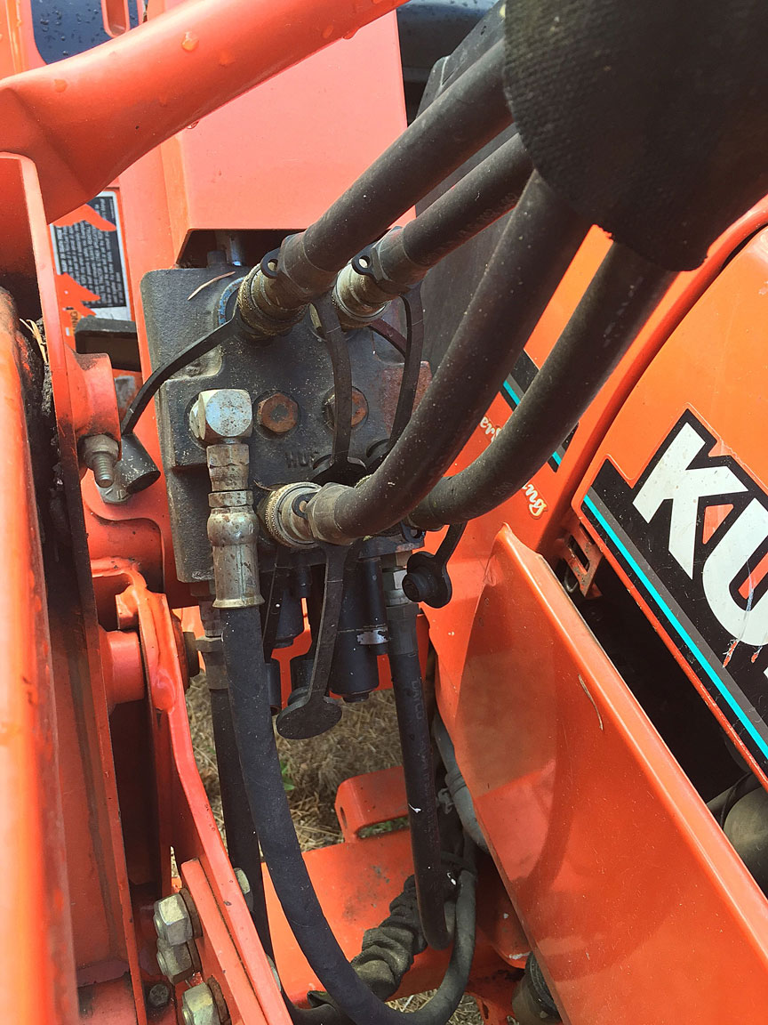

My hoses go forward to this little rectangular unit, which I did not investigate (yet).
The FEL hydraulic block (not the valve) is located at the top, towards the center in the picture you provided. Two hoses are shown connected to it.
It is possible that your B7800 lacks the holes/machining to actually have a rear hydraulic block installed ... the B7800's may not have come with them (the holes) ... on that count, I dunno ...
If that is the case, then one would use the FEL hydraulic block as the source for any (external) hydraulics ... so the use of that FEL hydraulic block isn't, in and of itself, necessarily an incorrect way to do it.

BTW ... the hose you have labeled in the picture as "rtn" (return) likely isn't a "return" ...
Based on where it's heading, it is likely supplying the FEL valve ...
If that's indeed the case, then the line is functioning in a practical sense as a power beyond connection (should be high flow/high pressure) ... possibly while hooked up to the return outlet (should be high flow/ low pressure) on your rear valve.
The actual return line (for the FEL valve) is the hose you didn't label ... which appears to be heading from the FEL valve to the general area on the tractor where the return port on the case is located - which is just above the leftmost arrow in the picture.
OK you're right, I called it a 'rtn' because it's the smaller line from the rear hydraulics. It goes to the "IN" port of the FEL valve block (lower right hose in this pic). The big one at upper left is the yellow-banded hose going to that "block". The lower left hose goes to the "tranny", I'm assuming to the 3-pt lift.
attachment.php
The yellow-banded hose from the FEL valve block.
425484d1432045477-help-ordering-hydraulic-fittings-rear-b2710_rear_hydraulics6-jpg
Do you understand my system & do you think it's configured "correct"?
If that is true (and I have my doubts), then it sure ain't a "return line" ...
Functionally, it would be acting as "power beyond" - by virtue of the fact that it's supplying the FEL valve. But I don't know that you are correct in your assessment or description of things.
What makes you think it's connected to the "IN" port on your loader valve ? Is there an "IN" imbedded in the valve's casting ?
FWIW, the hydraulic supply source for your FEL valve should be the hose with the yellow band around it, shown in the last picture. That's based on the fact that the right (forward) port on the mid hydraulic block is the output from the tractor's hydraulic pump - see the illustration from the LA 402 manual below:

Does your rear remote valve assembly have three hoses connected to it (supply/inlet, power beyond, and return), not counting whatever hoses there are, that are connected to your TnT cylinders ?
That hose - the one with the yellow band - should be the hose that is supplying the FEL valve.
And the hose you have labelled in the last photo as "supply" ... what exactly do you think it's supplying ?
Probably not - it is more likely the return line ... which dumps back to the tank/reservoir.
