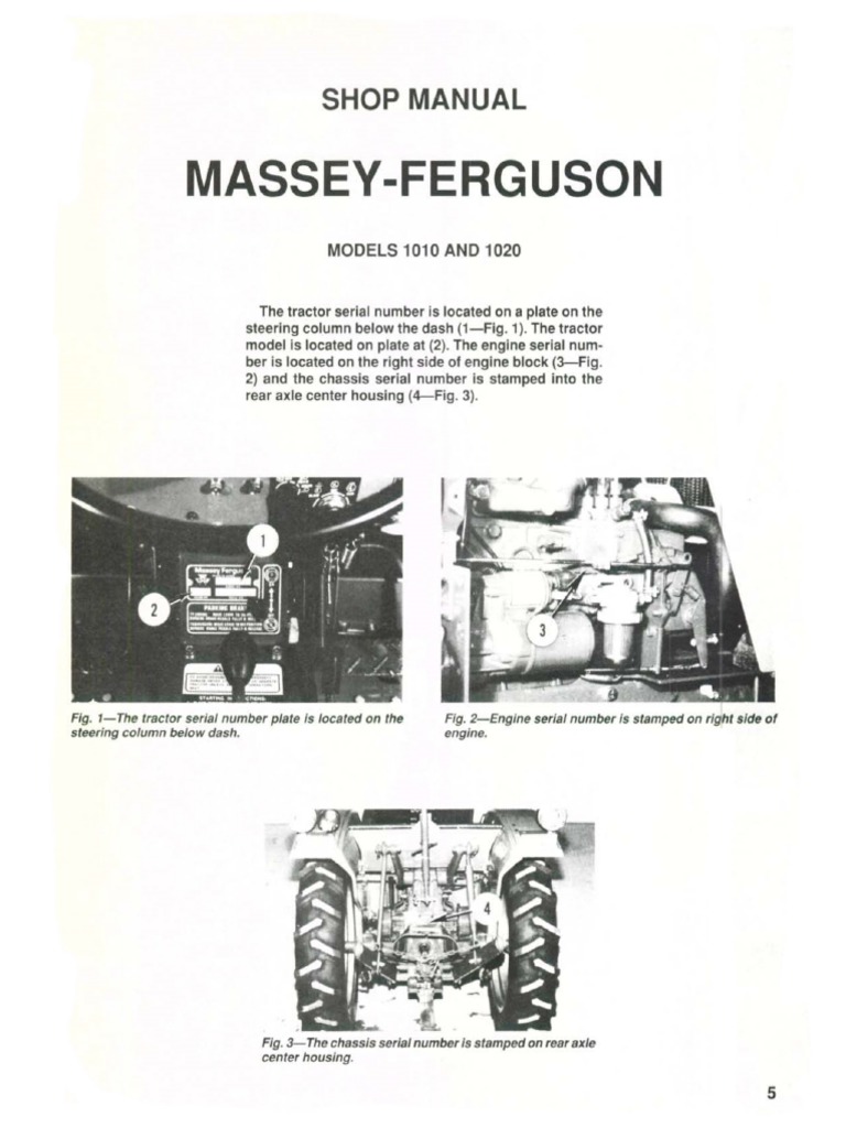

help needed with a 1020 head gasket
/ help needed with a 1020 head gasket #1
trustytractor
Apr 9, 2016
1
portugal
david brown 950
Hi all , Can anyone help me, my neighbour has asked me to fix the head gasket on his massey 1020.This in itself is no problem but I need to find out the torque settings for the head and cam and the valve clearances. If anyone can help this would be most appreciated.thanks
/ help needed with a 1020 head gasket #2
Hi all , Can anyone help me, my neighbour has asked me to fix the head gasket on his massey 1020.This in itself is no problem but I need to find out the torque settings for the head and cam and the valve clearances. If anyone can help this would be most appreciated.thanks
  • Screenshot_20260326_215358_Chrome.jpg
    639.2 KB · Views: 16
/ help needed with a 1020 head gasket #4
This post is 10 years old. Hope he isn't still waiting for a reply lol
/ help needed with a 1020 head gasket #5
I didn't even read the date lol but maybe for the next person who stumbles on this thread it'll help
KOMATSU WA-250 GP Bucket (A68134)
KOMATSU WA-250 GP...
2018 GMC Terrain AWD SUV (A66738)
2018 GMC Terrain...
1999 INTERNATIONAL 2674 T/A DUMP TRUCK (A67714)
1999 INTERNATIONAL...
PALLET OF DISCHARGE HOSES MISC SIZES (A67714)
PALLET OF...
2008 Allmand Max-Lite ML20 20KW Towable Light Tower (A68183)
2008 Allmand...
Bainbridge,Georgia (A65640)
Bainbridge,Georgia...
